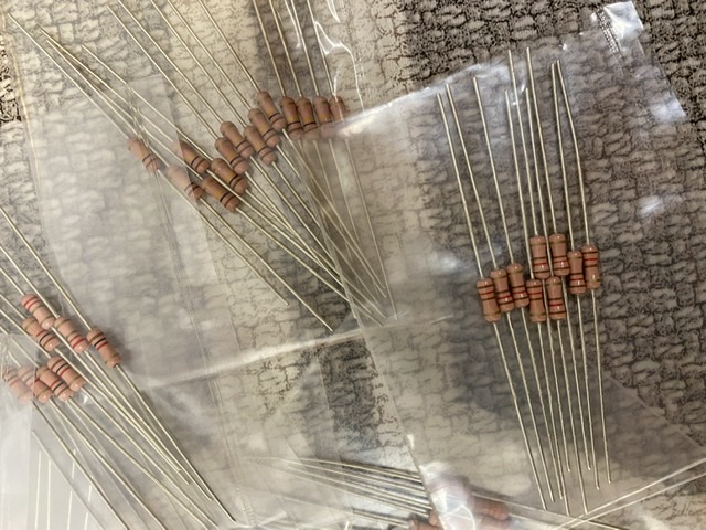

Just read that the original resistors in the kit are carbon as well (not metal film). Can anyone confirm that?
Hi Soi, I took a photo of the original resistor.
Reattached the photo. Sorry I’m learning here.
Thanks. My kit came with two sets of resistors (stock and Takman). Victor said the stock resistors are carbon as well, but 5%.

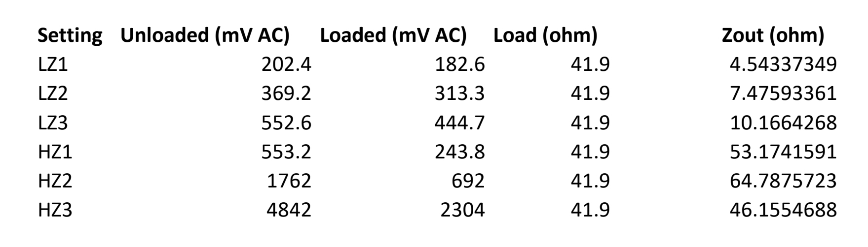

What I am asking for is measurements like the the measurements below that someone else did for the 8800 amp, and honestly should be something that should be shared by the manufacturer.
If you do not know, then hopefully someone can or has measured it. As you can see with the chart below (8800 amp by an individual user), the outputs ohms is not linearly increasing by setting. In the HZ 1 through 3 option, its actually jumping around between the 3 settings. The output also varies between 4-64 ohms between all the 6 settings.

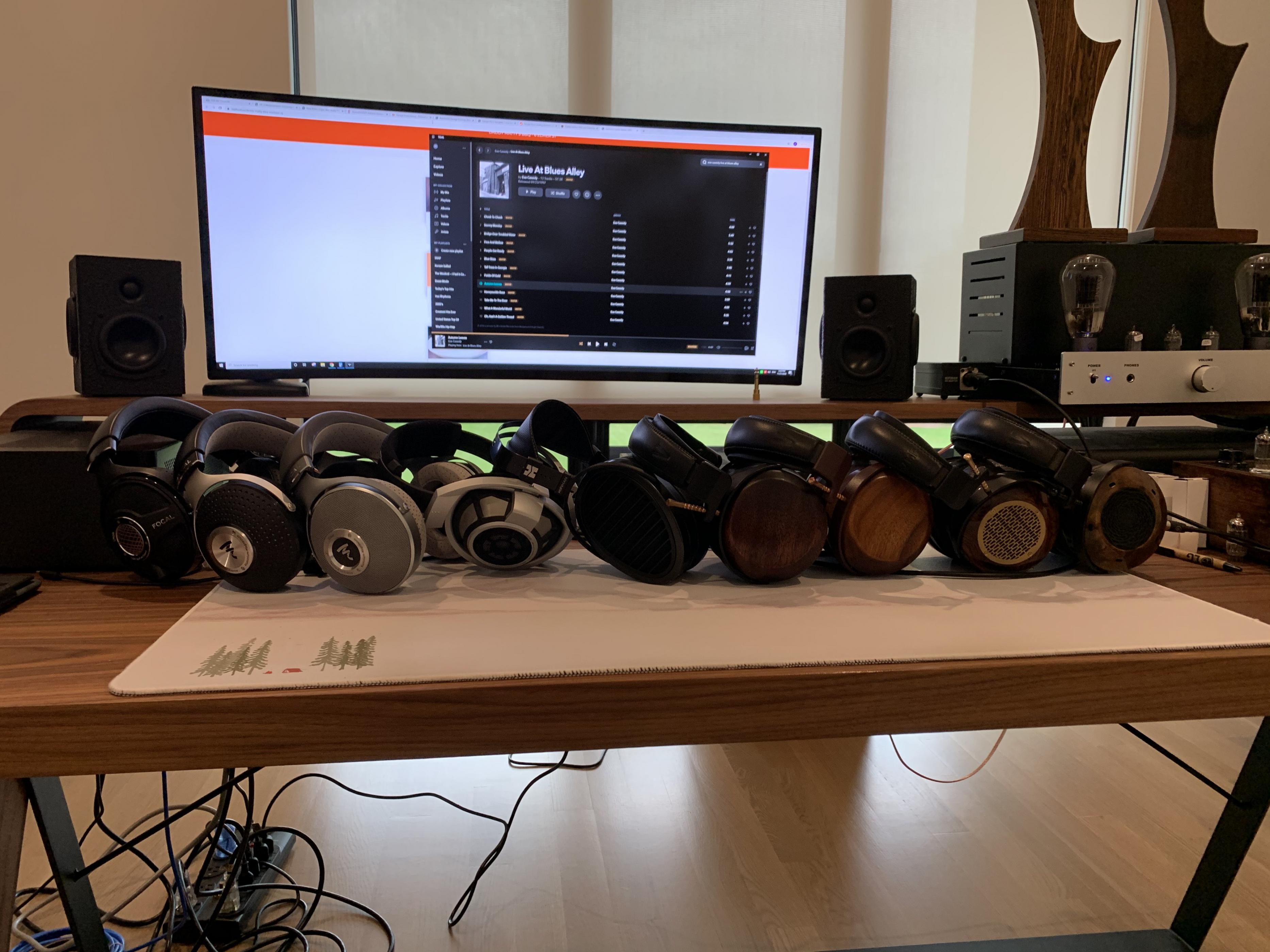

I have also attached a picture of the situation that is occurring. 9 different headphones that were brought over to my home for auditioning and 4 different amps. on the 8600, we have no idea how to decide which setting to decide, so we have to turn the amp on and off 4 times for each headphone which is 36 on and off cycles in a short period. Aside from it being annoying and frustrating, it probably isnt good for the tubes or the amp.
