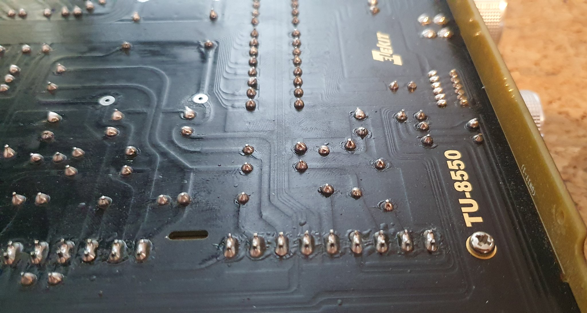

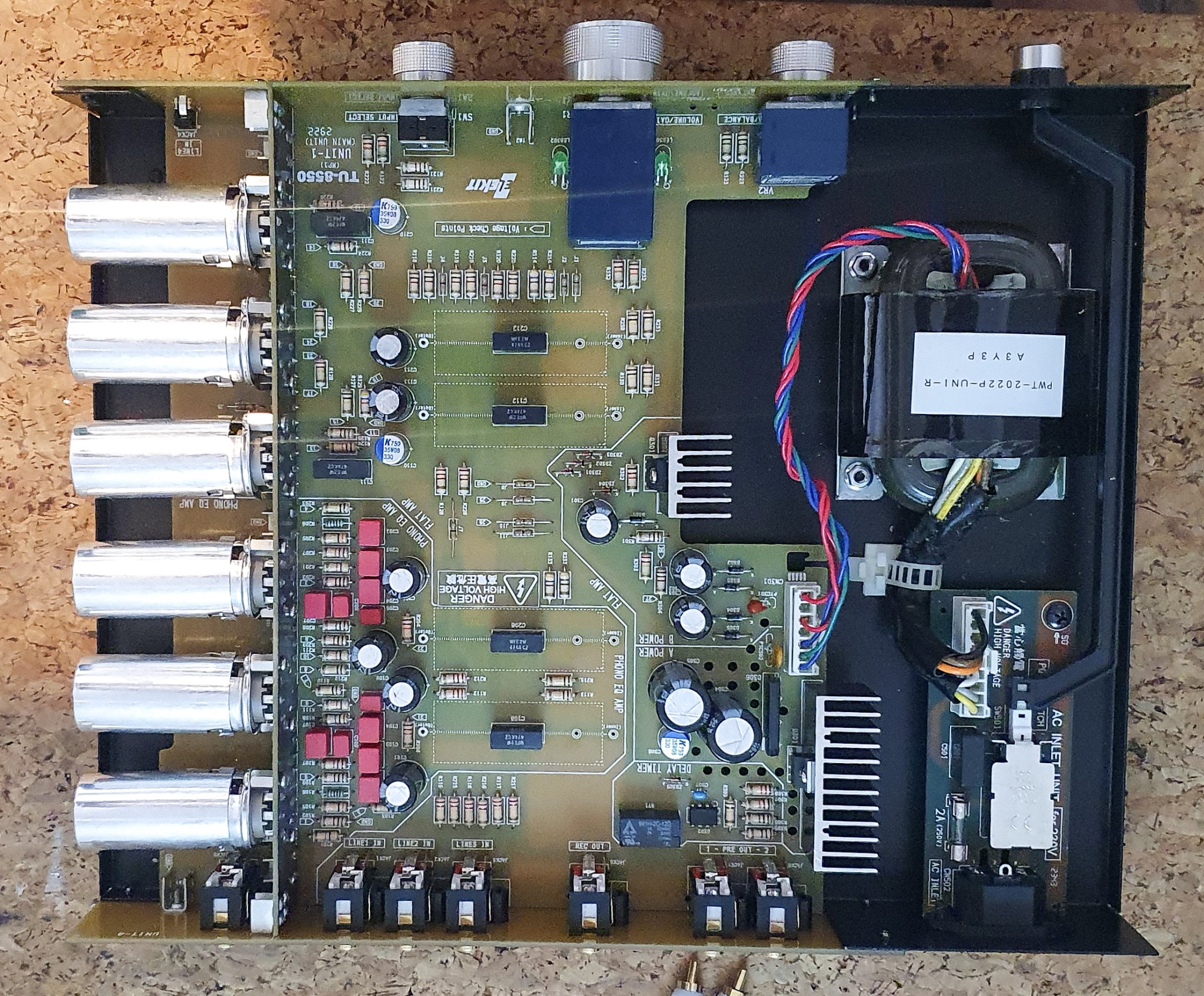

The hum still remains. I'm hoping someone may have some idea's as to what could be the solution. Here's the path I've taken so far, and the set-up of my unit.
TU-8550 pre-amp
Denon AVR 790 power amp
B&W 685S bookshelf speakers
No hum when music is played from the line 4 (iphone connected to the front input jack).
When the selector is switched to the phono setting, the hum occurs. The hum is unchanged regardless of the turntable being connected to the pre-amp or not. To me, this rules out the turntable as contributing to the cause.
What I've done to try and resolve the issue.
1. Resoldered all the connections.
2. Switched the tubes from the preamp side of the baord to the amp side. If it were a faulty tube, I was expecting the auio from line 4 input to show symptoms in this changed state.
3. I've lined the chassis with copper tape. (sounds strange, but it has worked for others).

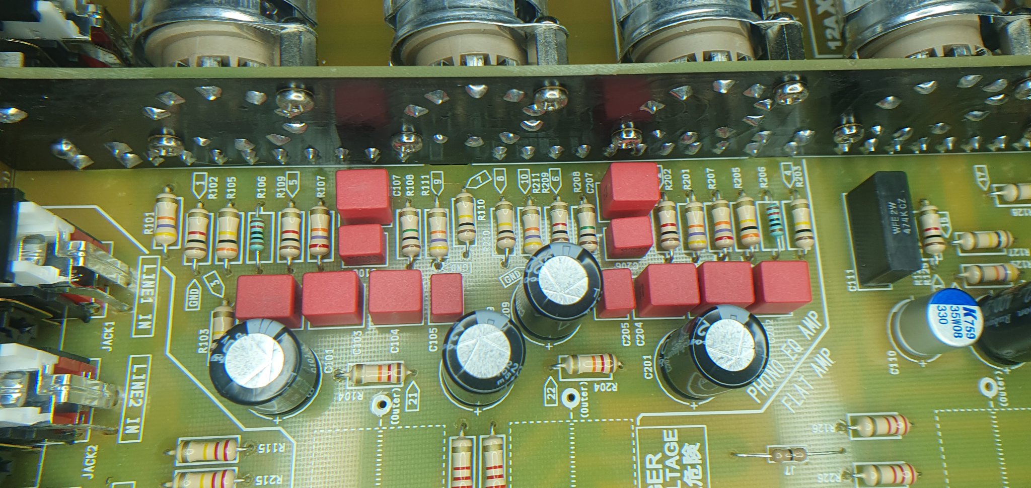

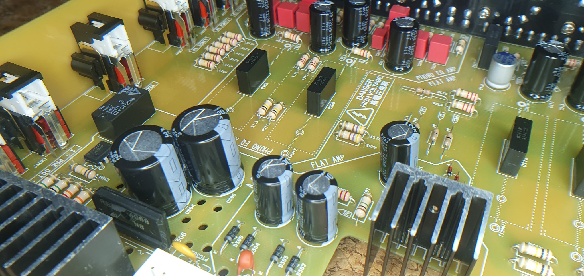

The hum is nominally 120Hz (I used an audio tone generator to check). This would suggest a ground loop issue on the phone preamp board. Does that sound fair?

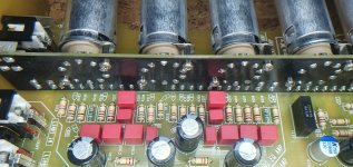

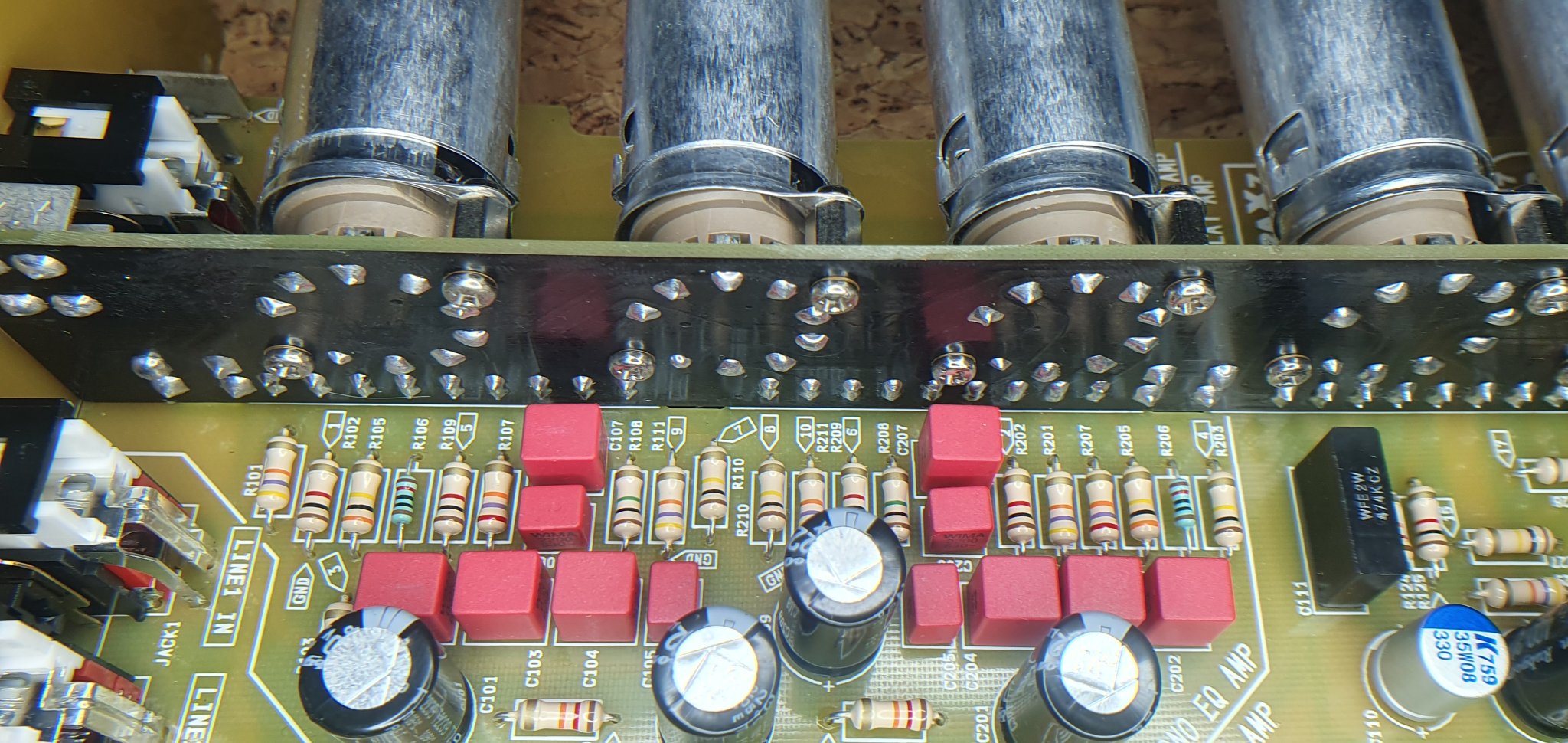

When the unit is operational and the chassis opened, the area region behind the tubes is extremely sensitive to movement. I was investigating if the caps could be the problem, and when moving a timber probing stick behind the tubes (near R108 & R111) the hum was enhanced.
Could it be the tube sockets?
Or one of the installed components?
All the test voltages are within spec.
I'd be interested on to hear some other possible solutions.

An update on my build and the small issue I had with humming.
I removed the mosfet and tested it to discover that it was not operating correctly. A replacement was provided, installed and the hum is no longer.
