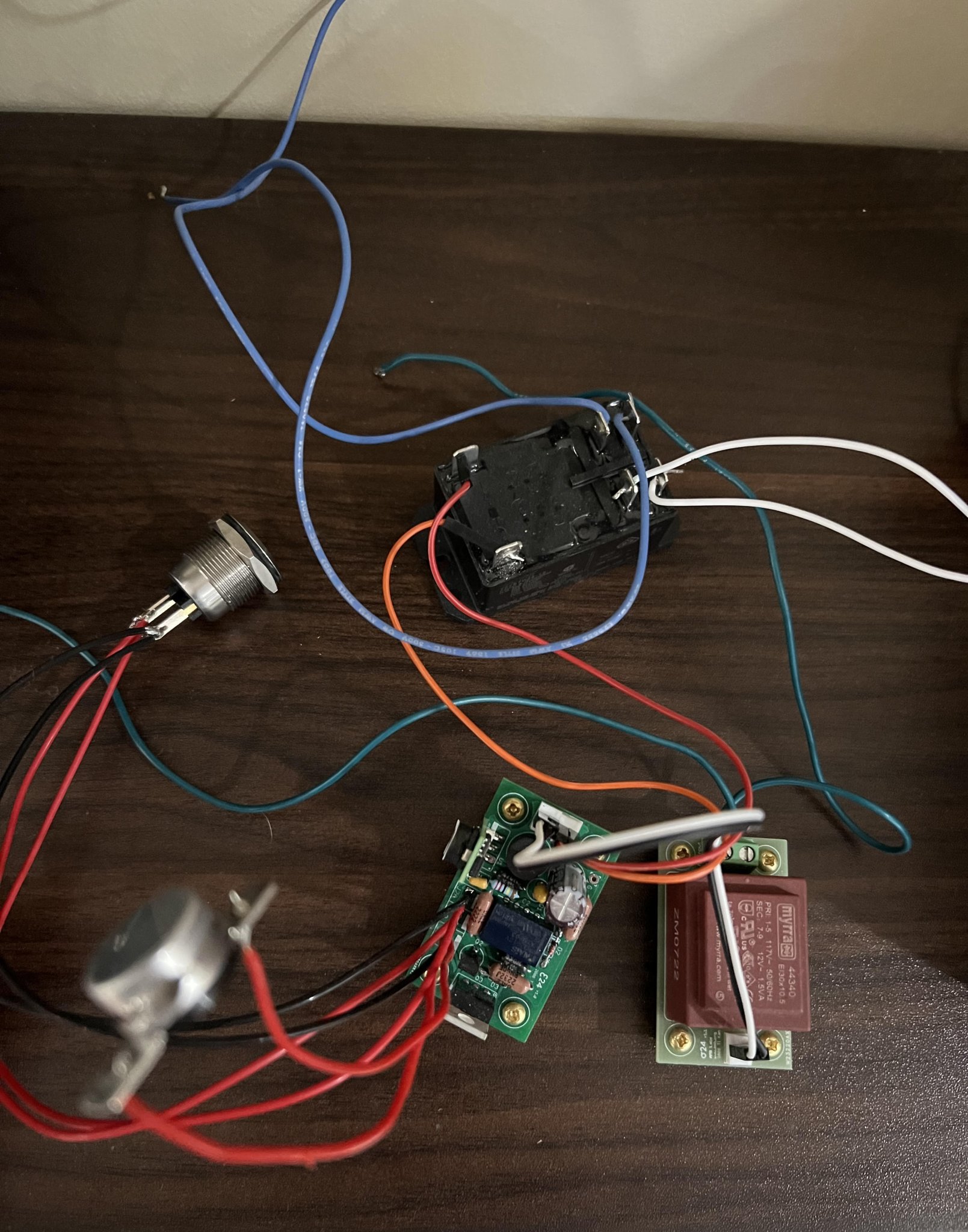

Here is the rig I ended up building to replace the janky power switch mechanism on my TU-8900 and TU-8550 (sorry I don't have pics with it installed yet):
I used:
1 x AMB Tranformer board (https://www.amb.org/audio/sigma24/)
1 x AMB Power button control board with thermal shutdown (https://www.amb.org/audio/epsilon24/)
1 x Small stepdown transformed (powers the control board and LED, always on)
1 x Bulgin red/green power button (Green is on, red only shows on thermal overheat/shutdown)
1 x Single pole mechanical 12VDC relay (It clicks when turned on/off, which I like)
1 x Stancor STO-170 Termal sensor
I had to widen the faceplate hole for the power button by about 1.5mm for the Bulgin to fit through, which was easy with a Dremel, and the switch has a ring that hides the cutout anyway. Overall it works very well for me, no issues at all. The only caveat being the 12VDC transformer is always on in order to power the LED and relay. Everything fits nicely inside the case, and I just drilled holes in the bottom to bolt down the transformer, control board, and relay.
