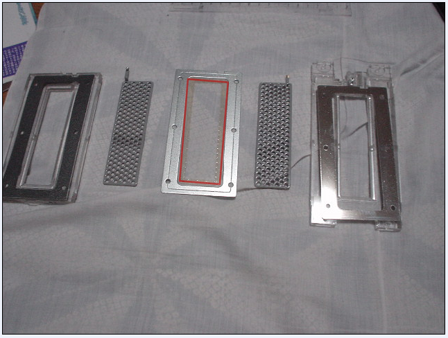

The stators on both sides seem to be REALLY REALLY stuck to the diaphragm and I doubt I'll be able to get them apart without breaking the diaphragm. I don't think I'm going to try.

I did get the stators off, I did it very carefully with a very small sharp knife. The diaphragm is a lot stronger than I thought it would be.
I don't have graphite paint but what about dishsoap? What resistance readings should I be getting with leads about 1 cm apart?
I'm getting open circuit (infinite resistance) at all points on the diaphragm regardless of meter lead spacing.
Diaphragm will likely only be conductive on the side facing up in the attached pic.
Rather than using probes directly, results are usually better if you place two coins on the diaphragm close to each other to improved contact with the high resistance coating. Then put DMM probes on the coins. With this method, coatings usually measure in the 1M to 10M range, so make sure to use your highest resistance range on your DMM.

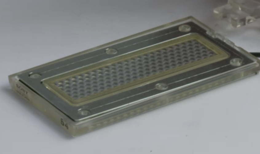

I got it cleaned up and back together and it seems to be exactly the same - working but incredibly quiet.
Still, connecting and disconnecting the white wire has no effect at all, and I don't see any spark at all when connecting and disconnecting the white wire. (The only time I saw it was when measuring stuff with the meter, I don't think I ever saw it when connecting or disconnecting the white wire.)
Maybe I'll take it apart again and coat both sides of the middle of the diaphragm with dishsoap - even with coins I still get infinite resistance at all points on the diaphragm.
What are you thinking at this point? I still don't think the bias voltage is working, do you still think it's a problem with the esl itself?
Yeah, I still think that it is likely either the diaphragm coating has completely lost conductivity or contact with the metal plate....I still don't think the bias voltage is working, do you still think it's a problem with the esl itself?

I was thinking about the dishsoap - I don't think it's going to do anything. The diaphragm has stickers on both sides to keep the stators from touching the diaphragm. If the diaphragm has completely lost it's coating and I can't coat over top of the stickers then the middle part will never be in electrical contact with the outside edges so it won't get the bias charge.
Anyway, if the inputs at the bias block drop the spl by more than a couple db the piezo will be too quiet and none of my regular tweeters will be anywhere near loud enough so I might have to shunt the red and white wire and use that. I'll try it all out asap.
Your thinking is correct. Try the dish soap around the outer edge of the diaphragm, but inside the O-ring(stickers) that the stator sit on to see if that restores contact with the diaphragm coating. Only put the soap on the side I showed in post #45....I was thinking about the dishsoap - I don't think it's going to do anything. The diaphragm has stickers on both sides to keep the stators from touching the diaphragm. If the diaphragm has completely lost it's coating and I can't coat over top of the stickers then the middle part will never be in electrical contact with the outside edges so it won't get the bias charge.
If that doesn't work, you can try coating over the O-ring(sticker) and the center part of the diaphragm. Again, just on the one side. You should get sound out of the ESL even without that second stator in place. This would confirm that the issue is the coating.

I coated the entire diaphragm except the O ring - the entire surface inside the O ring and everything on the outside of the O ring as well, all the way to the edges, as it appears the diaphragm material extends all the way across the entire metal frame. On the other side of the diaphragm I also coated everything inside the O ring, the entire radiating surface.
I put about one drop on each side on the radiating surface and spread it around until I read less than 1 million ohms with two coins.
It is now exactly the same - working but only loud enough to hear when the ear is within a couple of cm.

Remember, only coat over the O-ring on one side of the diaphragm, so you can leave the opposite side stator in place. You can test with just one stator in place, although it won't be as much output as with both in place....I'll take it apart one more time and coat right over the O ring just for fun, but won't that cause a voltage leakage? Maybe not enough to arc but more than ideal.
Mylar packing taping is great insulation, as is 3M foam tape. If you want to put the stator in place on top of the O-ring you coated over, you can use either as an insulator round the stator perimeter where it will contact the O-ring, before placing it down.
Well, I had it done before I saw this post. I'm getting good at this, 5 minutes to take apart, coat with dishsoap and reassemble. I did break a wire off last time, had to pause to solder that back on but it's a pretty quick process now.
3 drops of dishsoap this time, all on the side that the diaphragm contacts the metal frame that supplies the bias voltage from the white wire. I coated the whole side, inside the O ring, outside the O ring, and all over the O ring until I was reading less than 2 million ohms from the outside edge (outside the O ring) to the center radiating part.
Then I put it all back together and tested it. I didn't put any new gasket in between the voltage bias frame and the diaphragm.
The good news is that it works now. It's hard to say if it's as loud as it's supposed to be but I can clearly hear it from a distance and it blends well with the woofer. It isn't very bright sounding, maybe it could use a db or 2 (or 3) more, but it's working.

Yaye for sound! But, if you got sound as soon as connecting red and black wires, you have a short between stator and diaphragm coating. A short in ESL world would be anything < 10Mohm resistance. The ESL would be operating in single-ended unbiased mode which will be 6dB to 12dB quieter than the intended push-pull biased mode. White wire will make no difference because the HV will just be getting shorted to the stator.…The good news is that it works now. It's hard to say if it's as loud as it's supposed to be but I can clearly hear it from a distance and it blends well with the woofer. It isn't very bright sounding, maybe it could use a db or 2 (or 3) more, but it's working…I got sound as soon as I connected red and black. Then I connected white and I was expecting it to get louder but it didn't it stayed exactly the same
Yes, if you want to use the ESL with soap coating over the O-ring you will need to get an insulating gasket between the soap covered O-ring and the stators. Paper is gonna be too conductive for long term solution. Even PVC electrical tape is on the conductive end of insulators as far as ESL construction is concerned. But, I think it should work ok in this situation since the voltages involved are not particularly high. Alternatively, you could cut a spacer from the thin clear polycarbonate commonly used for blister packaging small items for sale.Should I take it apart again and put a gasket between the voltage bias frame and the diaphragm so the stator is not in direct contact with the dishsoap soaked O ring? Anything would work, I could even cut paper the shape of the O ring, the diaphrgm is sticky with soap now so it would stick. I'm not sure if I have mylar packing tape, I do have electrical tape and tuck tape and painter's tape.
If dish soap is dried thoroughly with a hairdryer, it will last a long time. I have some ESLs using diluted(2-to-1) Ivory dish soap that are coming up on 16yrs and still going strong. The main drawback of soap is the added mass rolling off the top end. Soap is pretty heavy as far as coatings go, and the slight tackiness attracts dust over time. So you want to try and keep the coating as light as possible. Anything with < 100Mohm coating resistance and there is no benefit as far as increased SPL. Also, be aware that it can corrode metal it is in contact and eventually lose conduction. I got around this by using a DAG graphite bridge between the soap coating and metal HV contact.Also, how long will the dishsoap last? Should I redo this with graphite powder for a longer lasting effect?...if I use more dishsoap will it make the esl tweeter louder? If a little is good a lot should be great, no?
Graphite powder tends to be a bit messy, and difficult to ensure no unwanted leakage paths. Also, not sure how to get conductivity over/under the O-ring. I guess Ideally you would replace entire diaphragm and coat properly. Could then use thin VHB foam tape for the O-ring spacers between diaphragm and stators.
