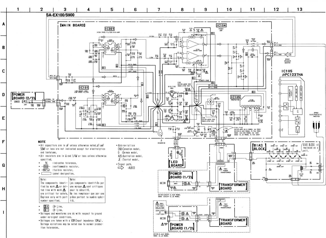

My internet was down all day or I would have been here a lot sooner.
I tried the electrical tape gasket, it made no difference at all.
Then just for fun I tried something new. I put the tweeter together WITHOUT the metal frame that connects to the white wire. It made no difference at all.
I'm getting little shocks pretty regularly now from the black and red wire, but handling the white wire and the frame it connects to does nothing at all.
Admittedly, I don't really know what I'm doing here but it doesn't seem like the white wire or the metal frame it connects to has any voltage on it at all. Completely removing the frame removes any possibility of stray paths or voltage leakage, and the tweeter works without the white wire voltage at all, but seems a bit too quiet.
Again, I'm at a loss here.
Hate it when that happens. 🙁
Completely removing the frame does not remove the leakage path from the diaphragm coating to the stator sitting on the coated O-ring. That is this leakage path that is allowing the tweeter to operate with just the red and black wires. You will know the leakage path has been successfully blocked when the ESL makes little to no sound with just the red and black wires. Then, if coating is still good from contact to diaphragm, hooking up the white wire will charge up the diaphragm for proper operation and you will hear much louder sound.
Before proceeding, lets take a step back and re-confirm that the HV power supply is still working.
It is possible that the internal 100M resistor has been damaged from all this testing and playing around.
1) With no music playing, connect DMM(1Mohm input impedance) between white wire and red wire.
2) Plug power cable in. If working, DMM should read 10 - 12 Vdc.
3) Unplug power cable; reading should quickly decay to 0Vdc.
I've got 10.8 VDC between white and red with no music playing, it drops to 0 when unplugged.
I guess I'll try cleaning the new electrical tape gasket with rubbing alcohol but I was pretty careful when putting it on, and I put it on the stators, not on the O ring so I'm not sure how there could still be a leakage path.
I'll let you know what happens after cleaning.
I ended up taking out the electrical tape gaskets as they weren't doing anything.
Near the end of testing I finally did notice a small change when connecting the white wire but disconnecting it didn't do anything until I guess I discharged something by touching the red terminal, then the sound decreased a bit and increased again when the white wire was connected.
At that point I put it all back together again. The tweeter is definitely working but it's not working hard. Boosting 4 khz to 20 khz by about 6 - 10 db sounds a lot more natural to me but I can't measure as I don't have a mic at this time.
Maybe this is just supposed to be a very "warm" sounding speaker, I don't know. But I can't spend too much more time on it. I might repeat the procedure on the other one, not sure yet, as the experience has been a bit underwhelming.
Thanks for the help though.

...The tweeter is definitely working but it's not working hard. Boosting 4 khz to 20 khz by about 6 - 10 db sounds a lot more natural to me but I can't measure as I don't have a mic at this time.
Re-reading all your test descriptions it still sounds like there is a leakage path somewhere pulling down the HV level...I just can't seem to identify it without having hands/eyes on, since I don't have first hand experience with it. I have read reviews of the speakers and the top end was never described as mellow or rolled off, so I don't think what you are experiencing is as it should be .
Understand. Certainly not the best introduction to ESLs, trying to work on such an oddball tweeter design with no access to the important HV and step-up electronics or useful high-impedance instruments. We got close...just not quite there. Someday I hope to snag a pair of these to determine what was going on, and how best to repair them.
>>> Forgot to ask, did you ever try driving a piezo or dome tweeter from the tweeter amplifier upstream of the step-up transformer?
The thing that confuses me is that I thought the white wire and the metal frame it attaches to should have a LOT more voltage than anything else. The relatively low voltage black and white wires shock me but the white wire doesn't - not at all, not even a little bit. And I'm not sure how to interpret the meter reading but there's only low mV between the white wire and ground. Sorry if I sound like a broken record, I just don't get it.
I didn't try any tweeters at the bias block inputs yet. I will try that tomorrow. I really wanted to get this original tweeter working, and it really does sound nice with about 8 db boost.
I'm a bit worried that a normal tweeter cut in to the bias block inputs will be WAY too quiet. As it is, on the high voltage lines regular tweeters are already way too quiet. They piezo is the only one that gets anywhere near loud enough, and the piezo is actually a bit hot.
I'll let you know tomorrow when I try the low level inputs and some regular tweeters.
It all comes down to the high impedance nature of ESLs and their driving electronics.
Sony included a 100Meg resistor in series with the white wire and 30K in series with the red and black wires…all inside that impregnable bias block. Looking at your experience of tinkering, perhaps it was a smart move. If you had poked around touching wires going to the stators in a Quad, Acoustat, or Sound Lab ESL while playing music you would have been quickly jolted into cautiousness. So, just be careful with other ESLs when/if you work on them. They will fry meters, and burn holes in your finger tips like a taser.
The white wire does have >2kV on it, but with the 100Meg in series, as soon as you touch it you form a voltage divider and the majority of the voltage is dropped across the internal 100Meg resistor. If you could get in the bias block and touch the HV output upstream of the 100Meg resistor, it would give you a really healthy buzz.

BTW, if I read the schematic correctly, the active HP filter is 3rd order @ 3kHz, so the exact front-to-back placement of the tweeter relative to the woofer may be important for avoiding a dip/peak at crossover.
