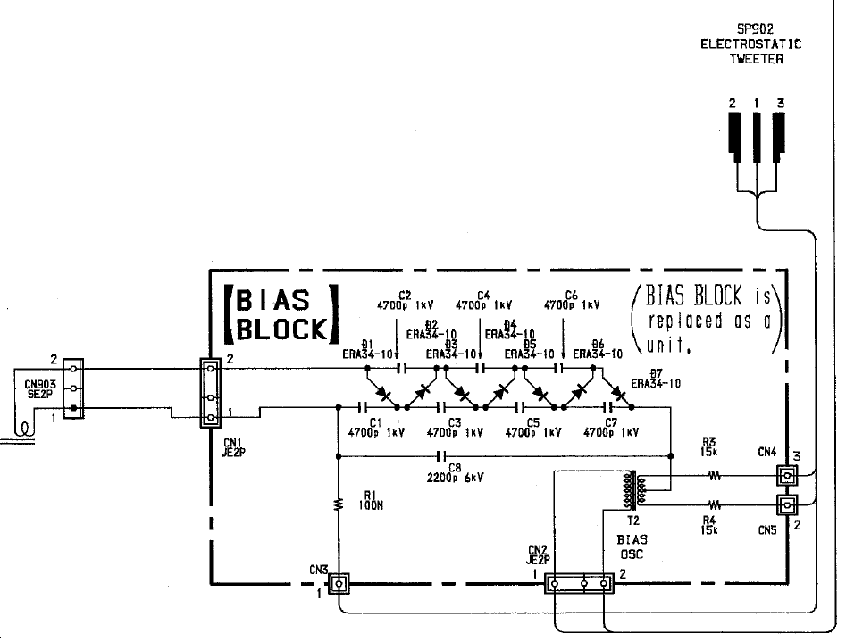

Looking at the schematic, the bias voltage is likely in the 2kV to 3kV range. If you measure the AC input voltage between the pins of CN1 we can calculate exactly what the HV output should be.Schematic (from post 2, same as in the service manual) shows voltages of 1kv and 6kv in the bias block connected through transformer to the tweeter but I don't know what voltages I am supposed to read on the wires themselves…I read about 15 mV on the white wire, from my limited esl knowledge I thought it should be hundreds if not a thousand or so volts on the diaphragm…. give me some ballpark idea of what dc voltage should be on the white wire supplying the diaphragm bias, as I suspect that is the problem at this point.
HVdc = 7 x sqrt(2) x Vrms(CN1)

The proper way to measure the HV would be between the white wire(terminal CN3) and either the black or red wires(CN4 or CN5). Notice that there is a 100Mohm resistor in series between the HV multiplier and the HV terminal CN3. So, if you use a DVM with input impedance of 10Mohm, you are forming a 10:1 voltage divider, so 3kVdc would show up as 300Vdc. In actuality, it will likely be much less because the HV multiplier is not made to handle the current draw from a 110Mohm load. But, you should certainly be able to get > 100Vdc and similar magnitude AC ripple. I’m fairly confident you will find the supply is working fine, and the problem is in the diaphragm coating or contact, as mentioned at the beginning of this post.

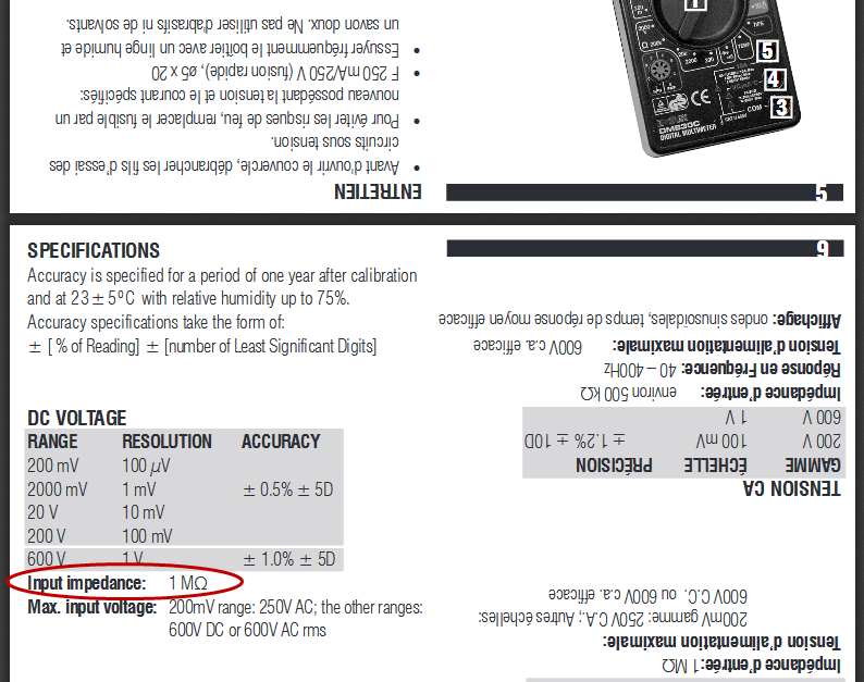

Yeah, doesn't look like there is any connection between the electronics housing(gnd) and the HV module....One terminal on the white wire, the other on metal electronics housing, which I assume is ground (it didn't kill me when I touched it so it should be ground).
Hmmmm...do you know what the input impedance is?I do not have a HV probe, I just have a crappy $5 DMM with a 200 and 750 VAC setting. The highest dc range is 1000 VDC.
If not the usual 10Meg, it could be messing with your readings from loading down the high impedance ESL circuit.

If you can tell me your DMM input impedance I can stick it in an LTspice SIM I have to see if readings seem reasonable or not.

This appears to be my DMM, same part number and it looks the same. I don't know anything about it other than it's cheap crap that usually does what I need (usually 12 VDC measurements).

Yes, The HV power supply is the diode/capacitor ladder shown in the "bias block" portion of the schematic.The HV power supply is the bias board, correct?
With no music playing I get 11.3 VAC and 11.3 VDC with the leads on the white and red wires. Pretty close to the same thing I got with music playing, about 0.2 V less when I stop the music playback or disconnect the rca input.
Your readings seem reasonable if the input impedance of your DMM was 1Meg.With no music playing I get 11.3 VAC and 11.3 VDC with the leads on the white and red wires. Pretty close to the same thing I got with music playing, about 0.2 V less when I stop the music playback or disconnect the rca input.

So your 11.3 Vdc reading means the HV supply was putting out an average 1.1kVdc while driving the 101Mohm load.
With only the ESL hooked up, it would bias the diaphragm to about 2.5kVdc.
