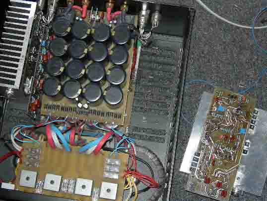

will do homemodder. Perhaps you could kindly post a picture of the internals of the aw250. Are the two channel pcbs mirror images of each other?

In fact, does anyone know whether in late stereo EC amps (the FFT variety) the L and R channel pcbs are mirror-images of each other?

I do not have means to take digital pics, last night i just took the lid off. This is a complicated amp and im not gonna fiddle anymore on it as its in perfect condition. Runs quite hot though but heard they operate this way. From what i can see yes the pcbs are mirror images, the parts are located in same position. That is to be expected as this is the way pcbs of amps should be.
Their is a site on the net showing a complete striped amp in for repairs, as soon as i find it again, ill let you know.

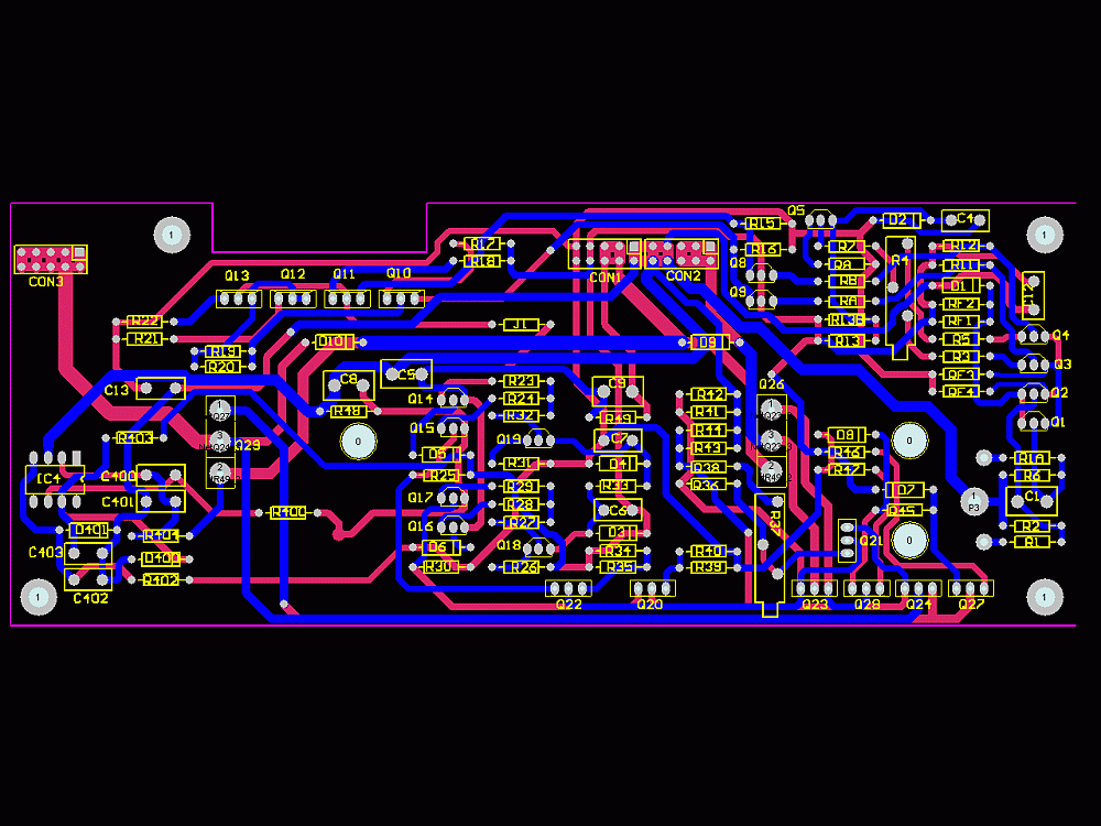

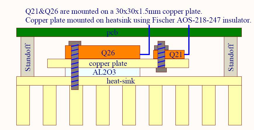

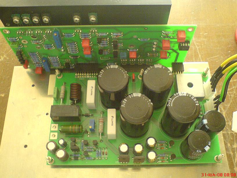

Well, here I am, clone now working happily for about a week now. I have had two major issues to deal with. First, fake c5200s and A1943s, which seem to be abound in electronics shops, and second, quiescent stability, which due to the lack of emitter resistors, really -moderators forgive- has been a ba**ard to attain.
I don't know how EC does it, but as per the attachment, and after suffering secondary breakdown about ten times, it is now very happy, even when it is pushed to the limit (thermally). All cloners out there - attention!
I'm very pleased with the final result though, sonics are much improved over my old current feedback elektor design. This soundstage, what can I say...wow! My proacs totally vanish!

Maybe you could put up your pcb gerbers here for other members to try it. Its a bit complicated but worth it. Personally Id use some low value emitter resistors around 0.1 ohm. Matching the output transistors so vigorously as do electrocompaniet can be a challenge in itself.
Now you can revel in some very fine sonics indeed 🙂 🙂 🙂.
Right said Homemodder, but I'm using only a single a pair of output devices, since the 70 or so watts are enough for me...
Anyone interested in the gerber files, please mail me.
Good job Olegtech! Are the pcbs your design? The amp board placement looks like the original EC board...

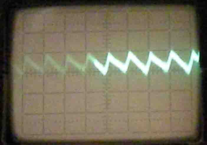

Are the problems of the right channel associated with thermal runaway? Bare in mind that this takes place extremely fast. Have you stressed thermally the good channel by driving a load at several watts power?
