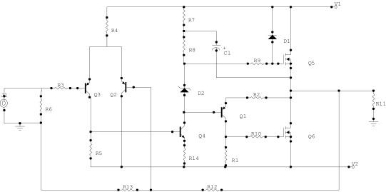

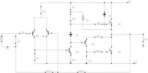

If the Nch amp is like this, I think it will be the same as ordinary amp. We can still consider the output as ordinary pushpull totem pole, with Q1 as the inverter for lower Nch, and bias is set by D2.
Thanks for the tip.

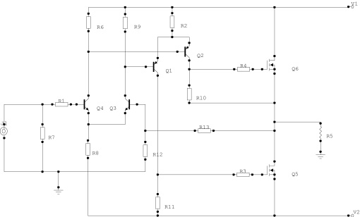

I see one of possible strength in Electrocompaniet is in the final stage. The driver is connected to CCS to opposite rail.No Electrocompaniet amp (that I have heard) can touch it...
But if the Nch is like this, I think it is differ than ordinary pushpull totem pole output stage.
The bias is set by R8, so there is no VBE multiplier connected between VAS.
This topology also has the same operating charactistic between Q5 and Q6 (operated in the same way).
Is this Nch topology better than ordianary pushpull totem pole output stage due to symmetrical operation of Q5 and Q6? What other excel does this topology has?
I also wonder, if this Nch topology has non-turnoff properties of the final stages? Due to not-using VBE multiplier for bias adjustment?
But I cannot think how to exclude the output stage from NFB loop if I use this topology. In ordinary amp, I can simply take the feedback point from VAS to exclude the output stage from NFB loop. How to do it in this topology?
