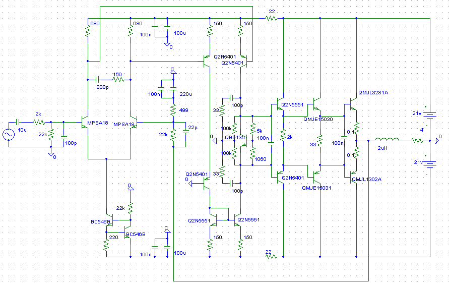

I've just built an amp quite similar, at least similar for the vas.
It uses normal ccs-fed singlediffamp, this kind of currentmirrored
vas and my standard tripledarlingtonout. I can post schematic later...
The results from this were surprising, the quality overwhelmed me,
it's definitely the best amp i've ever heard. It has some warm and
natural sound, but is extremely detailed with superb separation,
and a real asskicking bass !
Seems, that this kind of topology has very much potential !

They were known for using very low capacitance power supplies for the output size of the amp. Kind of minimalist in approach overall. They did sound good though when not over pushed.
"Snubbers", T:s and Z:s
I thought I'd just point out that the schematic shown is snubberized with 0.68µF in series with 1ohm, all in parallel with 0.1µF.
Also, it uses an inverting configuration with a T network feedback. and a classic Zobel on the output.
Interestingly, there's no Miller cap, all the compensation is emitter-emitter on the diff pairs, plus an input roll-off.
What do we make of al that?
Judging from the schematics, there might have been issues with idle current run-away when the bias trim pot gets old.

I also have made this kind of VAS (current mirrored downside), It has to use Miller cap (C dom). I wonder why this cct can use no-miller cap.Interestingly, there's no Miller cap, all the compensation is emitter-emitter on the diff pairs, plus an input roll-off.

Thx for sharing ! This is your latest cct, and looks like the best till now ?
I guess, you are on the right way, to have a very good quality amp ! 😉
Dont U like DC-servo instead a cap in the FB ? Maybe with an LF411 opamp... 😎
Hmm, i like it simple ! After having bypassed the electrolytic with
a 100nF filmcap the sound was ... perfect !
I think this is the one for me, still need to test with higher supply
of 36volts, but i have no suitable torid yet. Hopefully sound doesn't
get much changed with higher voltage.
DC is ~2mv, so i see no need for DC-servo.
Mike
A cap is also a solution, i know this, but maybe you should try a DC servo later with LF411.
(Just as a test, to give a chance for alternative solutions ! 😉)

And why do U used MPSA-s in the input instead of BCs ?

Have you ever looked into the specs of mspa18 ? Ouch !!!!!!
Measured hfe at vce=5v was ~980, it's very low noise, high speed,
and has much voltagegain. Just one hell of device !
Yes, just asking... 🙂
Emitter degeneration in the first stage, tried ?
Why do U need so much gain here, and
whats the gain of the 2nd stage ?
