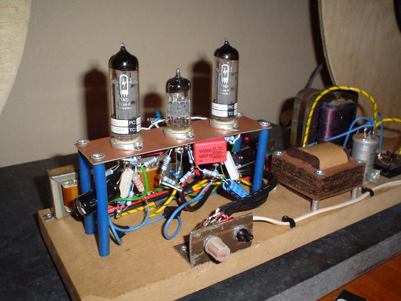

SUCCES !!! 🙂
Behold;
My very first "poweramp"
Thank you, Mr. Kitic, for the RH84SE design
and thank you all for the willingness to explain what and why.
Empee
hi there,
I guess you're not refering to my amp 'cause I usee a solid state rectifier bridge for this one.
With a transformer of sec. 250V with no centre tap this was the
easiest way to get to the 300V B+ asked for in the schematics.
I now get it to run at 297V
However,
I'm currently working on a new amp, my "model two",
which is going to have a double sec. tranny, both channels
each their own EZ81 rectifier and choke / cap.
How's that for channel seperation ?
Empee

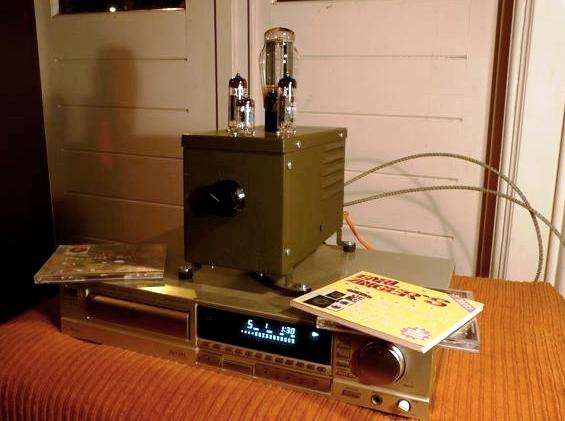

Here's my latest version of the RH84.
The case used is from an army surplus,
in it was a 24V relais (a BIG one)
sound is brilliant, but it's the last time I use such a small housing
(I was cursing all the way through assembly!)
