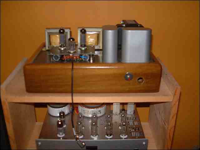

But, regarding Andrewbee's confidence, I have to commit an indiscretion -- I have received a few days ago an email from a person who has finally completed his RH807... and am hereby quoting him in part:
The amp looks nice, too... another reason why am I mentioning this is his suggestion for parts. What makes me a little sad is the fact that he did not state the RH807 outclassing the WAD300B PSE monoblocks... and I think that is due to a difference i power, mostly 😉
It does sound very good, very close to my World Audio Design 300B PSE monoblocks. It has been built using good quality components, Tantalum resistors for signal,PIO coupling caps, Black gates for cathode bypass, Sowter SA02 output transformers, NOS RCA 807's.
