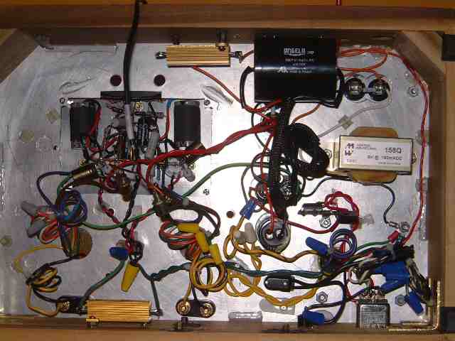

wire nuts
only an experienced and confident builder would trust his recycled treasure parts to wire nuts vs that pesky solder business
are those Jennifer Crock cryo-treated 6-9's silver connectors?
Seriously - I think we've all got a few projects under our belts that don't look this good under the skirt.
I like the hot glue gun work to hold down the wire. I'm always amazed at how nice some builders finish there gear.

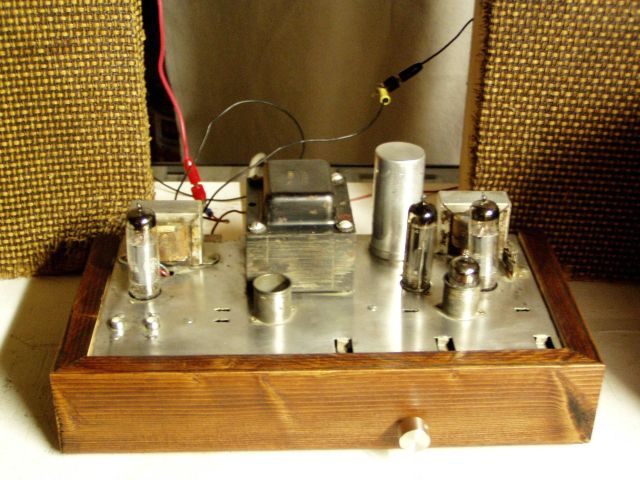

Mine Frugal-phile(tm) RH-84 is sitting sown in the car -- going to get it and hook it up to the tannoys (one with fresh tweeter also in the car)

It is all hooked up and playing in the main system now... when i get my USB DAC this upcoming week, i'm going to try it directly into the RH84. BB iMac->RH84 -> Tannoy D50s.
Despite being rated at 92 dB, my 1st impression is that the 90 dB Fostex horns were more efficient.
