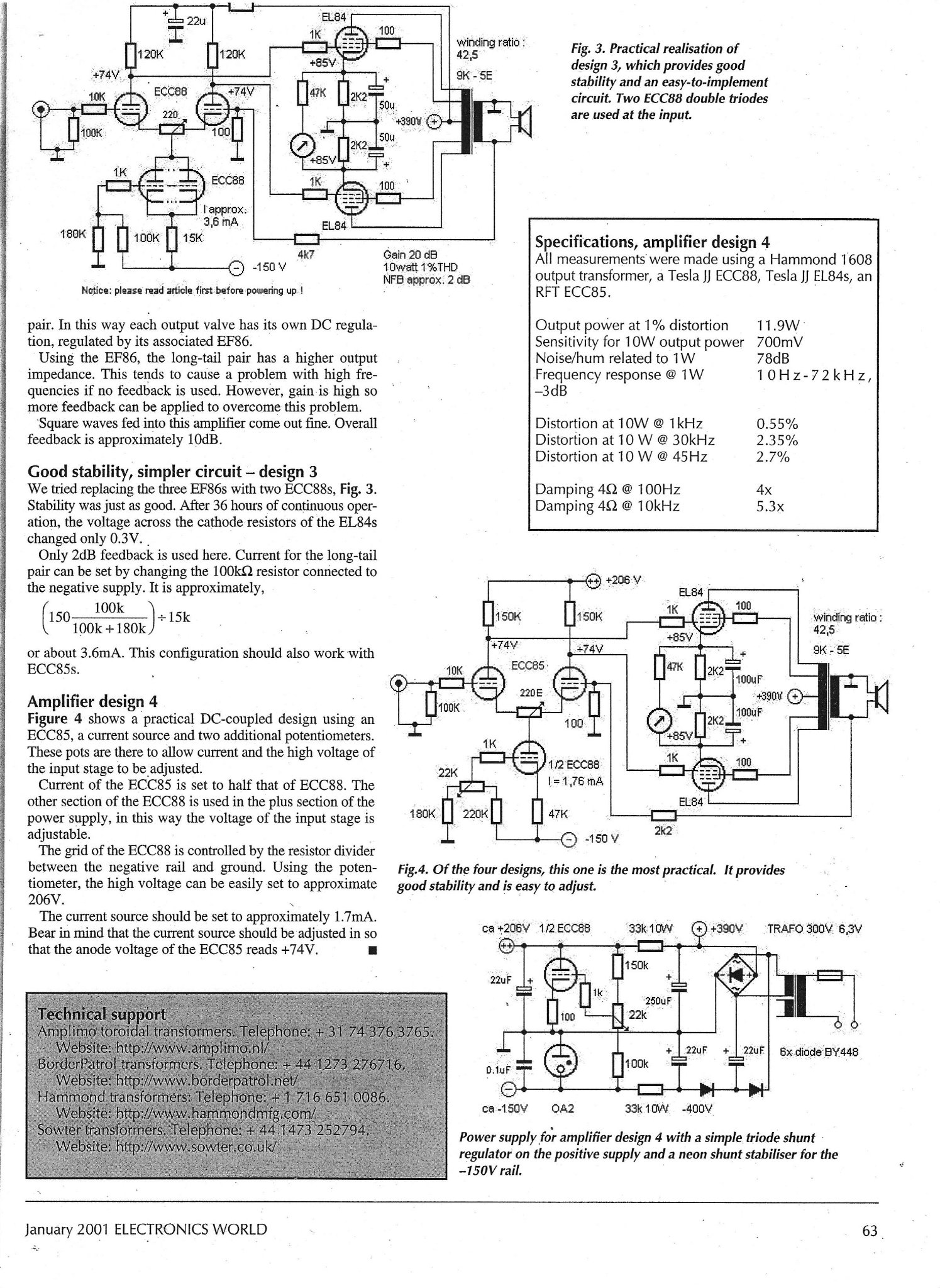

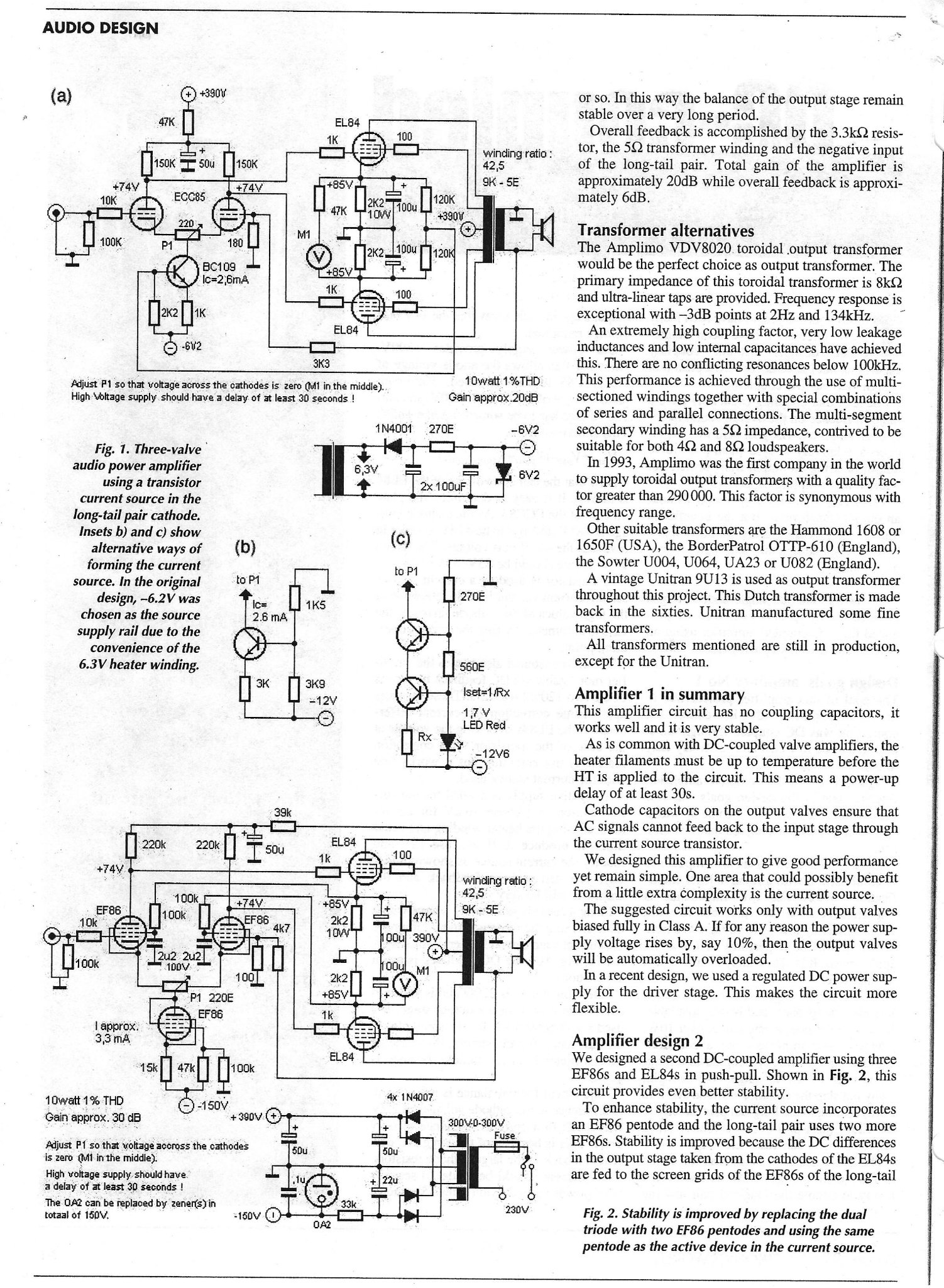

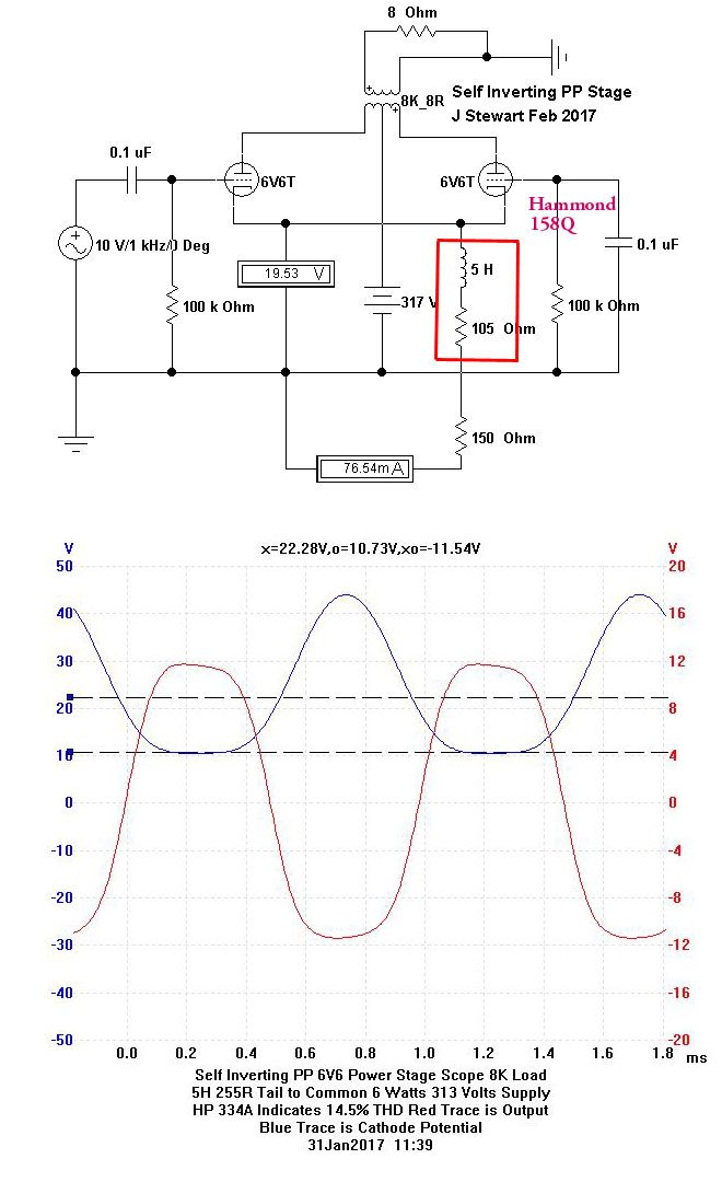

EL84 Push-Pull direct coupled by KeesB
Schematic & some test results of the Hammond Choke cathode coupled, self Inverting Amplifier.
More later as I pull this out of the archives. I'm surprised no one recalls all this, was here on DIY during
2017, 🙂 in detail.
The front end, not shown on the schematic is a triode connected 6AU6.
The reason why designers prefer direct coupling over capacitor coupling is to get rid of the masking effect of capacitors. Anyone who is familiar with both and using his ears can perceive this. Especially when using high quality dacs ( in the case of cd players) and high quality pick up cartridges this phenomenon becomes apparent: there is increased transparency with dc coupling.
You can find numerous examples of direct coupled single ended designs on internet but very few pushpull ones. That is the reason why I wanted this amp posted. Unfortunately all reactions so far focus on different selfinverting output tube possibilities - requiering capacitor coupling! It's also not a tutorial about maximizing output power performance ! All I wanted was to stress the audible advantages of dc coupling and to realize this with simple means.
When the capacitance matches the load impedance there will be no frequency response or phase issues in the pass band.

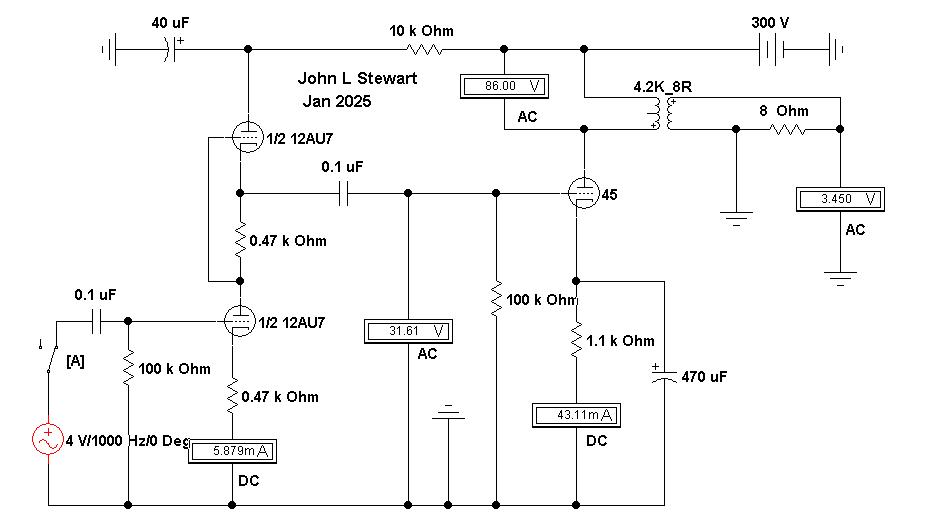

FAIK Dave never favors us with a schematic of his amplifiers,
so I've simulated something here. I think there are two of these
on that well worn chassis. Looks very trouble free & may
still be running. 🙂 👍

Unfortunately most of the reactions deflect from the reason why I wanted this schematic to be published in the first place. Nonetheless I"ll comment on some of them.
Somewhere in the late 50 ties or 1960 an English engineer published an article about selfinverting tube applications. His conclusion: The cathode R should be at least 5x the nominal value for good phase inversion. The nominal value for EL84 PP (trioded) is 270 ohms (Vb 300V). I used 1k8 which is ample above 1k35.
My experience with both cap coupled and direct coupled amps is that the direct coupled ones have the highest transparency which I consider the most important property of a high quality sound system. That's why I wanted the driver tube direct coupled with the power tubes.
Thanks to the high amplification factor of the 84 (19) we don't need a very high dc of the driver tube. We don't need a very high cathode R and the power loss across the 1k8 is not excessive.
From my experience we don't need very high power in the living room usually no more than a few watts. To get the most power out of a pair of tubes was not the issue here; the aim was to get the highest sound quality with simple means.
