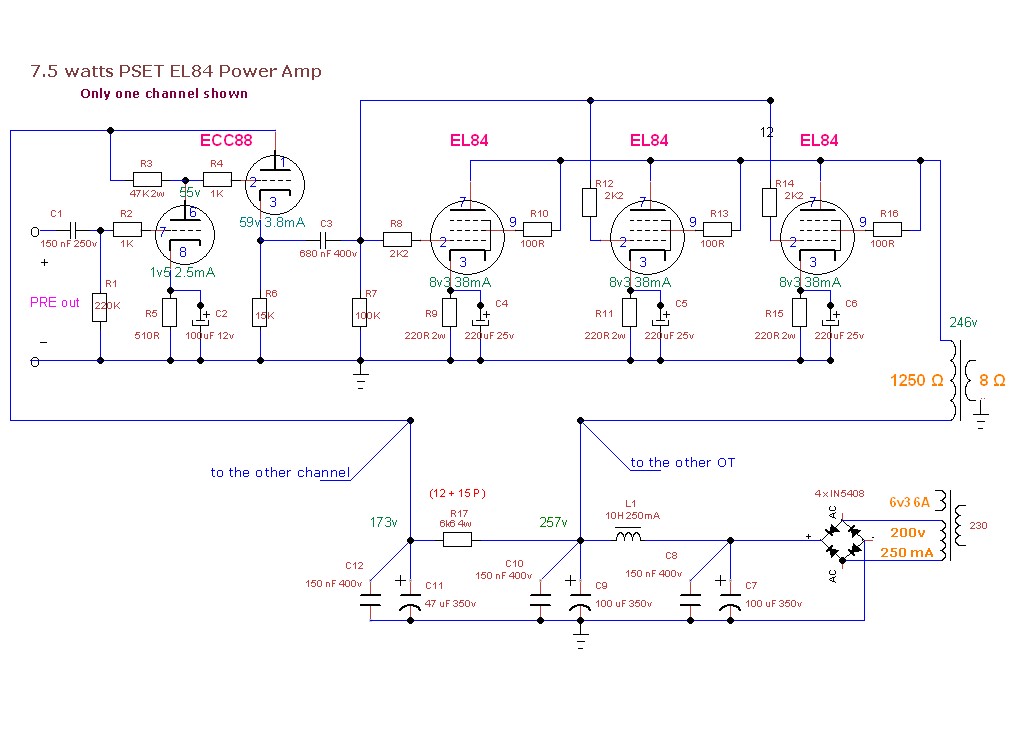

EL84 Parallel SE
I followed your advice and tried to make changes ... this is the result, how about?

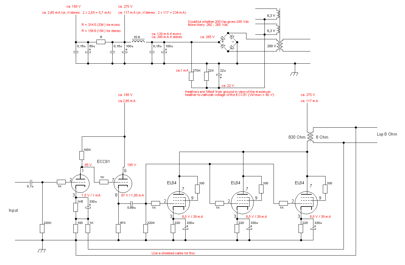

Like i advised before: Because of the maximum cathode to heater voltages of the ECC88 (they differ per triode), you should change the two triodes of the ECC88 around. Use pins 6, 7 and 8 (maximum cathode to heater voltage = 50 V) for the first stage and pins 1, 2 and 3 (maximum cathode to heater voltage = 150 V) for the second stage. Pin 9 (= internal screen between the two triodes) should be connected to ground.

rufus74pz,
Looks like a very good performance.
This is without any negative feedback, except the unbypassed output tube cathodes, right?
With no bypass capacitor(s) on the output tubes cathodes, what is the damping factor?
Then, with bypass capacitor(s) on the output tubes cathodes, what is the damping factor?
Thanks!
Hello
I forgot to add that PSE4P1L has capacitors in the cathodes of 4P1L tubes because here it is the opposite without THD capacitors it is higher. I gave an example of how a capacitor changes the distribution of harmonics and THD. I often use a diode in the input tubes cathodes but it is not so easy to find the right input tubes then the resistor or resistor plus capacitor is left. I apologize for littering the subject.

Hi aria,
The schematic looks fine to me now. But don't you need a volume control? If so, you can put a potentiometer (log type) in place of the 220K grid resistor of the first stage.
Edit: I advise you to put gridstopper resistors to the controlgrids of all the tubes. A value of 1K will do. You allready have gridstoppers at the screengrids of the EL84's which is good (in that position 100 Ohm is fine).
Good luck with the build!

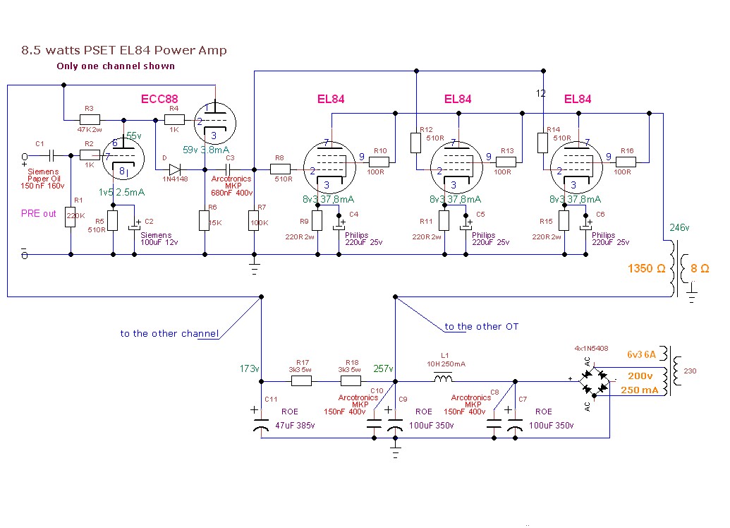

Tks Robert
I would like to use it as a power amplifier using a pre that also has a phono stage ... at the beginning the idea was to be able to also have the alternative of connecting it as an amplifier for medium and high frequencies and to use an amplified subwoofer for low , both connected to a pre so that you can have about fifteen total watts with the help of a pair of biwired loudspeakers. But now I acquired a pair of 96 dB loudspeakers, so I may not need that power ... the only drawback is that those loudspeakers have a 16 ohm impedance.
This could be a more feasible design due to the presence of a more readily available 1250 ohm OT. If I made mistakes, I would be infinitely grateful if you pointed them out.

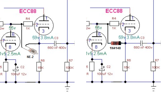

When you switch the amp on, there is quasi imediately high voltage with solid state rectifiers.The tubes are still cold, no current and no voltage drop on the resistors.Resulting in 250V (and more) between grid and cathode of the cathode follower.Not very healty.
Two possible remedies.
Mona
Switching diodes are ready!
As for my project, making more accurate measurements with 2 more reliable testers, I discovered that my OT has only 2 options available and both are not the optimal ones: Turns Ratio 9.5: 1 and 13: 1... I think I will have to opt for the second one by decreasing Iq to 37.8 ... I will have 1 watt more and, I imagine, a lot of distortion as a companion ...
The 13:1 ratio gives 1350 Ohm as the primary load when the secondary load is 8 Ohm.
Power triodes, and other power tubes connected as triode, are not so critical when it comes to their loading. Maximum power will be achieved when the load resistance is twice the internal (dynamic) resistance of the tube. I do not think that distortion will be affected much if you higher the load; distortion could even get a little bit lower.
In your amplifier, each EL84 will see 3 x 1350 = 4050 Ohm. The internal resitance of a triode connected EL84 is about 1700 Ohm (the mu between g2 and g1 is 19 and S = 11 mA/V, so Ri = mu / S = 1700 Ohm) so for maximum power one EL84 should see 3400 Ohm (the datasheet gives 3500). You are close to this value so you will be fine.

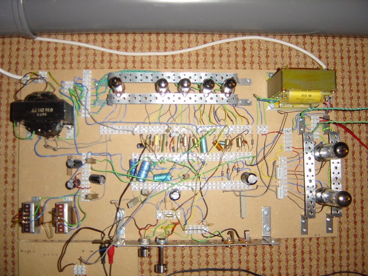

Hi Aria,
If you at first use a flexible way of building, you can try different possibilities before you make a final choice.
Two examples:
The first is an OTL amplifier (no hum/noise at all and working very good).
The second is a guitar amp i gobbled together at the start of my rediscovery of this hobby. Hum and noise were present but i did not understand the importance of preventing groundloops at the time, and at guitar levels this type of building (no shielding by a metal chassis) is sensitive for hum and noise. But at line levels you will hardly have noise or hum issues.
Greetings,
Robert

However, I went on ... I started this thread with a largely wrong schematic and now, thanks to the help of all of you, I have a correct schematic that has evolved gradually taking into account also the materials I have ... in the meantime i started building it and I learned more about what I'm doing, it doesn't seem small to me.
