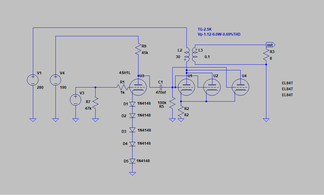

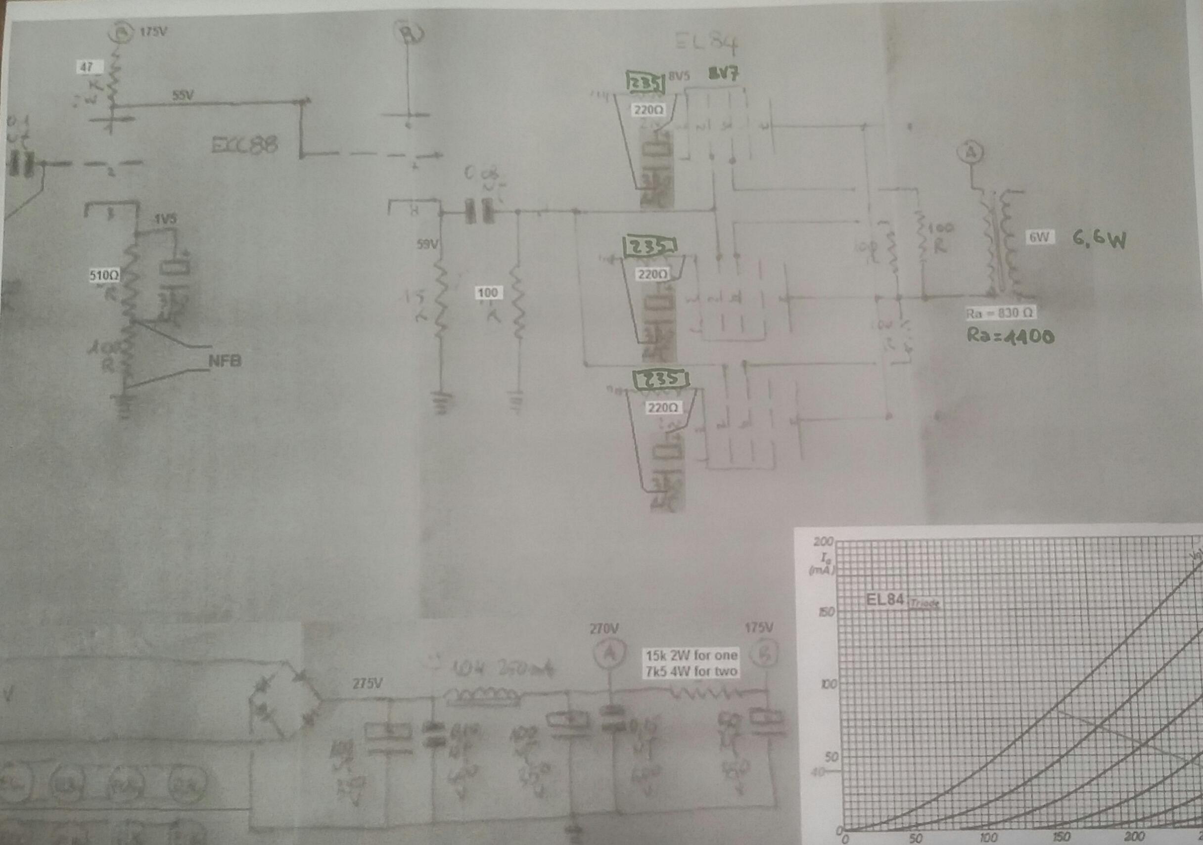

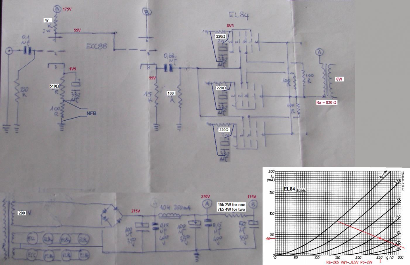

However, I went on ... I started this thread with a largely wrong schematic and now, thanks to the help of all of you, I have a correct schematic that has evolved gradually taking into account also the materials I have ... in the meantime i started building it and I learned more about what I'm doing, it doesn't seem small to me.

I completed the makeshift assembly ... now I wait to find a couple of components that I miss at an acceptable price.

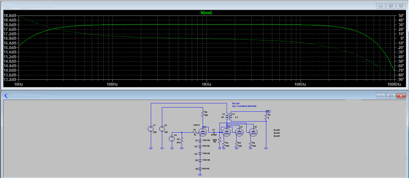

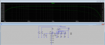

from accounts better redone, for OT of 1350 ohm it has Pout 4.5w and Dout 9% ... not a great result ...
