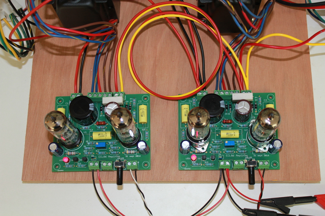

PCL 86 Baby Huey on PCB
Hi tubes lovers,
My first message on the forum, I hope I will not make too much mistakes!
I have read all the discussion on the Baby Huey and I decided to build one, however as a first test (and because I had a bunch of PCL86) I have build the Gingertubes variant of Yves circuit. Since I wanted to make it very compact and easy to build and because no one seems to have done it, I made the choice of drawing a PCB...
Here you can see the result, and as many have already reported, I was very impressed by the quality of this small amplifier and by the power available with only two small tubes. I have not optimized the adjustment yet but it is working very well. Only one mistake on the PCB i choose a resistor too small on the high voltage filter, I had to change it later by a 4W version...
The filaments are powered with a lab power supply at 12.6 V DC and the 4 tubes consumes 1.18 A (they are specified at 300 mA each). For the dephaser, I use an other power supply at - 15 V and for the high voltage I used a Hammond 182L117 toroid transformer behind a non isolated Variac. I made test at 200, 230 and 245 V AC which give me 262, 302 and 324 V DC on plates.
Next project a Bigger PCB for the EL84 version...
Thanks for all the good ideas of smart people available in this forum.
Marc

Bonjour Yves,
Sorry for the mistake but I didn't know that you made a PCB, in fact I have seen on your site the nice small ECL86 anplifier but it was made with point to point wiring...
I have seen that you made a star ground on your PCB, I started to design the PCB with the same approach but finaly I wanted to test a ground plane to see if the result will be good and I was not disappointed. I also decided to make mono blocks to be more flexible and to have separate power supply for each channel. I add one photo showing PCL86 heater current, the schematic and the PCB layout.
Now I am planning an EL84 version but I am not sure for which one I should design a PCB the first one or the version with the source followers ?
Any suggestion ?

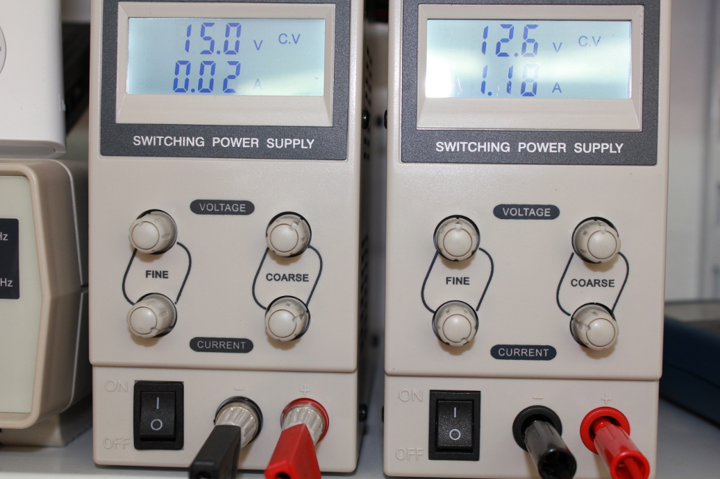

What power supplies are those? Also, what tools do I need for amplifier design? Should I try and pick up a used scope, or is a good multimeter enough?

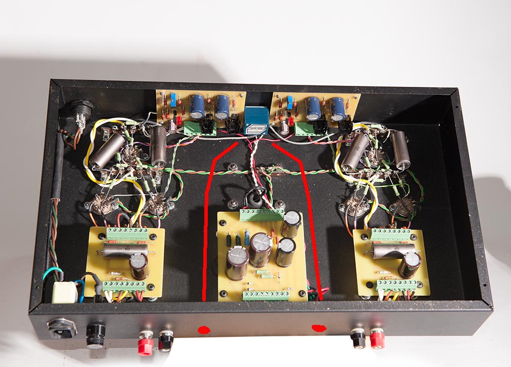

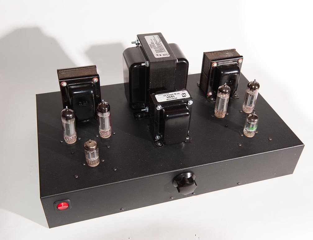

I finished my Baby Huey amp over the summer and have been enjoying it daily.
I wanted to give a big thanks to Ian and all the other members who helped me through it.
A couple pictures of the final project. It also became a lesson in board etching, as I had never done one before.
-Brad

The power supply came from a french retailler Selectronic, reference is QJE PS3010, they are very compact and give up to 10 A from 0 to 30 V. You can find it also on several web suppliers like : https://www.aliexpress.com/item/PS3...y-Output-0-30V-0-10A-Support/32350938723.html
To test an amplifier a multimeter will be enough at the beginning, a scope could be used later to control distorsion.
Marc

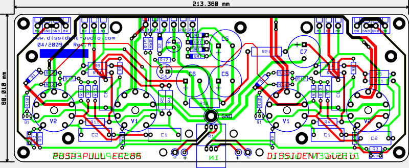

EL84 Baby Huey on PCB
Hi Yves,
I finalized a first PCB draft based on the first version of the Baby Huey (without the MOSFET follower) I have not yet decided if I will make this version ? On the schematic I have provided the option to use either the feedback from the plates or the screen output of the transformer (even if the last comments from Ian were not very positive for the second solution)... You can find the schematic and the PCB below (for a better viewing I didn't show the top and bottom ground plane which I keep since it work so well).
I am also interested in a quad EL84 version and I agree with you that to adjust 8 trimmers to set a good bias for all output tubes is boring... I was thinking to use some kind of auto-bias like what has been done by Norman Koren in a very nice amplifier, "the TENA" : The Emperor's New Amplifier
This solution will insure that all output tube be perfectly biased all the time !
What do you think about this solution ? This will also simplify the design and reduce the cost since 8 hi-quality bypass cap will be avoided🙂
Marc

Hi Marc, this looks very professional, tidy and compact design. If you do make the EL84/ECC83 pcb's I would be very interested to buy a pair (or one if board is for stereo). I was making a point to point version but now would like to build a pcb version. If you do make pcb's could you design it with space for some paper in oil coupling caps. Will you use the Gingertube CCS and Bias block designs? Regards Ian.
