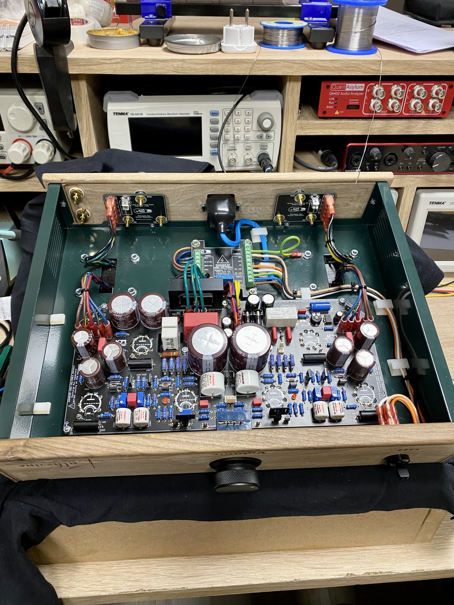

I built the second iteration of the Baby Huey, using Yves schematic but a slightly different CCS on the driver/splitter ...
Dissident Audio PCL86
Sounds great using a pair of OPTs from Ask Jan First that cost less than £80 between them.

Anyone in the US or Canada have any ideas on where I can find transformers? I see that Edcor has OPT’s with the 23% tap I am looking for. Any thoughts on how good those would be ?https://edcorusa.com/products/cxpp25-8k-23-25w-8k-ohms-push-pull-tube-output-transformer
Antek has a transformer with 230-230 and 6.3-6.3 secondaries https://www.antekinc.com/as-1t230-100va-230v-transformer/

For 50V supplies you could use an 18V tranny with a voltage doubler, it would get you around +/- 44 volts which is plenty.
Toroidy. They have standard 40% UL taps, but apparently they will custom wind Ul23% at relatively low additional cost. Check here:Anyone in the US or Canada have any ideas on where I can find transformers? I see that Edcor has OPT’s with the 23% tap I am looking for. Any thoughts on how good those would be ?https://edcorusa.com/products/cxpp25-8k-23-25w-8k-ohms-push-pull-tube-output-transformer

Thank you for your suggestions. Francois, I have heard good things about Toroidy. Unfortunately, the US distributor would only quote me on the standard model. They told me they could not get a custom version from the manufacturer.
I was able to find this Hammond for the 50 volt transformer. https://www.digikey.com/en/products/detail/hammond-manufacturing/166F50/455094
However, it is center tapped. My pcb has a connection for ac (hot and neutral only). If I used this transformer, what would I do with the center tap?
@jazzman - you can ignore the center tap = as an FYI, I ended up reducing the bias voltage, so don't clip the lead too short in case you need to use it as a 25V transformer and not 50V

I assume you interacted with TME in Atlanta regarding the Toroidy OT. TME does not sell the 23% UL version, and it has to be ordered from Toroidy in Poland directly. I have not done that, but several folks here, including @zintolo, had pleasant experiences dealing with Toroidy directly and acquired the 23% UL version at small extra cost (much less than I expected, but I don’t remember the details). I know Toroidy charges more for shipping (than TME), so you better inquire if you decided to go this route.
Your bias transformer (Hammond 166F50) seems to provide 25-0-25VAC. If so, you could simply leave the CT unconnected, if you are using the Rev 1.6 9-pin PCB (schematic dated Nov 19, 2018) where the bias-2 connector is grounded to the circuit ground. I don’t recall that you mentioned which PCB you are using. Your selected transformer is probably over-kill if you plan to use EL84 power tubes. A much smaller 0-30 Vac transformer will suffice, such as: https://www.mouser.com/datasheet/2/410/FD4_36-781155.pdf
Good luck.
Good luck.
Thank you, dBel84 and Francois. I will try calling Toroidy in Poland and see if that would work. As far as the voltage is concerned, that is an area of the BH that I am unclear about. Is there any impact to having more or less voltage for that portion of the design?
The bias required for EL84 tubes typically up to ~16 Vdc. In the Baby Huey circuit (implemented in Rev 1.6) you need an “envelope“ of twice that and allow for losses, so it is good to supply 3x the required bias voltage. 36 Vac supply will yield about 48Vdc and is about as low as you want to go. I thought the 166F50 Hammond over-kill based on current capability, because the bias supply needs <50 ma. Perhaps dBel84 (others?) has experience to add.
