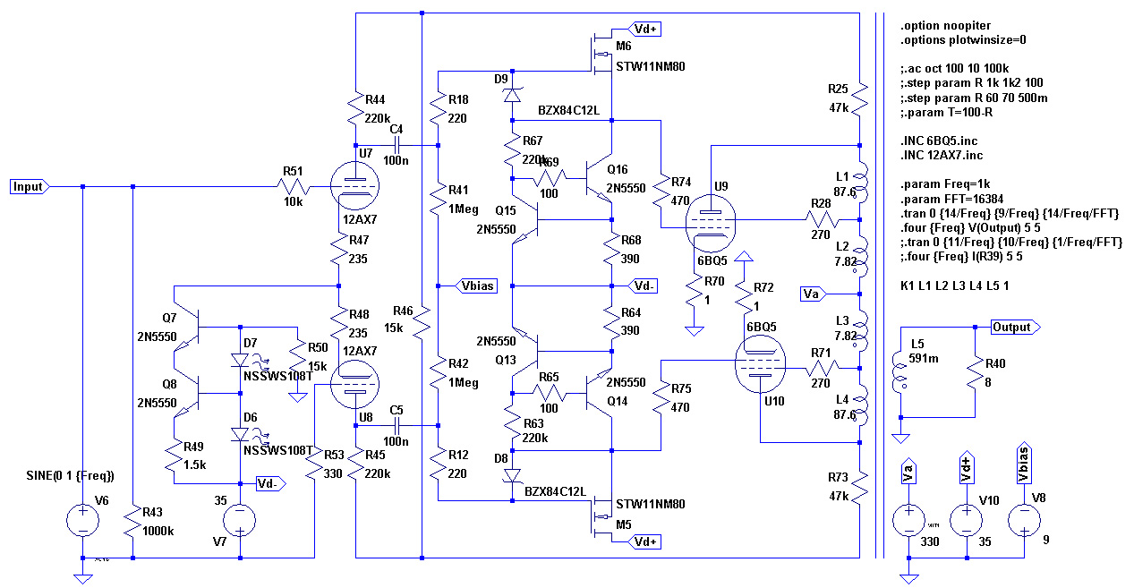

As a reference, I attach here the LTSpice schematic of my amp.
EL84 model shows an higher biasing voltage than what I have (and would expect), but biasing point is the same I have.

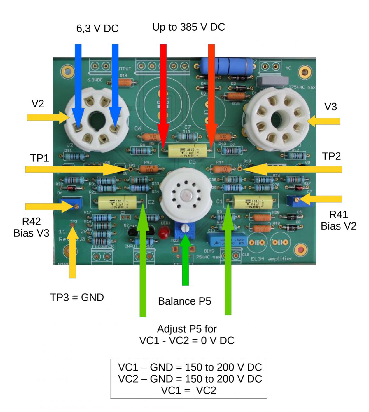

how much do you see the voltage drift between the plates?
I have attached the image from the setup guide : VC1 - VC2 =0
mine seems to drift and if left alone can get as high as 2V and it seems to need to be reset everytime I start up the amp
I am curioous if this is normal behaviour or if I am am still in troubleshooting mode

The plate voltage could drift somewhat do to heat and line voltage levels. The degree of matching between the 2 tube halves will also influence the difference between the 2 plates. 2 volts does not seem like an issue to me. From my experience the balance between the plates does not seem to be as critical in a BH amp. I assume this is due to the cross coupled feedback which works to decrease the differences in the 2 drive voltage phases. I have tried adjusting for minimum distortion and there is no deep null and often the lowest distortion does not occur with the plate voltages matched. So, once you adjust it to 0 volts you should be close enough that there will not be any major issues even with a small amount of drift.
Thank you , that is very helpful . It sounds great on my test set up , am eager to put it into a chassis so that I can bring it to my system.

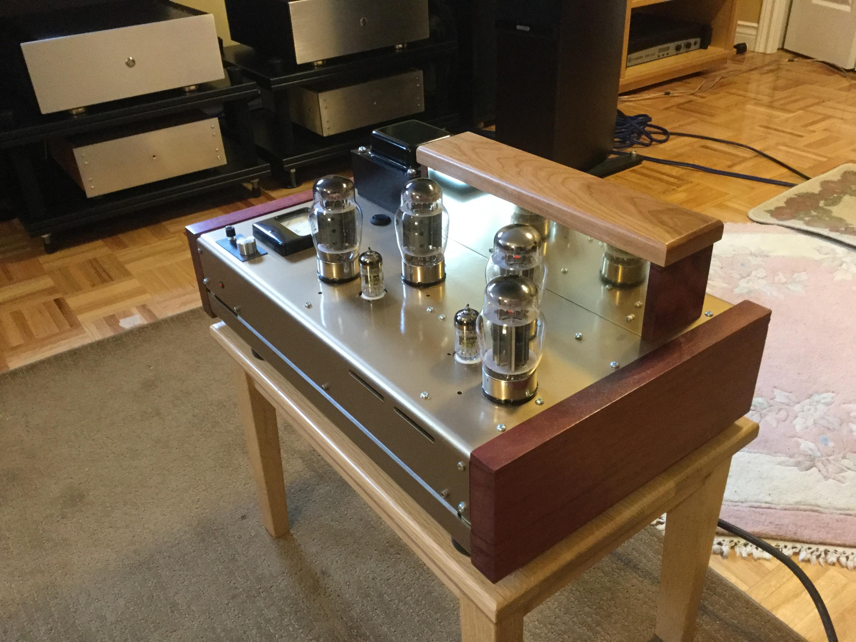

@Bfpca - just noted that your avatar is the BHEL84 - I like the way you angled the tubes, looks great

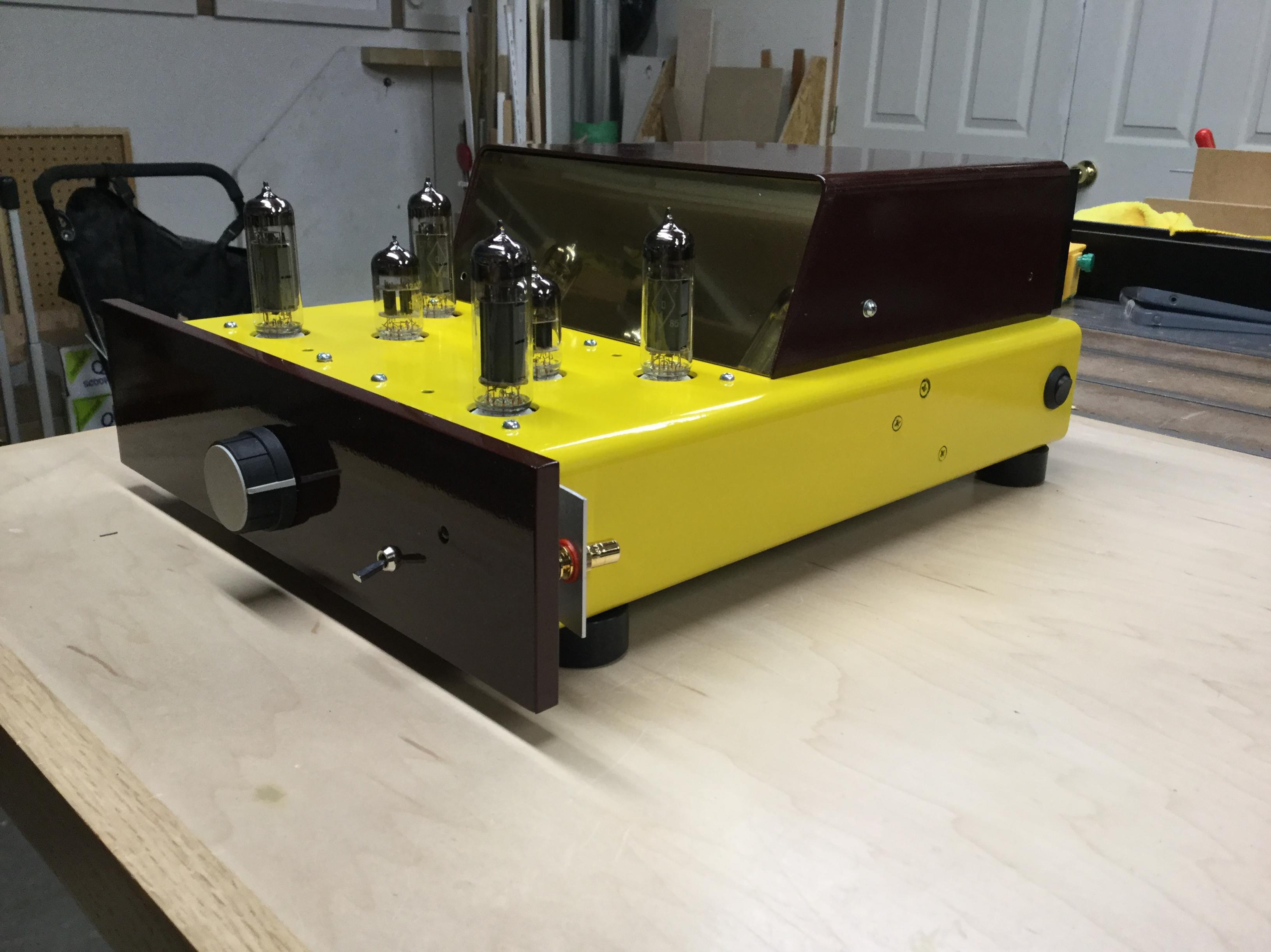

The avatar picture is actually an el34/kt88 BH. I had room to angle the boards in the large chassis I used. Below is my EL84” mellow yellow” BH build. It is using Russian 6p15p-ev tubes. I built this out of parts and paint on hand at about the start of Covid last year. So the bright colour was a symbol of hope! The kt88 build is from a couple of years ago and is loaded with Sovtek KT88s . I like the coke bottle shape!

Paduak is beautiful wood. The sides of the KT88 are Purpleheart but it’s hard to see that in the photo. The top of the HV and bias regulator box is cherry. The output transformers actually live underneath the top of the chassis behind the amp boards. An atypical construction method. The chassis is a clam shell with a hinge on the back, so the “hood” can be raised to work on it.

Random thought on the original post 1 schematic: PCL86s are around for five quid each. If you referenced the positive of a regulated heater setup to signal earth the return would be at 13Vish below. This could give make the T a bit more L in the initial LTP so you could use something like a 10M45S as the CCS. Or is that a silly idea?

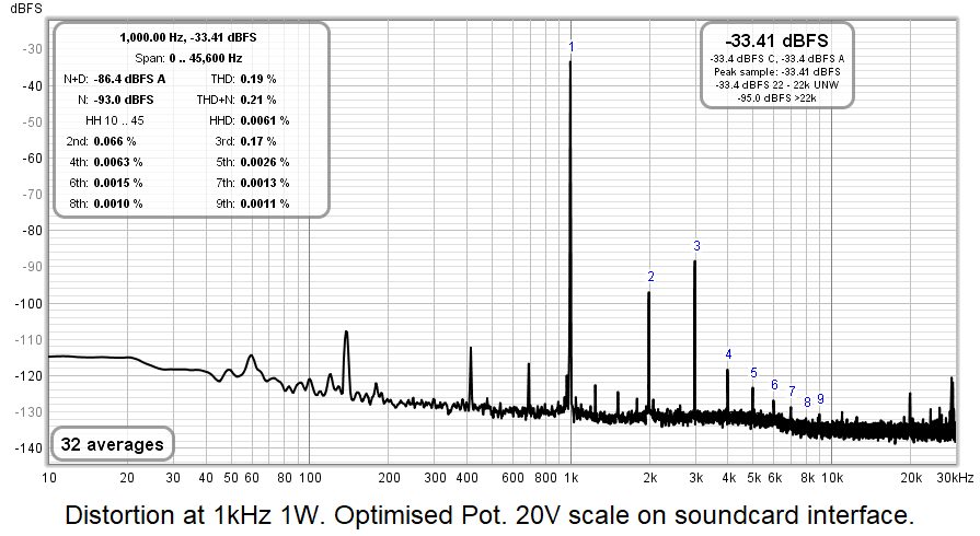

I've finished one channel of my EL84 Baby Huey and made some distortion measurements without any global feedback.
I suppose it's not too bad given the 0.13% suggested by LTSpice. I was able to reduce the THD by 0.08% to the 0.19% you can see by adjusting R5 on the cathodes of V1A and V1B.
