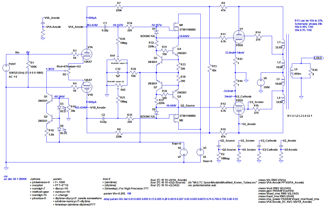

I suggest you to arrange an excel file, especially if you want to play with simulations, because it saves you alot of time.
Good suggestion. Schematic below including the Toroidy EL84 OPT. 404H primary with 43% taps gives Lp of 32.82H and Ls of 18.68H.

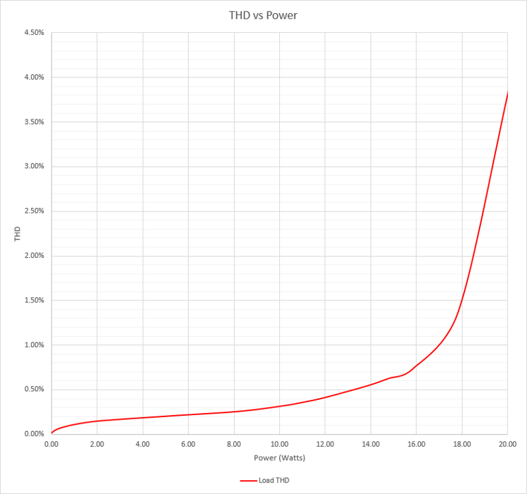

I also have an Excel macro that parses the LTSpice error log and pulls out power and THD information. Plot of THD vs power also below.
THD @ 1W is 0.11%. Less than 1% up to about 17W. 3.9% at 20W.
It'll be interesting to see how the actual measurements compare.

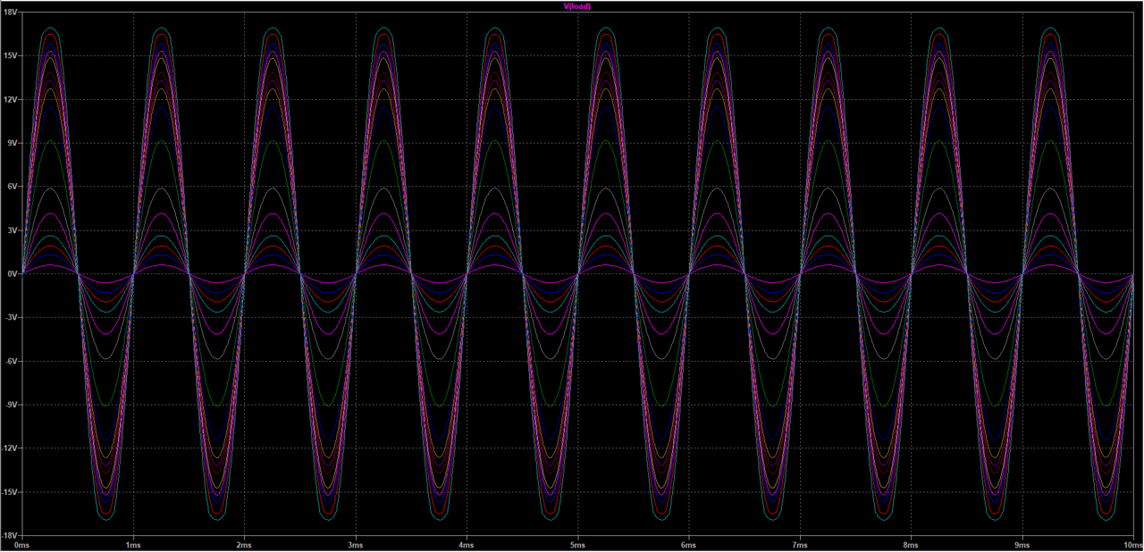

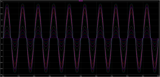

I couldn't resist including the LTSpice waveform plot because it's pretty.
Great job! May I ask you to upload the Excel Macro? Would it be possible to adjust it in order to separate each harmonic, in order to see how it performs?
Here you go. Let me know if you have any problems. I can always zip up the spreadsheet.
I’m enjoying learning about your (and Zintolo’s) simulations of BHEL34 and I’m trying to learn LTSpice myself to be able to do this “magic”.
Could you point me to a reference where I could learn more about output transformer modeling in LTSpice and the calculations of inductance you performed.
I noticed in the schematic that while both of you have 0.6 mA through each triode, you are using one red and one blue LED in the CCS, and Zintolo two reds, with different values of R16. Does that not have any significant influence on the triode currents? Additionally, I thought the purpose of the “two LED” modification was to achieve a 1 mA current.
Hi Francois. I can't point you to a single reference for transformers. I've built up what I know over the years through online searches, downloading and playing with models people post and questions to diyAudio like this rather spirited thread: LTSpice model for a commercial toroidal output transformer.
While not specifically transformer-related, if you haven't done all the tutorials in mooly's great thead I highly recommend it: Installing and using LTspice IV (now including LTXVII). From beginner to advanced.
As for the CCS 0.5mA for each triode was the recommendation for a total of 1mA through the CCS. It was discussed in posts #2420 and #2421.
