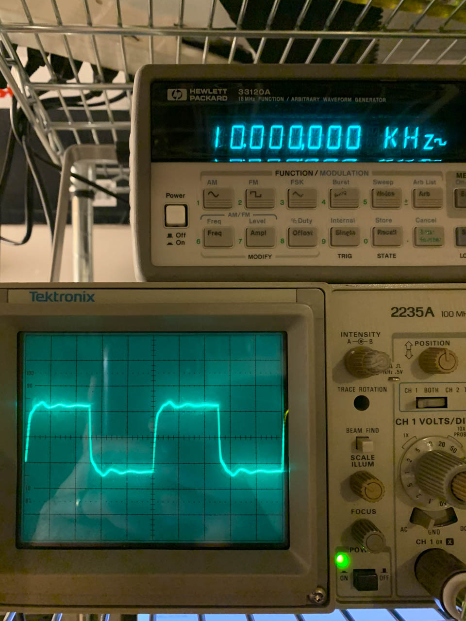

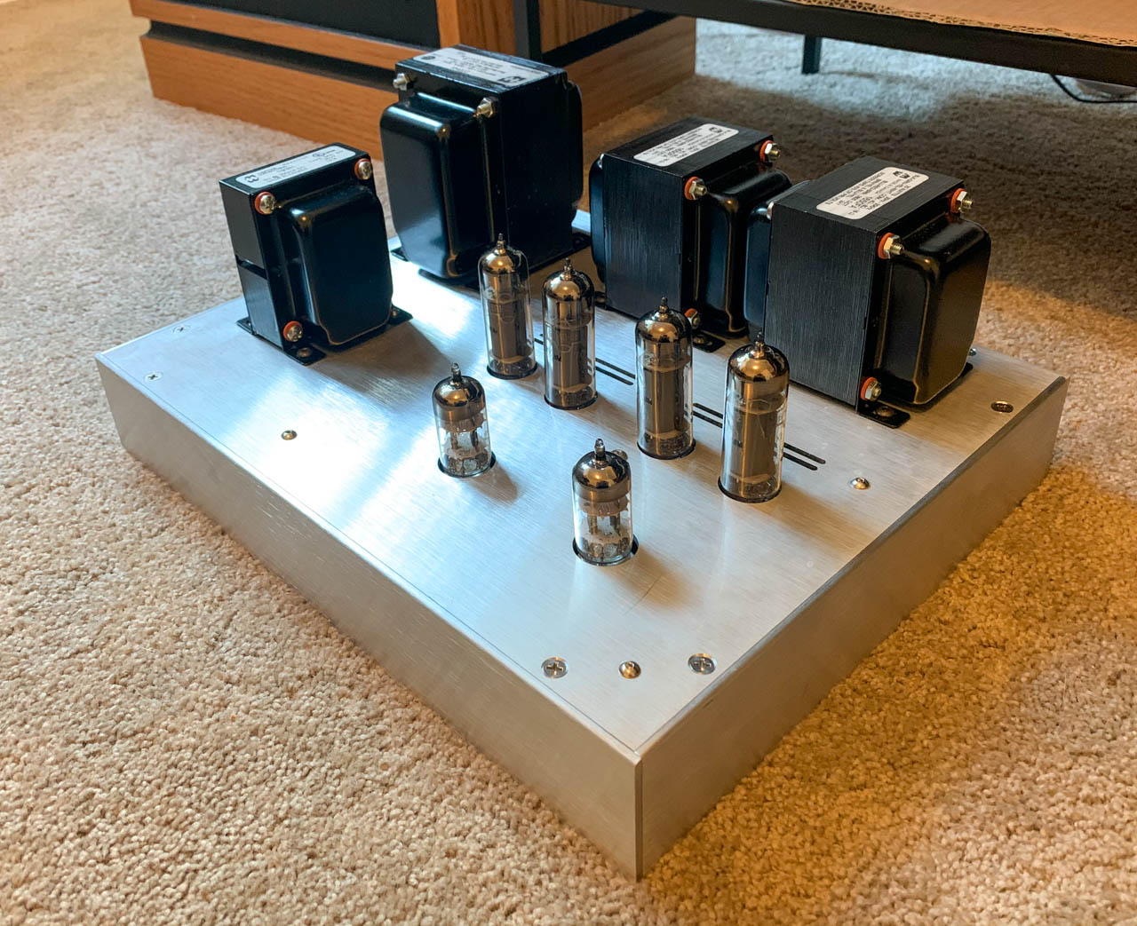

I've used a Hammond 1650FA recently on a Tubelab SPP, wired as UL.
The 10Khz square wave is a bit ugly even with gNFB, but otherwise the amp measures nicely, FR is pretty flat from 20Hz to 20Khz and I really like the sound. Bass is solid with my Klipsch Quartet speakers (IMHO).
Good Job!
Looks great!
The 10k square wave appears to show a small resonance at about 35kHz.
Do not worry too much over that . . .
A transformer resonance at about 35kHz, as you have, should not be a problem,
as long as the negative feedback is stable when loaded by your speaker cable's capacitance plus your speaker's reactances.
Most music does not contain a lot of 35kHz signal to activate that resonance, and most speakers do not have any response there, and most human ears do not work well there either.
Enjoy listening tonight, and then get a good worry free sleep.

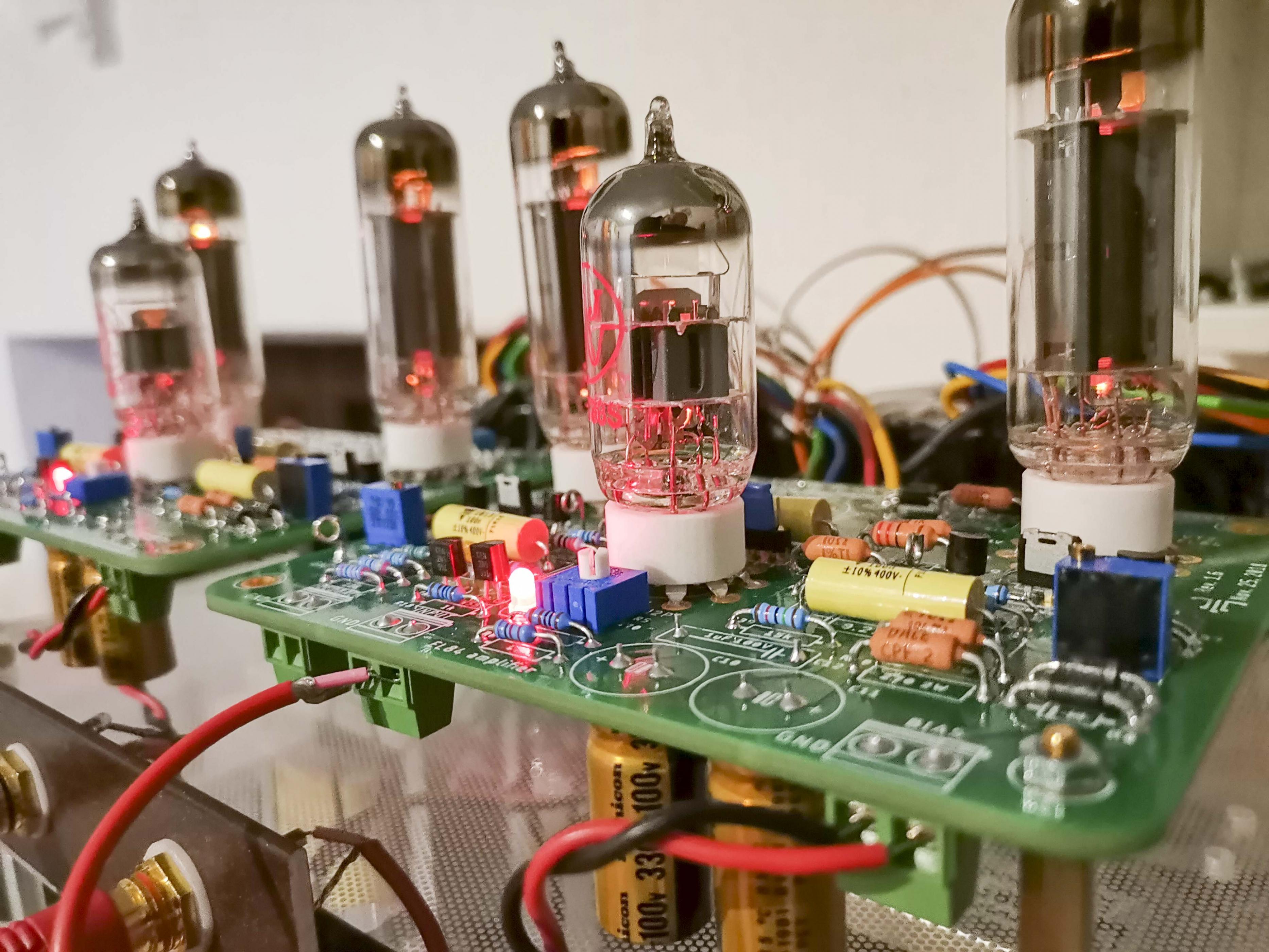

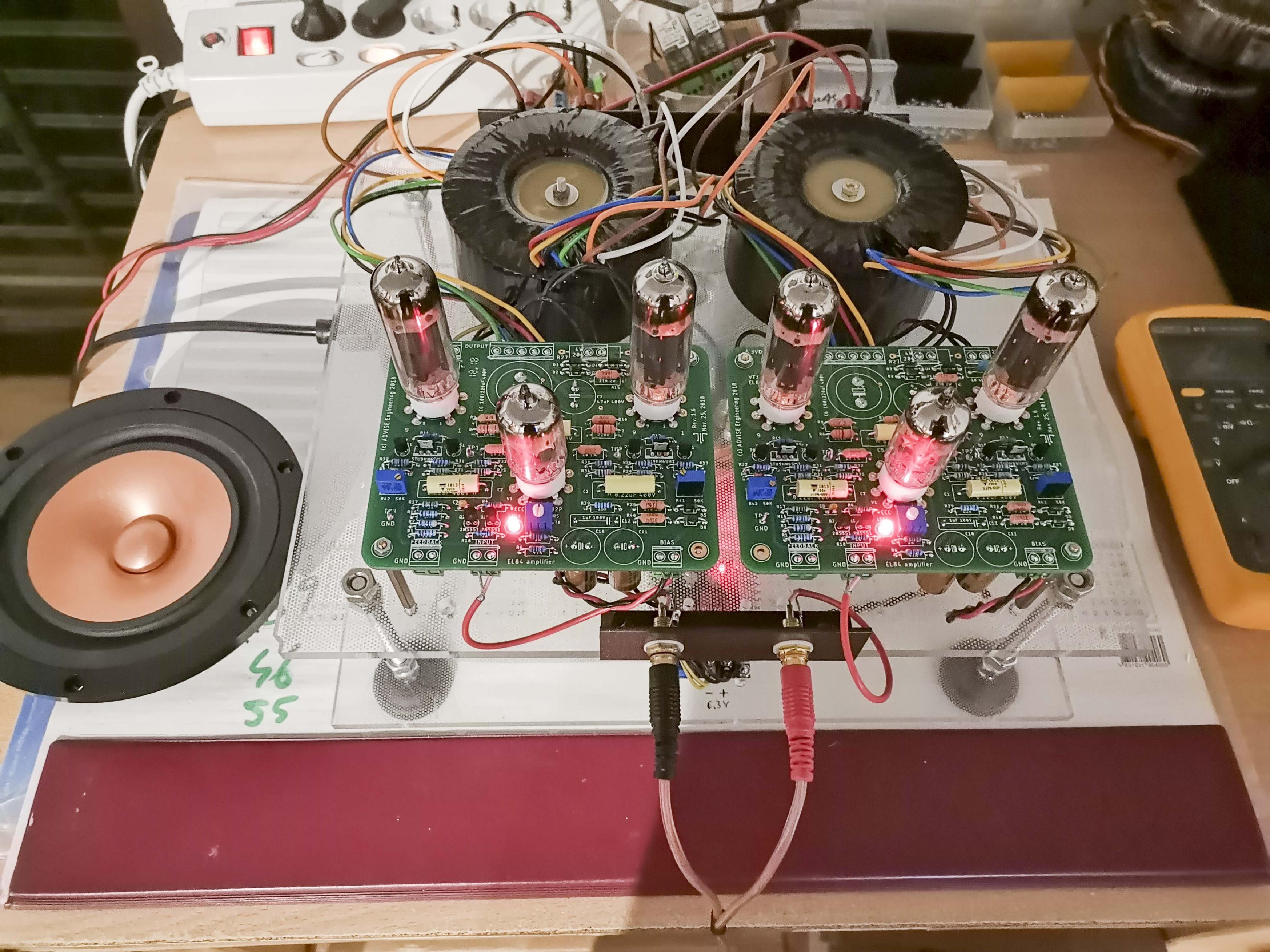

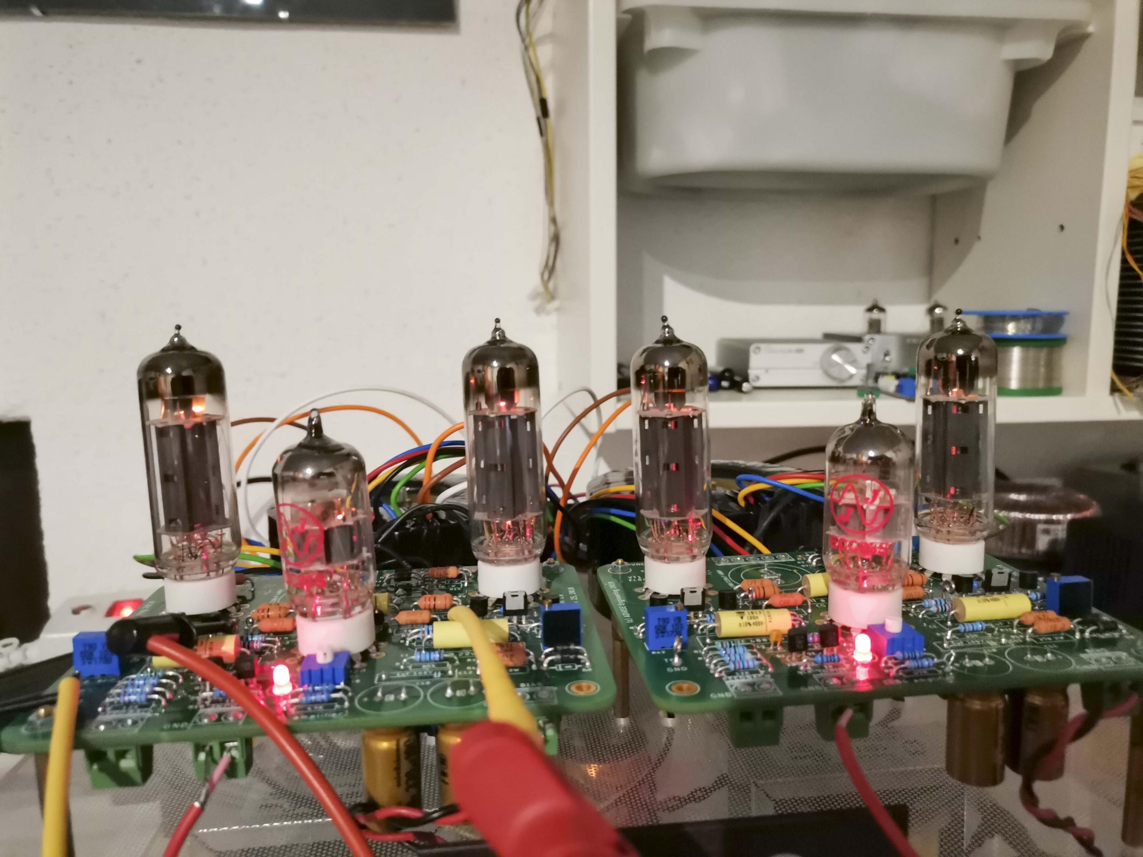

It's alive, sounding good, needs time for some objective and evaluating listening, but sounding nice... 330VDC plate and 36mA bias. For now is still in a prototype form, need to build an enclosure in the future.
Nice looking! It will be more linear if you substitute R16 and R17 as shown on this post:
EL84 Amp - Baby Huey
This is a gingertube suggestion.
Right ... but a bit more details on the procedure for the newbee’s 🙂 Do you do this only after the amp is built according to the tolerances of the parts in the amp? Where do you attach the probe leads and what are the expected voltages?
You have a negative DC voltage on the bottom of the PI's CCS.
That depends on the voltage you set the negative rail at.
The two leds are referred to ground on the positive side, and to the negative rail on the negative side. The differences between the two, minus 1,7V of the first led, minus 1,7V of the second led, divided by 0,002 A give you the needed resistance you need to use to set the led current to 2 mA.
