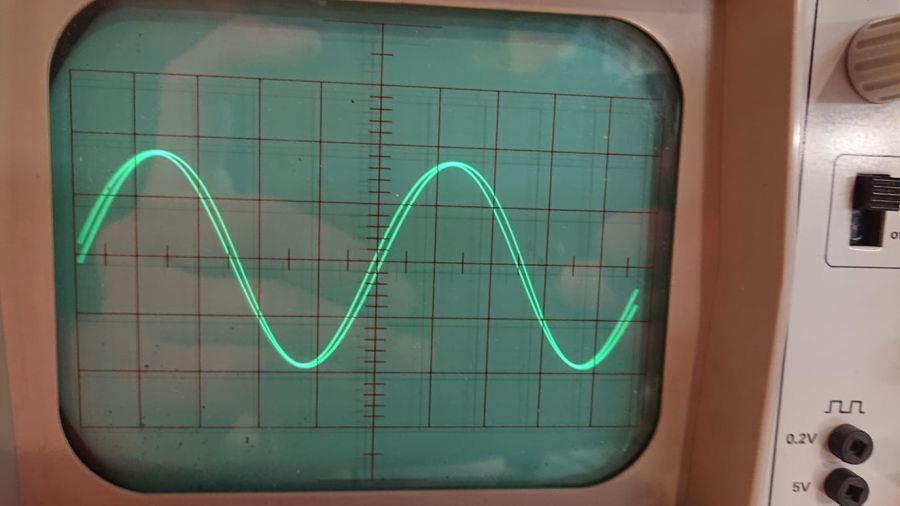

It was (and is) a challenging year from any point o view, but last weekend I put my BH (some details here) on the bench again.
Problem: The sound of my BH got crappy relatively fast. Good in the beginning, but after a few Minutes it sounded like ... "rubbish" would be the best explanation. On the bench everything looked fine?! No way to enjoy music.
Yesterday I digged into it and found something strange. Even after hours all parameters looked like they should. Bias stayed rocksolid, so did the plates. I connected the scope to the BH, added my signal generator to the pre, listened to a few songs via CD and then switched to a 1 kHz Sinus. And here it was:
Overlay Input to Output, causing extremely high THD of almost 3%. Who's the culprit? I found R9/R10 to increase their resistance during heating up - unfortunately not equally, with values from 46 to 53 kOhms, going back to normal values after a few seconds.
I took the BH apart and exchanged the carbon-composit with modern 3W types and adjusted everything afterwards. First session made me smile 🙂.

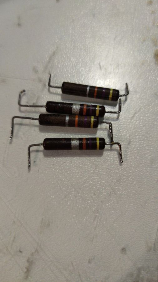

Shoemaker said:I found R9/R10 to increase their resistance during heating up - unfortunately not equally, with values from 46 to 53 kOhms, going back to normal values after a few seconds.

I’m not seeing the reason for the deterioration in performance, if R9/R10 (carbon comp) went back to the specified value of 47k after warmup. Was the distortion noticed for a few seconds only, during warmup, as a result of uneven values of these anode feedback resistors? What “modern” 47k resistors are you using now?

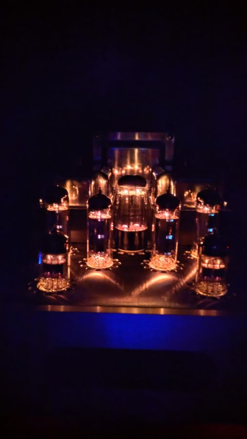

Those glowing tubes on your reflective chassis are sure pretty!
Lesson learned: Never, never ever again, to buy a or build a case just after positioning parts on the table, but to build it twice as big .
Carbon comp resistors drift in value. A lot.
I just took a couple of 15k ohm 1W carbon comp resistors out of the drawer. One had never been used, the other was a 'pull'. Both are of the same batch, same origin, just that I had previously used one and not the other.
The unused resistor measured 14.87k ohms.
The previously used resistor measured 17.53k ohms. <== It drifted a lot!
If you require temperature stability and reasonably close tolerance value, then avoid carbon composition resistors. R9 and R10 are not a place I'd put a carbon comp resistor.

I've never seen such a strange behavior before. Testing on the bench - everything is fine. Listening to the music - crap. So, back to the bench ... This game was put on repeat for several times.
In fact I had 4 extremely temperature- and for that current-sensitive items in the amp. That worked for static biasing or with a constant sinusodial signal, but not for music. On the scope it looked like the output amplitude was dancing around the input amplitude for a few seconds, e.g. when increasing the input level.
Long story short: Bye-Bye - Bin! For now I've thrown 4 MOX (normal stuff, not from China) in I had in stock. I like CC more. Maybe just a bad batch?
Highly appreciate that you like the design and the pictures! Tubes in fact are beautiful models 😎
