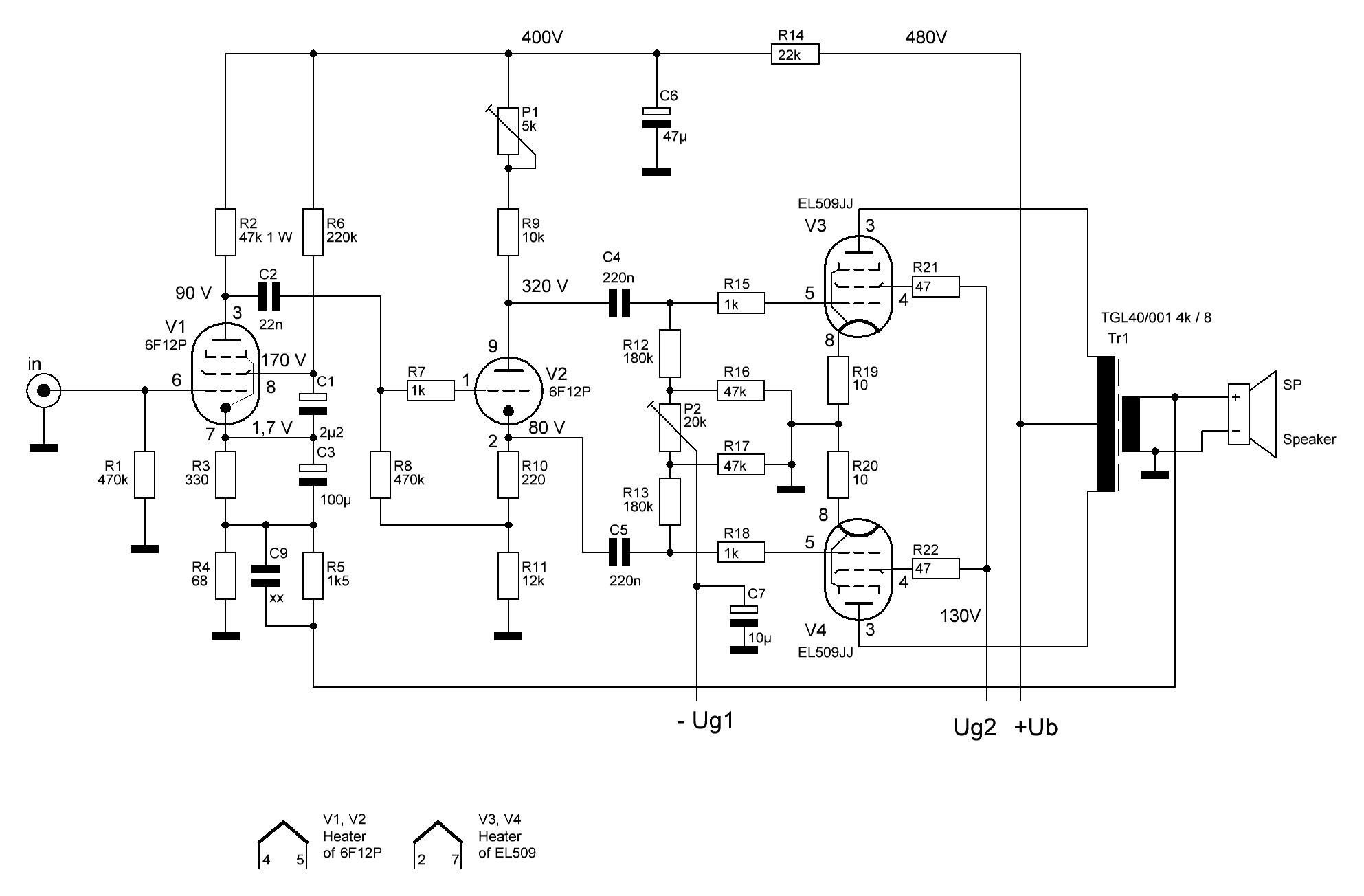

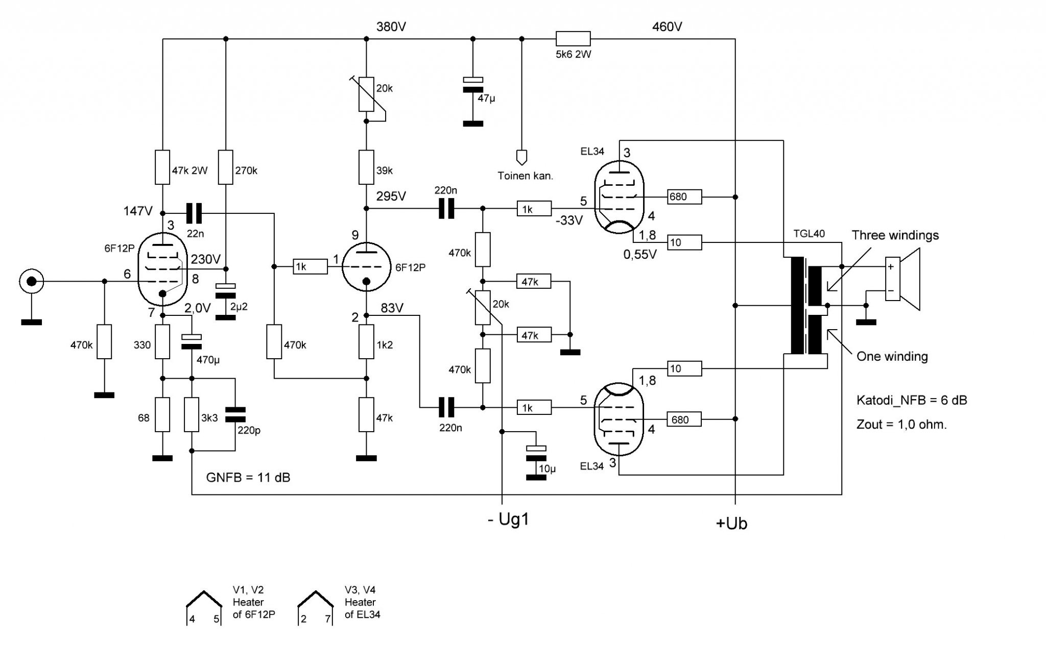

Here are the schematics I have used. Attached also are test results of EL34 PP with TGL40 as pentode, UL and cathode feedback.Do you have any links to schematics using these?

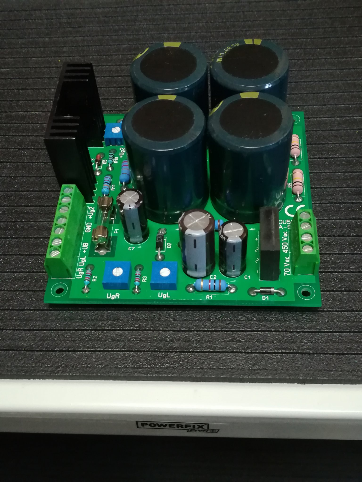

Essential with JJEL509 (=PL519) is to have regulated screen and -Ug1 voltages.

Hello,Here are the schematics I have used. Attached also are test results of EL34 PP with TGL40 as pentode, UL and cathode feedback.
Can you explain the cathod feedback please ?
Quad II works with cathod feedback ,but it's different (and i don't understand it too)

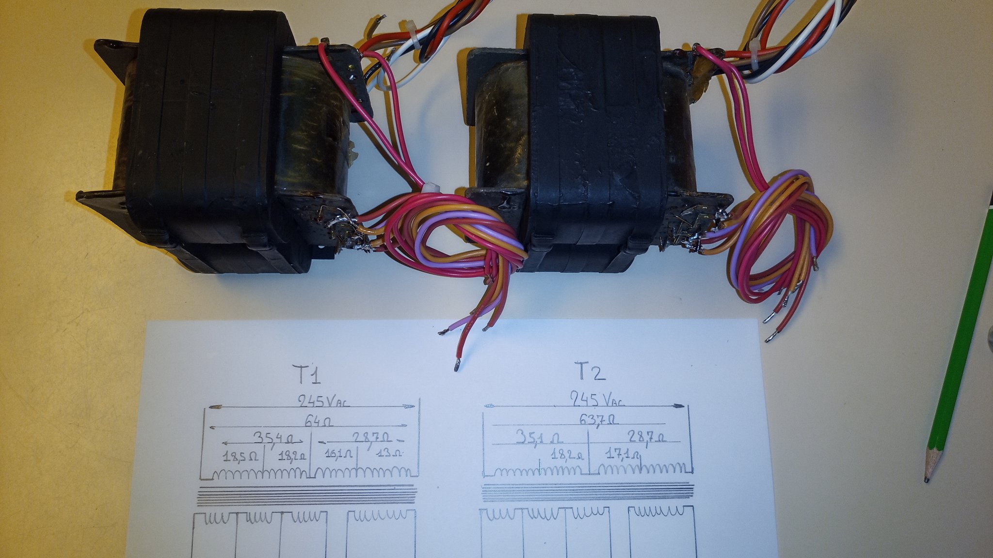

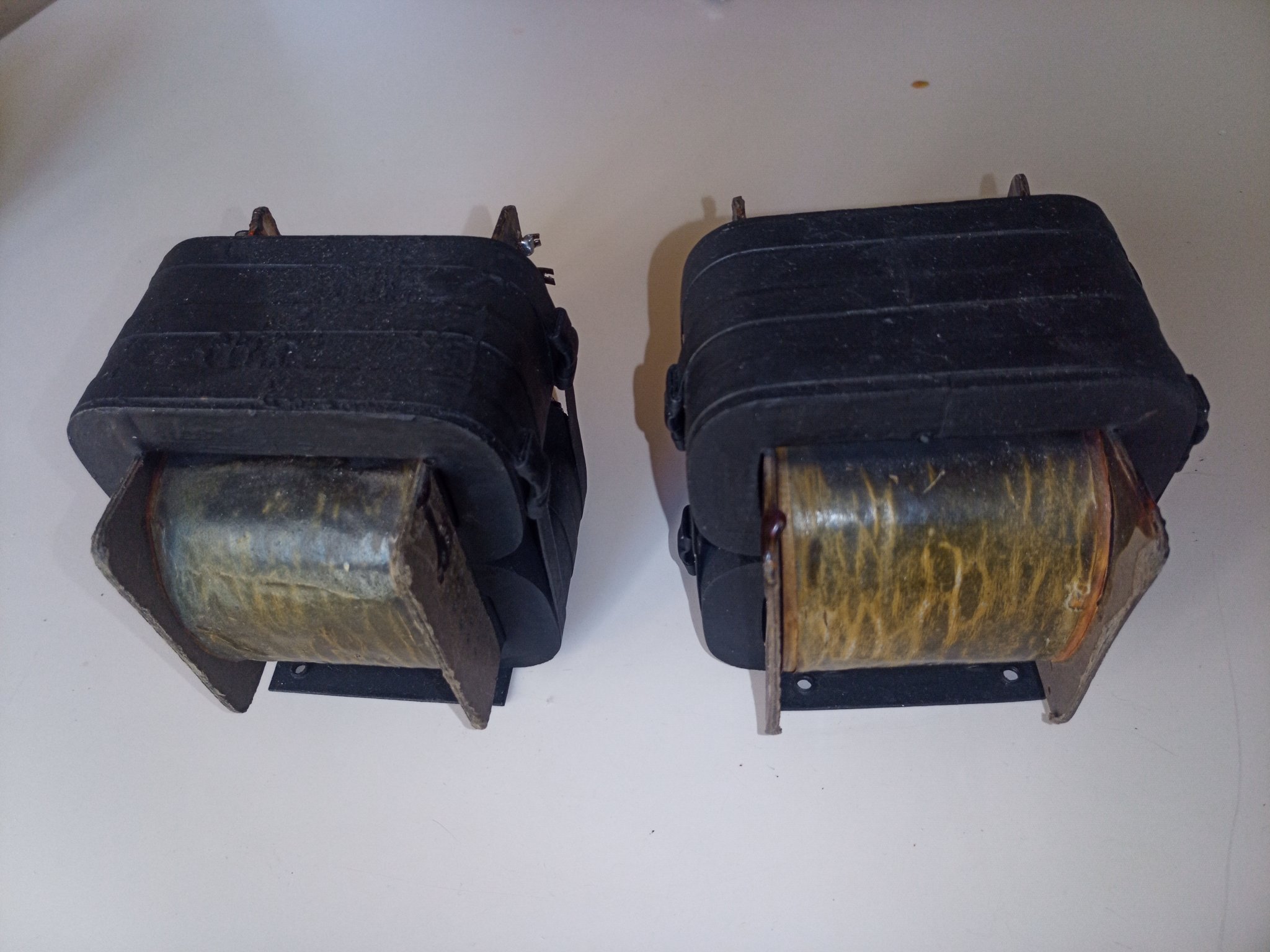

I owned a cheap strong a and strange pair of output transformers in a goodwill.
Have a look, windings mesures coming next,i must draw the schematic.
The iron is roughly the same size as the tgl 40/001 one.

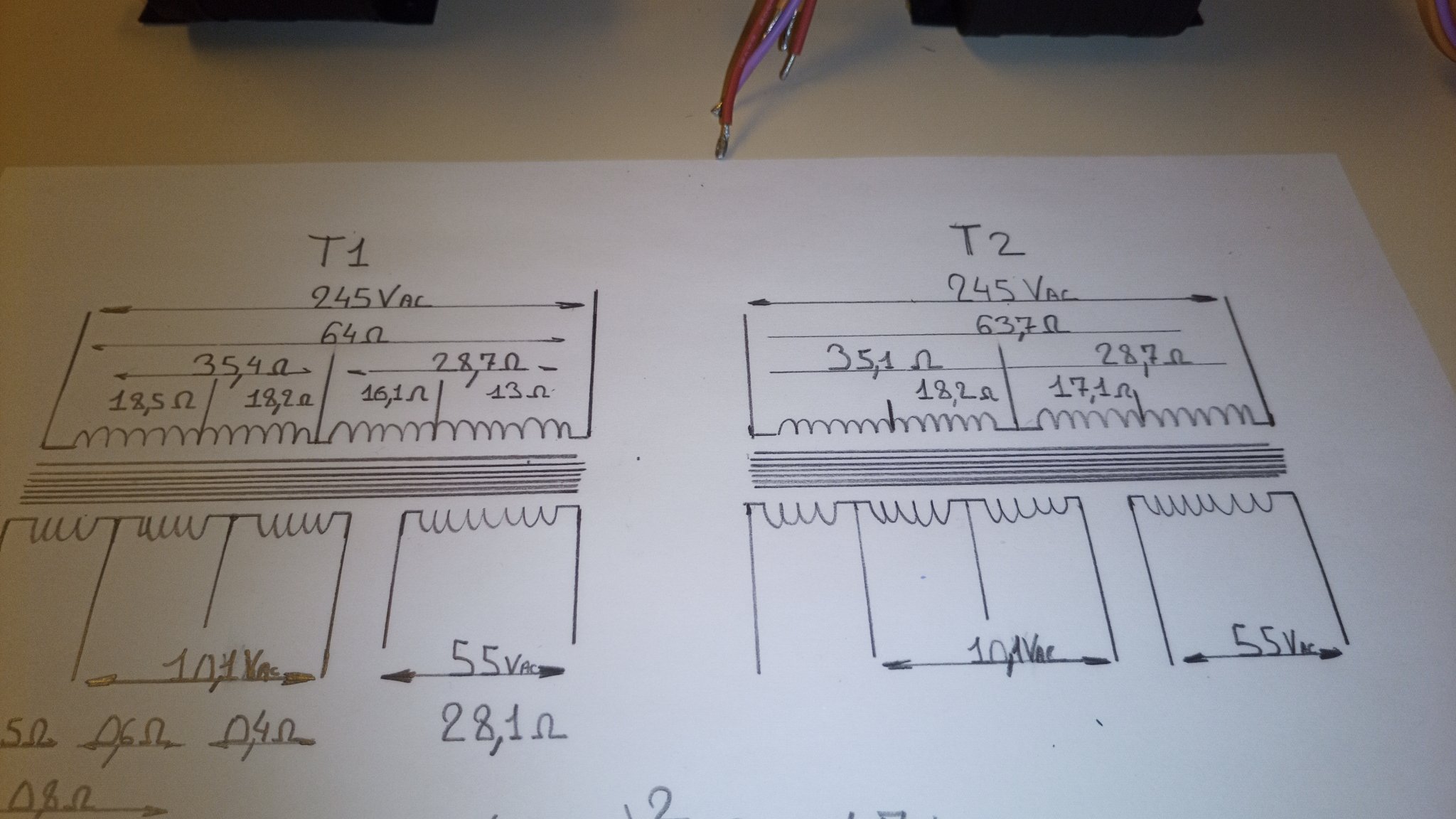

Voici donc le schéma, je les ai branché sur le réseau 245v et mesure 10,1v ac en sortie. Z est 4,7k.
Comme vous le voyez il y a un autre bobinage qui donne 55v. A quoi ça sert ?
Please.
Please.
