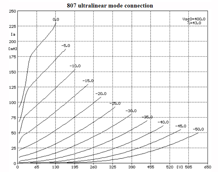

Id expect the 807 to run out of current at high signal values, but the output stage can of course be tuned. My comment was about using the original schematics, voltages etc but just plugging a 4ohm speaker.
I assume it's the leak TL25 amp.
The 807 can work in class AB2 in both triode and pentode and so it's capable of high peak currents. UL is in the middle in terms of anode curves and so it is possible as well. Staying in class AB1, the current will be according to its UL curves and load. It will be less power respect to 4K load but not because it runs out of current.

To be honest, looking at the thread I'm not sure whether @Marco audio is designing something from scratch or based on a particular schematic voltages set etc, therefore I will shut up for the moment 🙂
