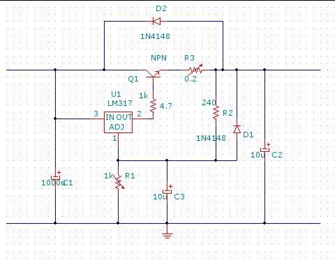

This alim use a LM317. The value for the components are just a guess. You must know the output voltage (as ex. 6,3V), the output current and the input voltage in order to calculate the correct values.
The doc for the LM317 can be found at http://www.national.com/ds/LM/LM117.pdf
The formula to calculate the components are inside the doc, as well as other exemples.
The transistor is to obtain more current and power from this alim. You can even use a darlington, but a simple npn must be sufficient up to current equal to 10 time the maximal current the LM317 can drive, that mean 10 time 1.5A = 15A.
The type is not critical, it must be abble to drive the output current and have enough power dissipation.

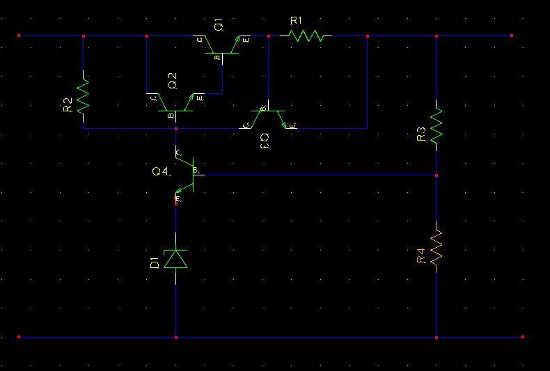

Another circuit only with npn. It is a basic alimentation circuit. The zener is the voltage reference, Q4 compare the voltage on its base with the voltage on its emmiter and drive the output darligton Q1-Q2.
Q3-R1 is the current limitation. Very basic but sufficient. Q3 will conduct when the voltage drop on R1 become ~= to 0.6 volt. It will drive the current from R2 and drop down the base of Q2. This will limit the output current.
As before, you must know the output voltage, the output current and the input voltage in order to calculate the values of the components.
Those 2 circuits are for use with DC only. For AC, a simple way to obtain a current limitation at the start is to use some VDR in the heater circuit. A vdr is a resistor that have a big resistance when cold and a little resistance when hot. It will work with DC too. It can be harder to find a appropriate VDR as to find a few npn or a LM317 or similar.
