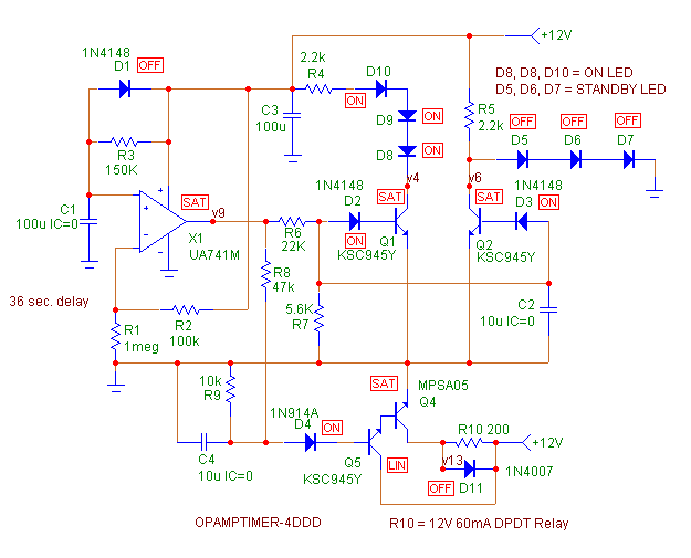

Opamp timer anyone? With LED standby + power on indicators...

Yeah I know, I've added a lot of bells and whistles to it! 😉 Trying to show off but you could use another chip to replace all those bjt's or an all in one chip! I do stuff like that to practice logic in my one remaining brain cell!
Actually you can almost drive a 60mA relay straight from the op-amp itself, but 1 extra piece of sand (BJT) aka 2SC945, 2SC1815, 2N**** as a buffer/driver/inverter will make it more reliable and easier to implement. Even some unknown npn/pnp piece of plastic in your coffee can will work!
A 555 may introduce noise depending on your gnd'ing etc. I dunno!

Opamp timer anyone?

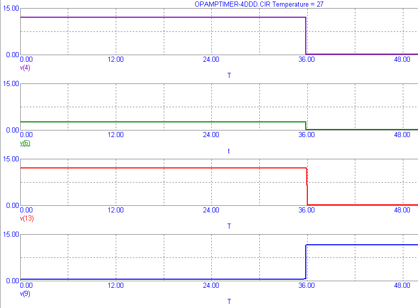

Yes it is, two (maybe) resistors simplier. I threw in an opamp timer so anyone who did not have a 555 would not have to go out and buy one! I have a parts drawer full of them. You can do the same bells and whistles with a 555. You know like two LED's, one for power on RED, one for standby YELLOW.
Opamp timer:
1 coffee can opamp
4 resistors max, can get away with 3
1 cap (timing)
1 coffee can diode
1 coffee can transistor
Very simple. Resets almost immediately on power-off. Diode drains timing cap.
Wayne 😉

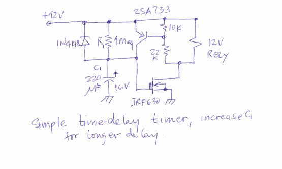

navin,
here's as simple as it gets, time delay relay circuit, values are for 3secs delay, just increase the value of the capacitor an series resistor for more delay.
