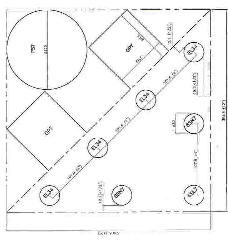

The attached is my left channel amp layout.
The OPT with the dimensions given is the rear of the box and the right side of the box is that side where the diameter of the 6SN7 is shown.
Object:
1.To keep the Power supply as far from the 6SL7 as possible.
2. Not make the chassis too large (under 150 sq. in if possible)
3. Enough room around the 6SL7 as it has over 15 passive components attached to it (for 2 channels)
I looked at many layouts and liked various features of each then figured that the Power supply would have greast interferance when the signal level was low.
Q1: Is the distance between the OPT and the EL34 too small
Q2: Is the distance between the PS tranny and OPT too small
Q3: Any preference with which OPT should be wired in Triode and which in UL?
If this looks ok I would consider making a mirror image of this for the right channel.
