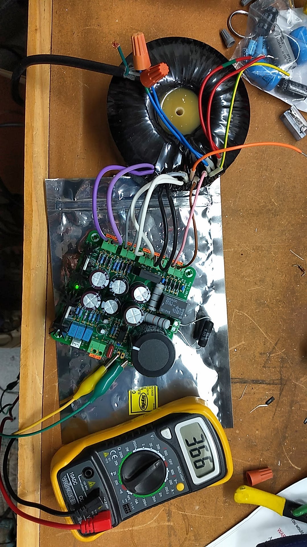

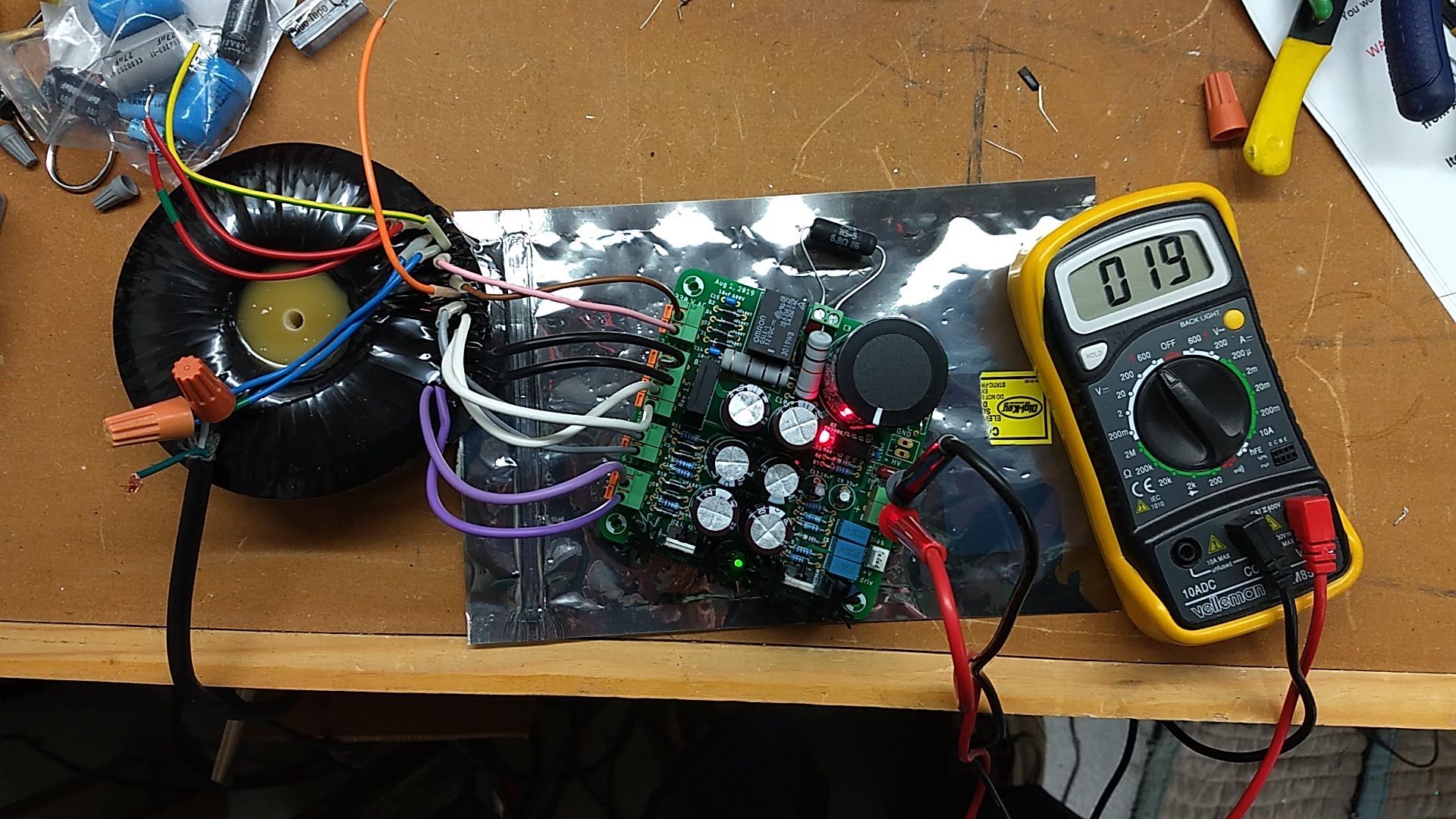

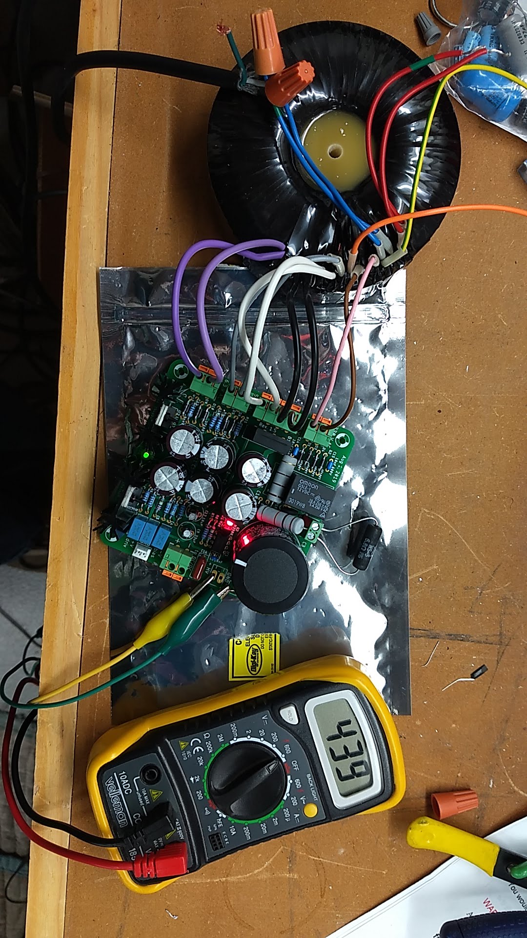

Finished up my MK2 Power Supply. Still waiting for my choke and Buck to arrive and the connector for the High Voltage doesn't look correct as it only has one pin. Need to go back to Mouser and find the right one.
Pics of High Voltage out, pre timer and post timer and the output for the DC/DC buck.
No pics for the driver/bias outputs, but they are 19v and -149v.
A few Notes:
The 10 ohm R14 and the 10K ohm R15 are tricky to get in there as there is little space for 5W resistors.

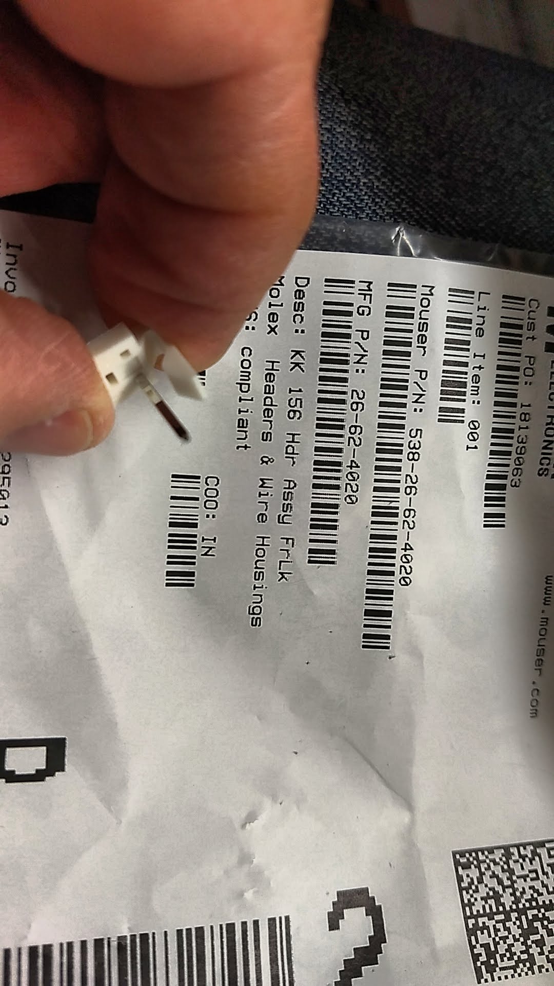

Make sure to purchase the correct connector for the HV.
Be careful of the polarity on the LEDs, it's not listed on the screen printing on the board.
gabo

Nice work Gabo!
Those 5’watters are tucked in tight, I hope they don’t get to hot under load.
Yea I'm a little concerned about that as well. I actually bought several different ones trying to find something small.
I angled the 10K one up to give it a bit of room underneath to try to give that NTC a bit of room, but it's not much.
We'll see eventually.
gabo
gabo,
Thanks for sharing you progress and findings. Very helpful and we are enjoying the process as well as gaining insight.
By my calculation R14 (10 Ohm) dissipates around 0.4 watts steady state, so a 2 watt resistor should be fine. The 10k resistor will dissipate a lot more than 5 watts initially, but goes to zero when the switch bypasses it a few seconds later. I might install the PSU board vertically against a chassis side and put 10k between the board and against the chassis for some additional thermal mass and heat sinking.
Good luck with you build.
