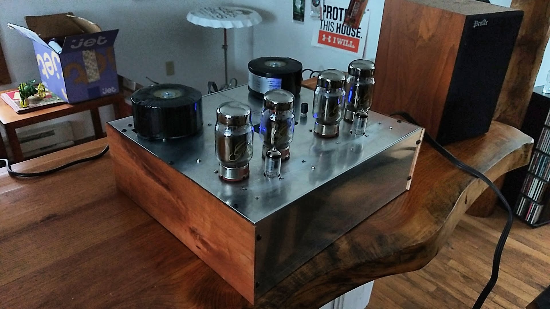

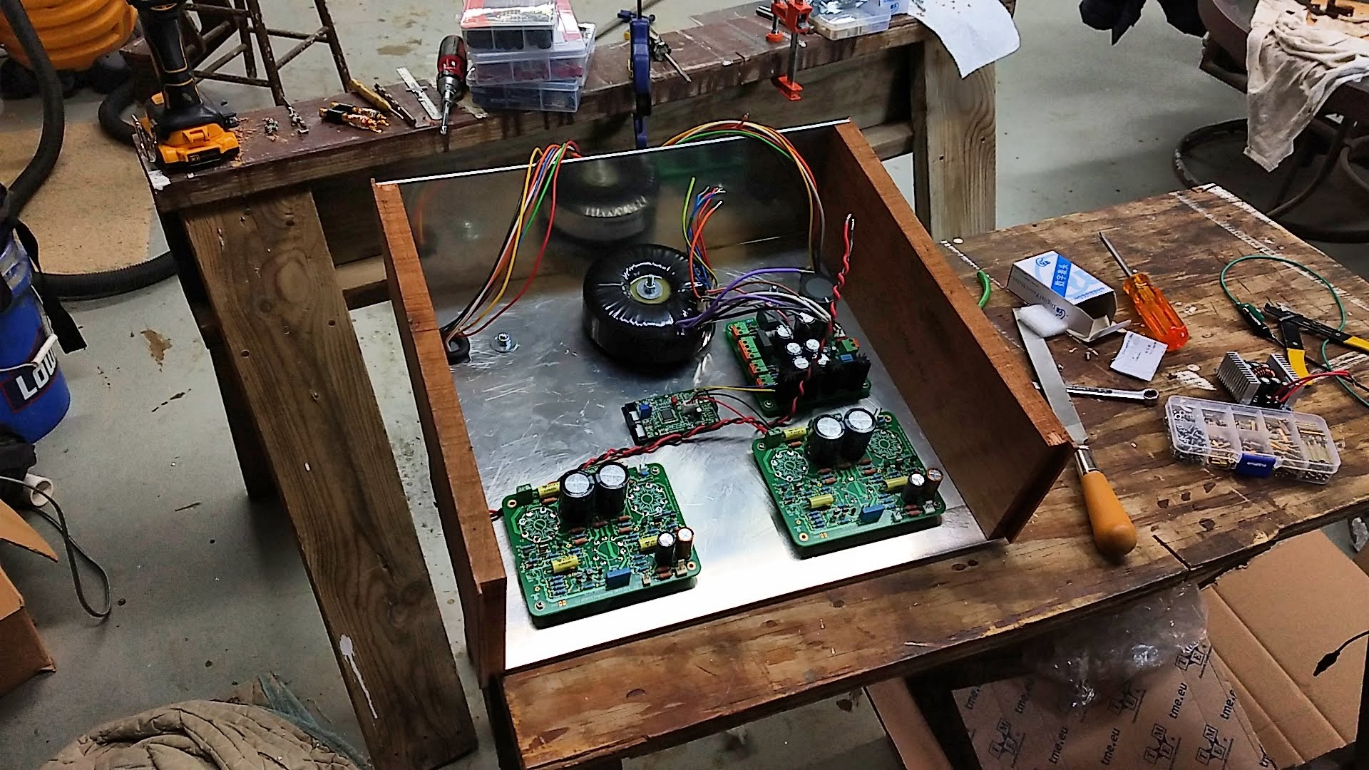

Test Drive of my BH
Today I put together my BH to take her for a test spin. It sounds great.
Now I am waiting on covers from ebay for my output transformers. When I get those, I will take it back apart, drill the holes for them and paint the chassis.
In the meantime, it's got that junkyard dog look, but sounds good!
Here are pictures of fitting the boards in the chassis and the fully assembled and playing BH.

Hello Gabo what bias do you need with the KT88?
cordially
KT88 Bias
For my KT88s, I'm using 40ma bias, which I was lazy and found at this web site.
Tube Bias Calc
Instead of downloading the data sheet and doing the calcs manually. That's probably very low and conservative, I think a 70% calc would put me somewhere in the 53-55ma range.

KT88 Bias
Actually, now that I look at the data a bit closer. I think I'll change my bias to about 55ma for my KT88s.
That puts me squarely in the 70% range, which is probably about right.

Hello,
what is the value of r39 because on the diagram it is 15k and in the bom it is 18k.
I ordered the power transformer at toroidy as recommended by Marc, is there an advantage to supply with the voltage of the winding 330v instead of 275v (I mounted capacitors 500v)?

I totally agree with gabo. I searched for an inconsistency in r39 in published schema vs. BOM values but could not find it. Please let us know if there is an error somewhere unnoticed.
Also agree with using the 330 VAC winding if you build for EL34 or KT88 output tubes. 275Vac would be better for 6V6 or 6L6GB tubes. You can check what Marc said about it in post #594, predicting theoretically 460Vdc with the 330 Vac winding; in practice gabo measured 437 Vdc in the handy voltage chart he posted in #655.
Gabo, correct me if I’m wrong, but I believe you measured it unloaded, i.e. without output tubes installed. It would be helpful if you could measure and publish the voltages when fully loaded, at you new operating point, I think you said 50-55 ma per KT88. I‘m looking forward to your assessment of performance at the “hotter” point.
Hey Francois, yes that is my voltage using the MK2 power supply board with the toroidy 250/001 transformer and the 330Vac. And that was unloaded, meaning the output tubes were removed but the 12ax7 was installed.
That's a good idea on making a new chart with fully loaded voltages, I'll try to do that sometime this next week.
As for the 50-55ma bias point, I did not really hear much of a difference. So I backed off a bit and have settled (for now) on a bias point of 48ma. I've run them as low as 40ma but the amp seems better just a bit higher.
The amp sounds fantastic after quite a bit of listening. However, it does get really hot, so I have taken it out of service and have it back in the shop. I'm going to cut some more venting holes in my chassis and I have also ordered a fan. I'm going to mount a standard PC chassis fan on the bottom cover. It's sort of an odd place to put a fan, but I don't have room on the back and don't want it on the front.
With the feet I have on my chassis, it'll be ok on the bottom. I have ordered a 115Vac fan so I can connect it directly to the mains input and not load up my PSU with that. I'm also going to put a resistor in serial with it to turn it down to a fairly slow speed to keep it quiet. I guess I could mount a pot on the back to turn it up/down, but I think just a fixed resistor is ok. I'll have to size it when I get the fans.
The idea is to just provide a bit of airflow from the bottom up through some holes in the top, keeping the noise (and dust) to a minimum. I did also order the filter for the fan to help keep the dust out.
