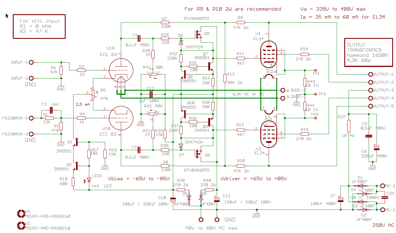

The + supply for the MOSFET Drain is determined by 2 things:
Too high and you just end up dissipating extra power in the MOSFET.
Too low and the Crss (Capacitance from Drain to Gate) varies with Drain to Source Voltage which can mess up high frequencies in particular.
The MOSFET Datasheet is here:
https://www.st.com/resource/en/datasheet/stu9hn65m2.pdf
Look at the graph labelled Figure 11.
The Source will have the audio signal on it. You want enough +ve Drain voltage such that on signal +ve peaks you still have around 30V (ideally 50V) across the MOSFET Drain to Source. For that voltage, the Capacitance is low and steady (not changing ). The +ve Peak of the audio signal on the Source will be around 0V so Minimum of say +30 to +50V for the Drain Supply.

Thank you for your clear explanation and the Mosfet datasheet. The recommended TOROIDY TSTA 0250/001 power transformer, and the Mk 2 PCBs are arranged to provide +15 Vdc from a 6.3 Vac doubler supply for the Mosfet Drain Supply.
If I understood you correctly we would we be better off aiming for +30 to +50 Vdc Drain Supply. Figure 11 in the Mosfet datasheet shows that Crss begins to level out above about 70 Vds, so would +50 Vdc or higher even be preferable?
Yes - we would be better off with +50V or +70V DC for the Drain but we are in the realm of diminishing returns.
We could also have chosen something like:
https://www.st.com/content/ccc/reso...df/jcr:content/translations/en.CD00003138.pdf
If you check the equivalent Capacitance vs Vds graph you see it level out at 20V BUT Crss is more than 10 times higher to start with.
The device (STU9N65M2) that Marc chose has unusually low Crss and is a great choice.

Thanks again, Ian. I think I understand how this thing works!

R33 and R38 in the CCS loads set the current in the Source Followers. I = Vbe of 2N5551/390 Ohms = 0.65/390 = 1.7mA
Assume -100V for B- If you went to say +70V for Drain (in lieu if the =15V there now) then worst case Vds could be 170V and worstcase (peak) dissipation in MOSFET would be 170 x 0.0017 = 0.28 Watts
More typically, the Source will sit at the output tube bias volts, say -50V for KT88, with Vdrain = +70V gives 120V Vds average (audio signal will cause Vds to swing either side of that) and dissipation would be 0.2 Watts. So MOSFET dissipation would not be a problem.
Dissipation in Q7 and Q8 in the CCSes is likely to be more critical. Currently about 120mW of the 625mW allowed.
Even so in the vein of "Diminishing Returns" I would be tempted to change R33 and R38 to 270 Ohms for 2.4mA in the CCS. This change to make sure that the Miller Capacitance at the output tube grids can be charged and discharged fast enough to keep up with the audio signal and we don't suffer slewrate limiting.
Lets check that - More fluff / Ian's possibly dodgy algebra plus some best guess ("butt pluck") requirement values.
If we want to swing say 100V peak to peak at 100kHz (to suit KT88 biased at -50V) then some maths or an online slewrate calculator will tell you we need 62.8 V/us. (slewrate = 2 pi F V)
Assume a Miller Capacitance at the output tube grid of say 50pF
Fundametal (1st principals) Capacitance Formulae: C = q/V - where q = charge
so C = i.dt/V (i.dt = current x time substituted for charge)
we know that dV/dt = slewrate = 62.8 V/us so 50 pF = i x (1/slewrate)
and rearranging we get i = 0.0031 or 3.1 mA.
Since the source followers are running at 1.7mA that means we will not achieve that slewrate calculated above.
Pushing the CCS currents to greater than 3.1mA (to achieve that calculated slewrate) will start to stress the 2N5551 dissipation but could be done if a small heatsink is added to Q7 and Q9.
In view of these possibly dodgy calcs I would be using 270 Ohms for R33 and R38 for CCS current of 2.4mA. That will get you to 100V pk-pk at up to about 70kHz.
If you are "game" R33 and R38 = 180 Ohms will get you to 100kHz (3.6 mA in the CCSes) but Q7 and Q9 would be dissipating nearly half of their 625mW rating and would want small clip on heatsinks. Do you need 100kHz drive? probably NOT.

I’m “game” all the way. Really helpful for the “less-electronically gifted” . Thanks so much.
This opens the doors beyond the confines of the “intended power tubes”. I had already planned to use the GB boards for NOS Russian 6P41S and perhaps 6P36S tubes, but your explanation helps to make it much more of an rational/engineering effort. I have always wondered how to determine the drive capabilities of the Baby Huey topology.

Quick question, is there a mouser project for the power supply BOM?
I used the one from André (thanks!) for the MK II boards, but I haven't seen a link to one for the power supply.
If nobody has one I'll try to figure out how to do that when I order the parts and build one.
Thanks, gabo
FYI, Heretik HiFi - you can go to Mouser and export the BOM to an excel sheet.
Thanks, gabo
Is there an excel version of the BOM having some issues with the .PDF
Thanks.
Also there are some discrepancies between the power supply BOM and the printed information on the board.
Component................BOM PDF............................Printed on board
C7.............................220uf, 25v.........................2200uf, 25v
C4.............................0.15uf, 160v.......................2uf, 160v
C5.............................0.15uf, 160v......................1uf, 160v
C6.............................0.15uf, 160v......................100nf, 160v
C9.............................10uf, 25v...........................33uf
I haven't checked the circuit, but I suspect these make little to no difference. Just makes it easier to populate the board if the values of what you're putting in match what's printed on the board.
thanks, gabo
thanks, gabo
