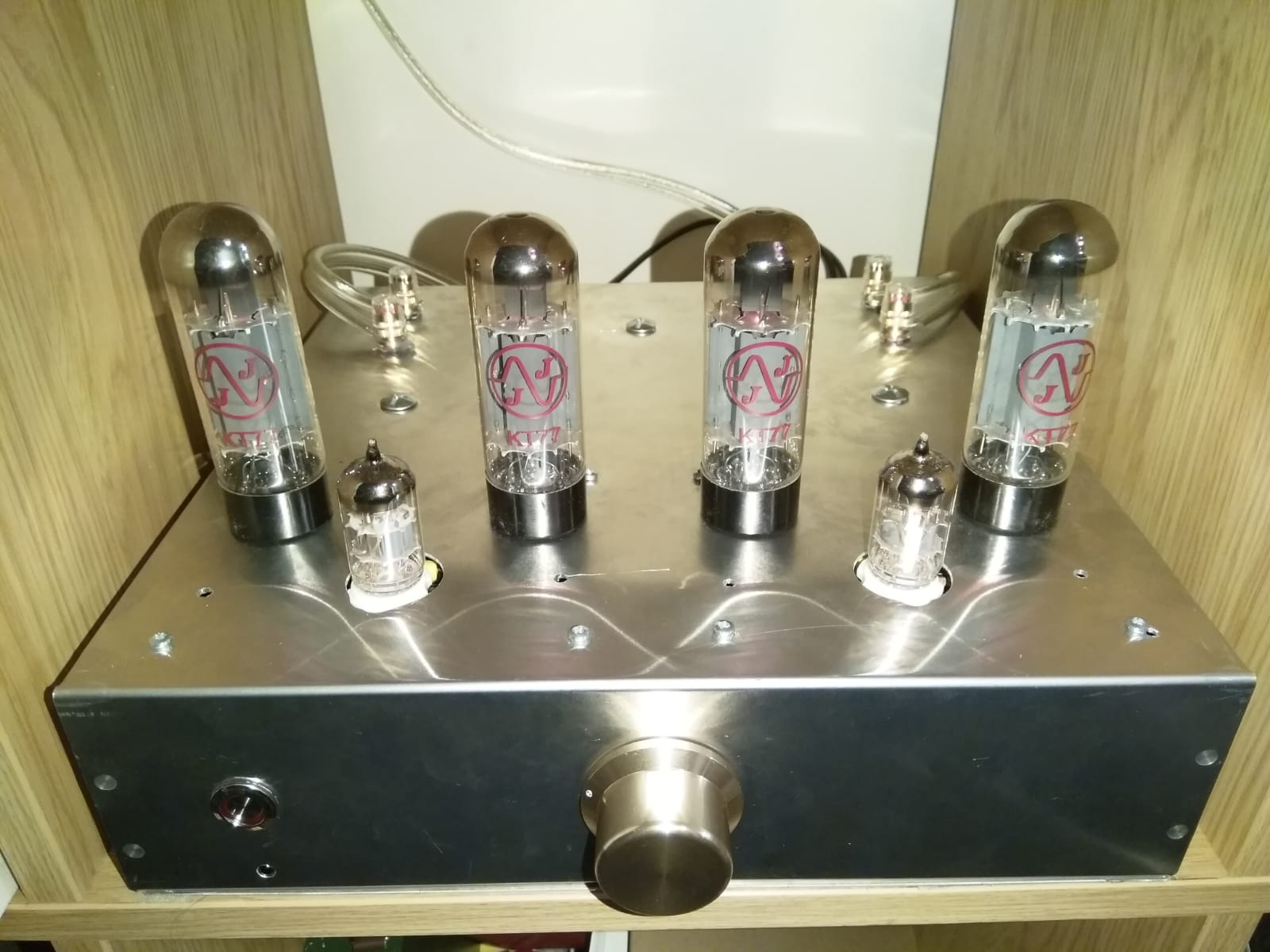

Hello! Here is my build, I have been enjoying lovely sound for some time now! Thanks a lot again Bandol, Prasi and everyone who has contributed to this amp.

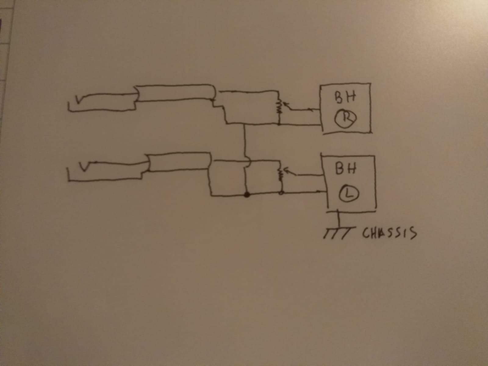

I have a small issue with buzzing from only one channel, when the volume potentiometer is in the middle. The buzzing goes away when the volume is set very high or very low. Today I rewired all the signal path with shielded wire, trying to avoid any ground loops. It reduced overall hiss (or it might just be my mind after two hours messing with it), but it did nothing for the buzzing. I have also twisted all ac cables, and have soldered the heater wires directly under the sockets.
I have attached a drawing of my grounding, the buzzing channel is the R. Before changing to shielded, the R channel was also directly grounded to the chassis. The chassis is on another point connected to the mains earth.
The input connectors are also isolated from the chassis.
I would really appreciate any pointers on what to check!

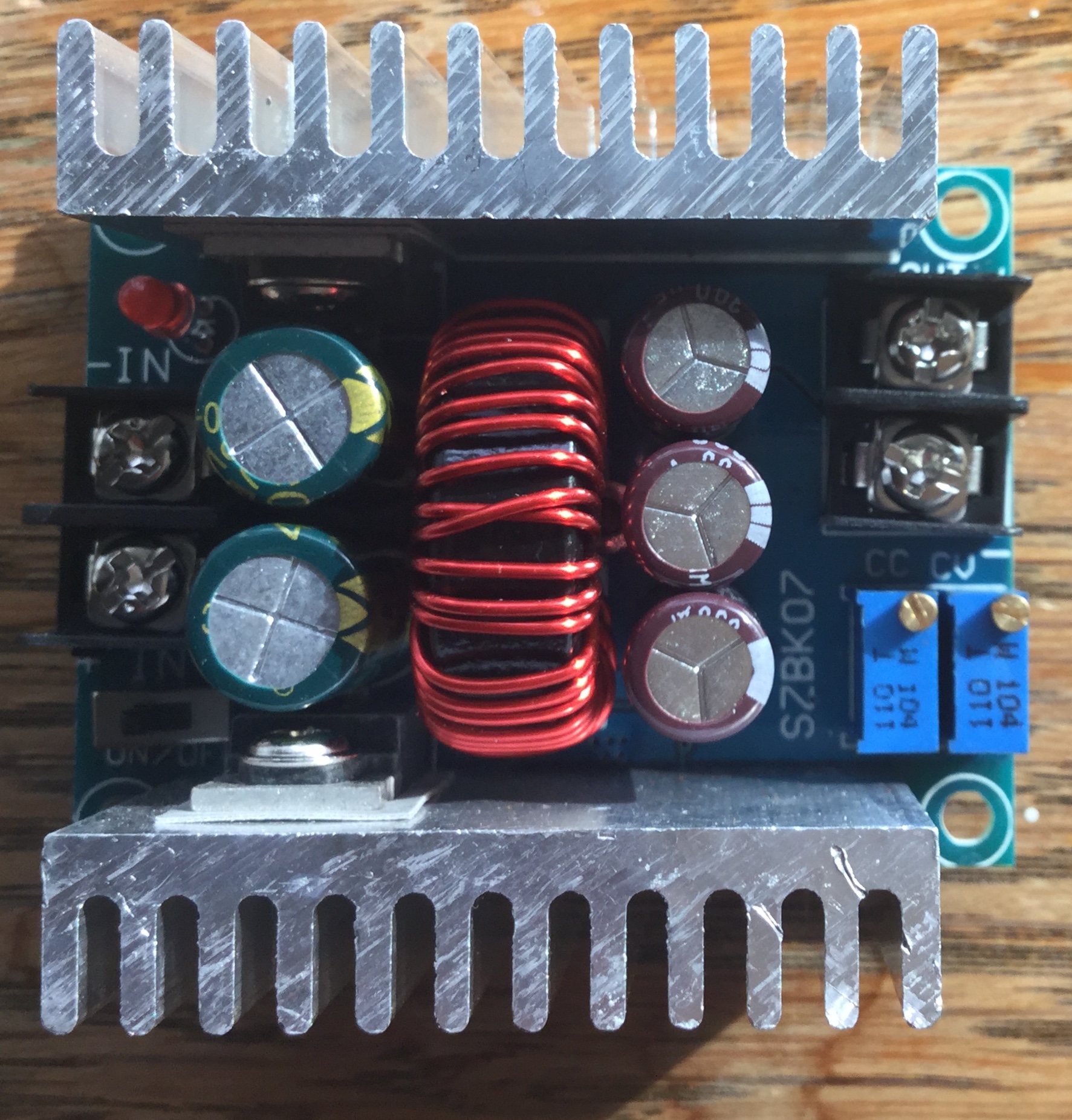

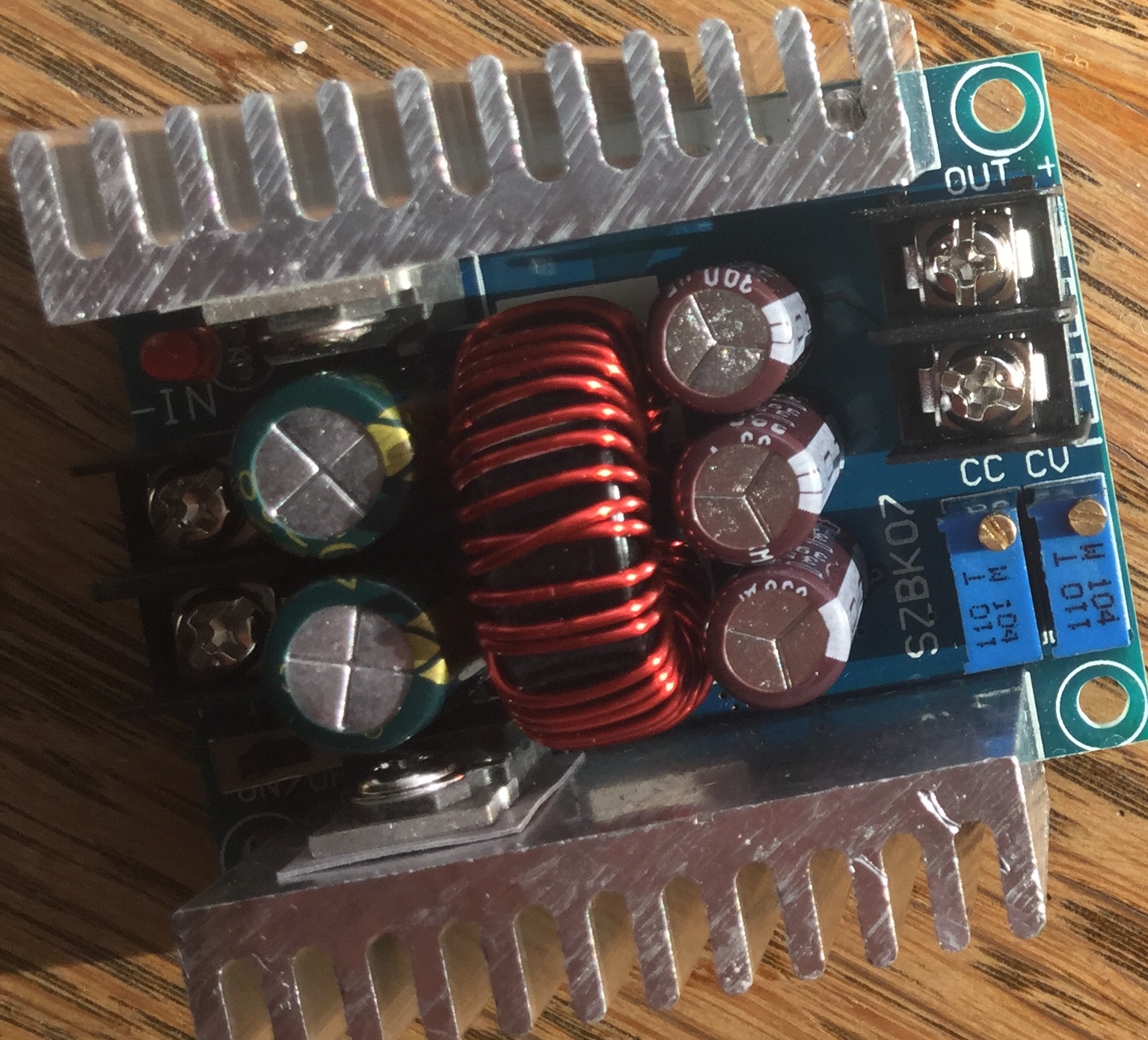

I have a bit of difficulty understanding the buck DC-DC supplies recommended. I bought some and received them without circuit or hook-up details. Could someone here enlighten me, please. What are the two adjusment pots needed for, shown on the right -one obviously output VDC, but the other?. How to hook up. Input is clear, but is it AC, or DC.
Pictures below:
Let me clarify my question. I believe the inputs are DCV between 6-30 and output between 6 and 24 DC, at upto 15 amps . Is this correct? What are the two different adjustments for?

DC input is required. One pot ("CV") adjusts the output voltage, the other ("CC") adjusts output current. In practice you initially adjust the CC pot to the maximum current so it doesn't limit anything, then adjust the CV pot to get the voltage you want. Then with your normal expected load connected you can wind back the CC pot until the voltage just starts dropping (i.e. current limiting is overriding the voltage setpoint). Then wind the CC pot forward a turn or so. When turning on with cold heaters, the current will initially be limited and you get a slow rise in heater voltage. Once they are warmed up the voltage limit takes over.

I shall, as I imagine others would, appreciate practical limits on these devices from empirical data. Does 3(?)-24 VDC outputs hold accross inputs of 6-30 VDC for the specified output for 20amp x output volts?
I haven't really experimented much with it. I bought a "DC 300W 20A CC CV" buck converter. I'm using a surplus 24V AC 50VA transformer rectified to 33V DC then dropping to 6.3V DC @ 4 amp load. Its a big voltage drop so efficiency not great, but heatsinks and inductor are barely warm. I bought the higher current module because I'm dubious about the advertised ratings.
Thanks for sharing you experience Mr. Tikiroo. This was very helpful. I believe the efficiecy of the conversion is >90%, so you are not loosing much energy in your conversion as evidenced by the cool heatsinks and inductor.
