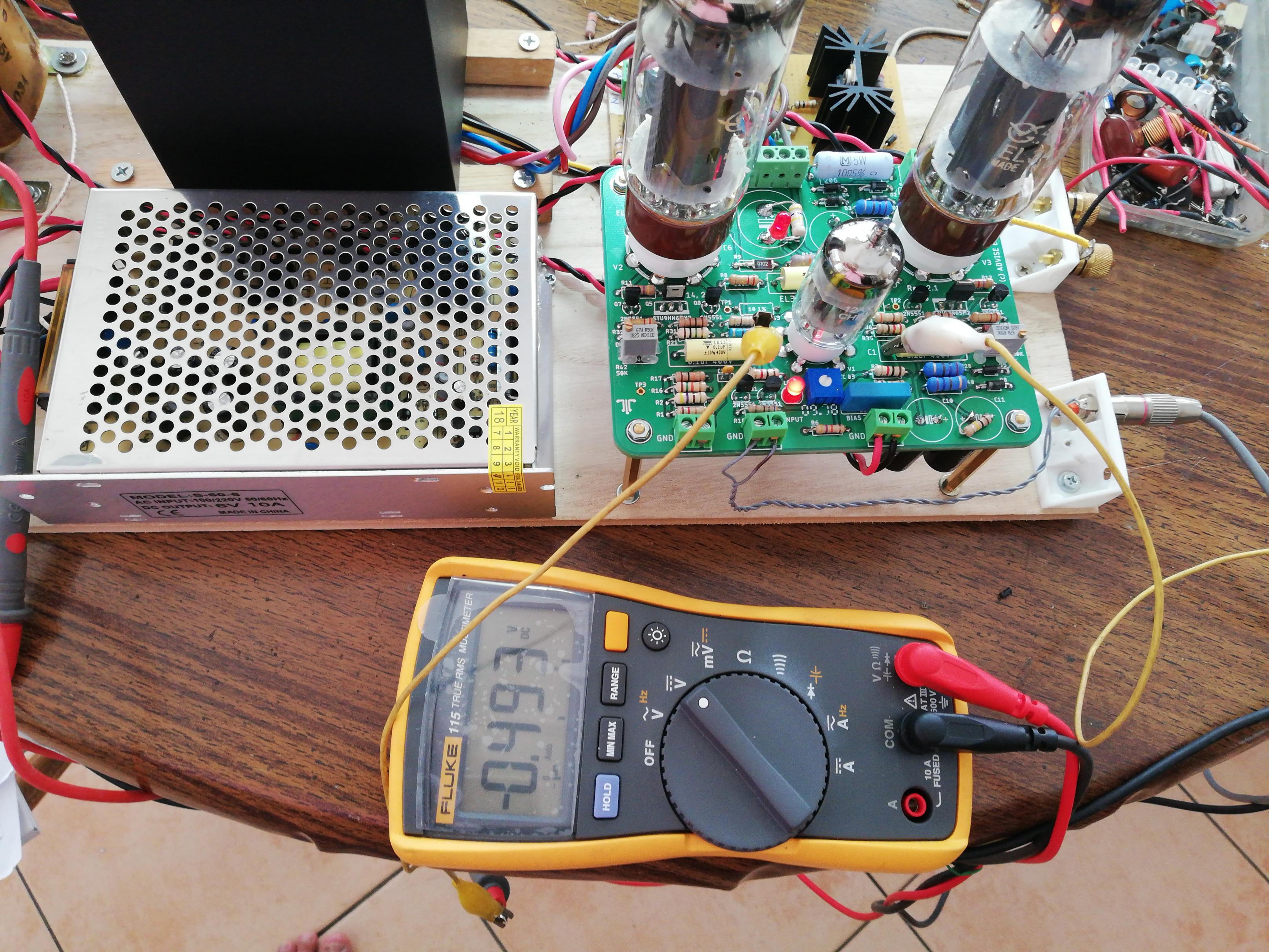

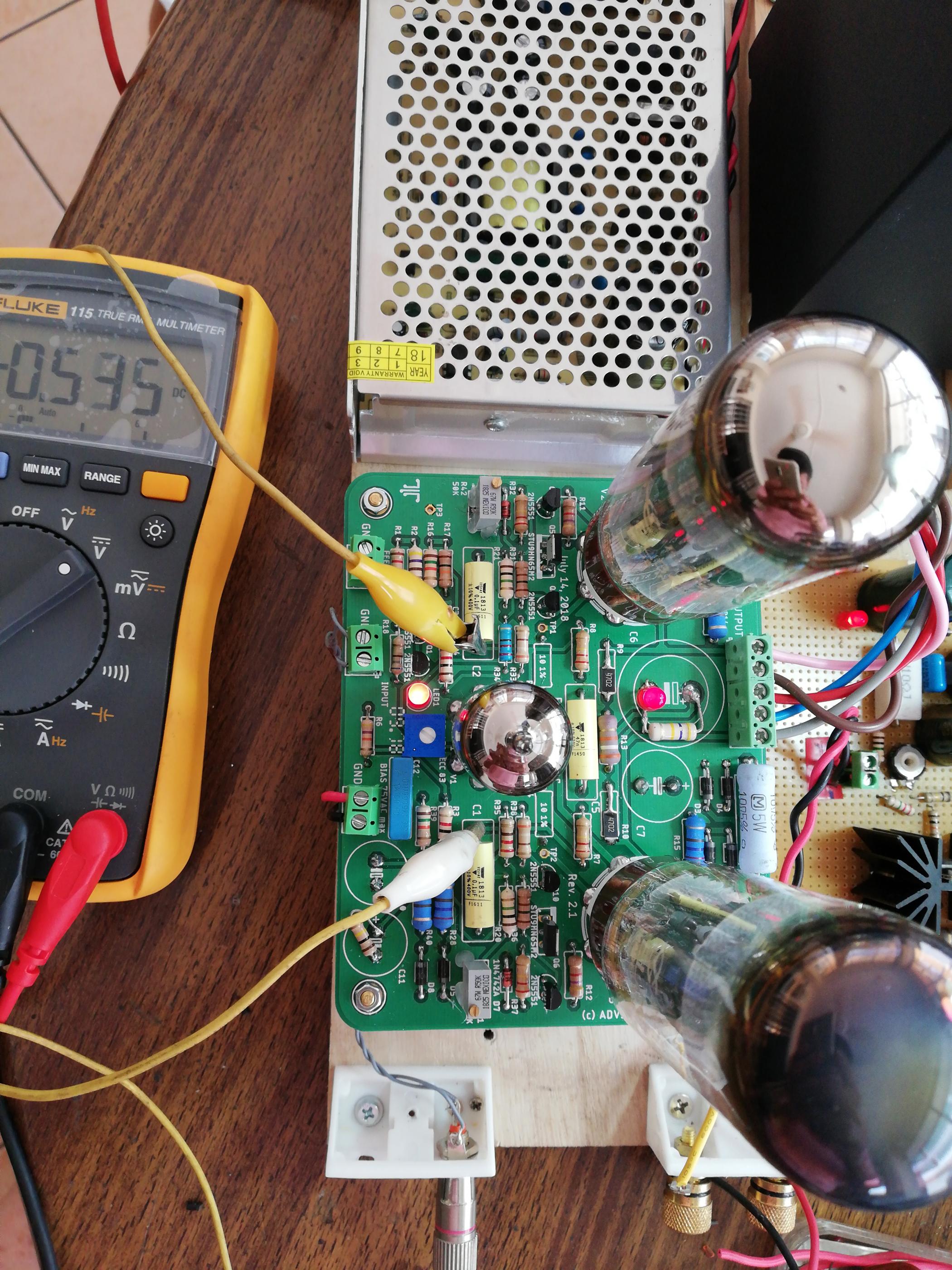

I have difficulty to have a stable 0 v dc between VC1 and VC2. The voltage varies between 30 mv to 450 mv. The voltage at C1 and C2 is only 114 to 115 v dc Look for assistance. Input B is 355v dc. Bias input is 55 v ac. I have set the Ia of the el34 at 50 ma.
Don't worry, less than 1 V is totally acceptable 🙂
For the plates, 115 V, it's a little bit low, I would recommend to increase R18 to 1k as suggested by Bfpca few posts ago, you should have about 150 V 😎

Coincidences can sometimes surprise you. I just brought up the second channel of my BH last night and guess what, I had he same issue as you have. I traced it to the fact that I had not installed the 47.5 k input resistor to ground. Without a DC reference the tube won’t operate properly. Check the resistance from the grids of both input stage triodes to ground. I hope this solves your problem.
Yes, this is exactly the same issue as mine..
I do have R6= 47K installed, following the schematic across Input 1 and input 2. After you findings above, i traced the pad and I discover Input 1 is not connected to R3. I need to jumper the pads.
Instead of jumpering, I wire up a 100K pot, and ignore R6. Now I can balance the voltage of Vc1 and Vc2
Thanks for all the help!
BUT, now V1 plate voltage of one board is 90V and the other is 120V (Both R18 is 680 Ohm- yes, I revert back following the schematic. I will install a trimmer in place of R18 and find a sweet spot. I assume Vc1 should be between 150~200

I change R18 to 1K and the voltage at c1 and c2 measure 180 v dc.
The 300V ac input from the transformer drop to 275 on load.
Is this acceptable ?
it sounds pretty good playing through my test speakers .

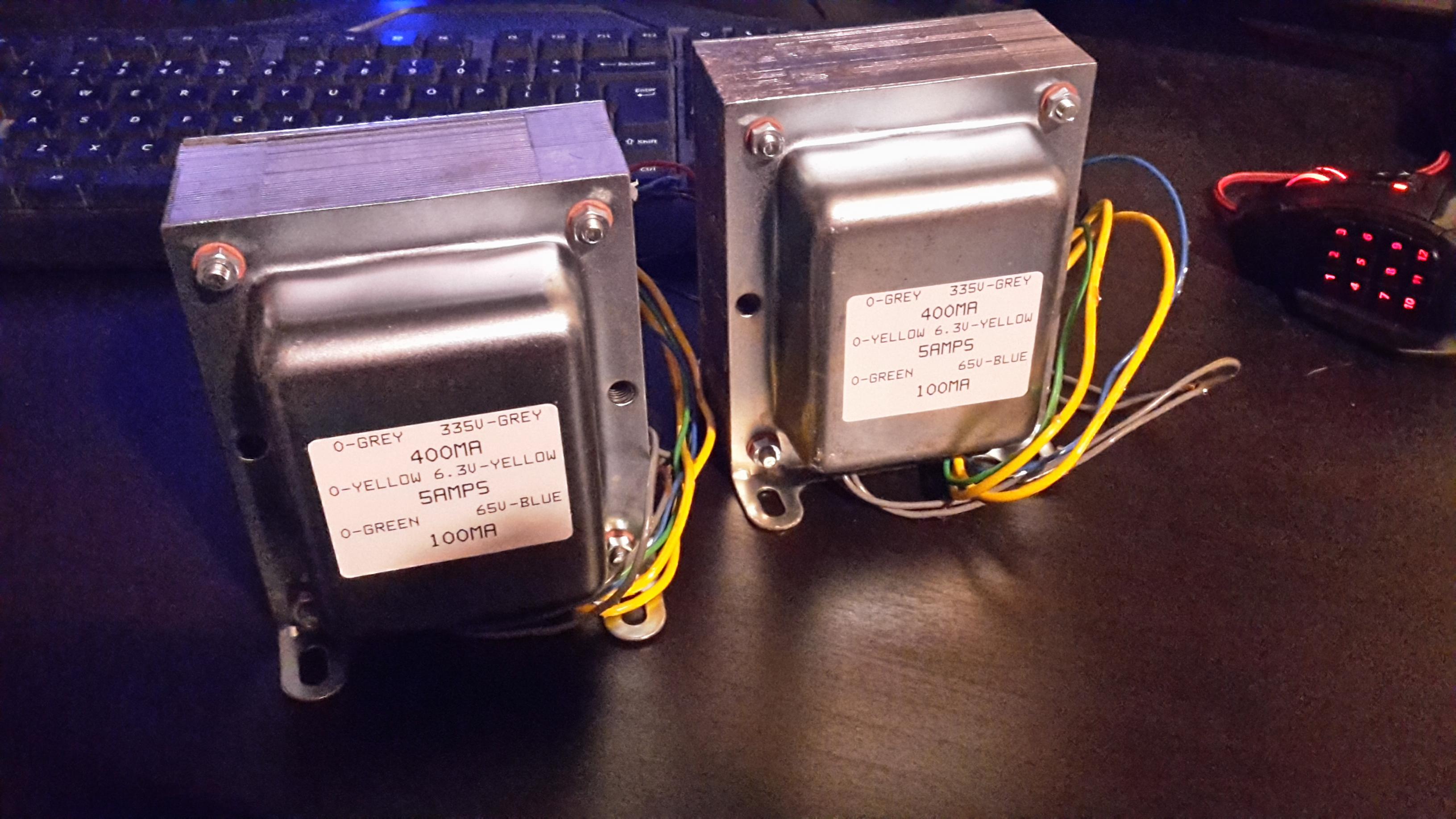

The transformer is locally wound and I specified 300v ac output with 200 ma for mono side.
180V is good.
Higher triode idle current means more voltage drop across the 220K anode loads and so lower anode voltages.
The higher current also means higher grid current (grid current proportional to anode current).
Grid current (NEGATIVE Grid Current, that is current flowing out of the grid) develops a voltage across the grid leak resistors which subtracts from the bias. For good balance between the triodes you want:
- The grid leak resistances on the 2 triodes to be near equal
- The grid leak resistances to be relative low in resistance value (so the grid current does not develop significant bias voltage disturbances)
- Low grid current which infers low anode current

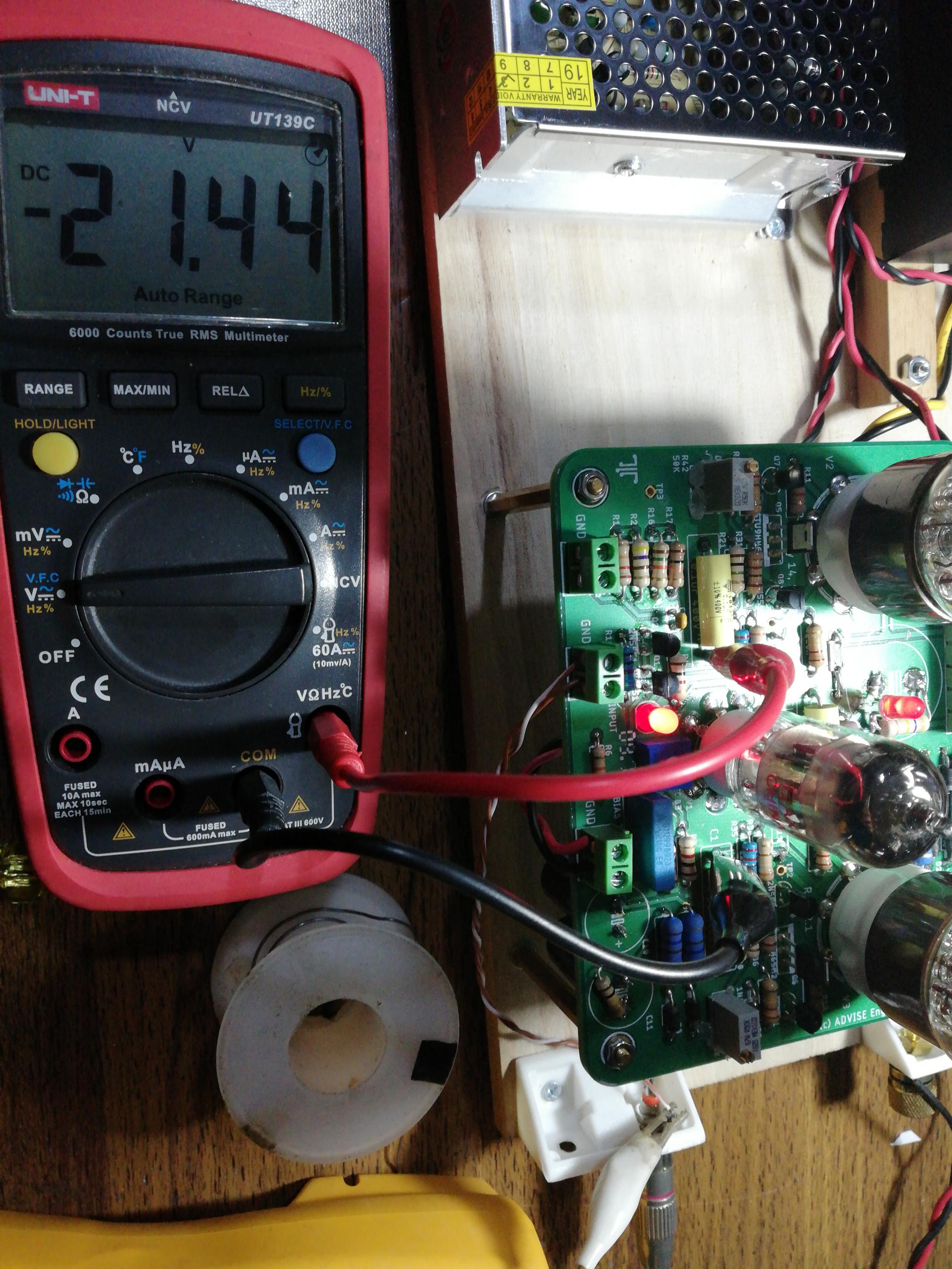

C1 measure only 20v and C1 measure 0.7 v dc

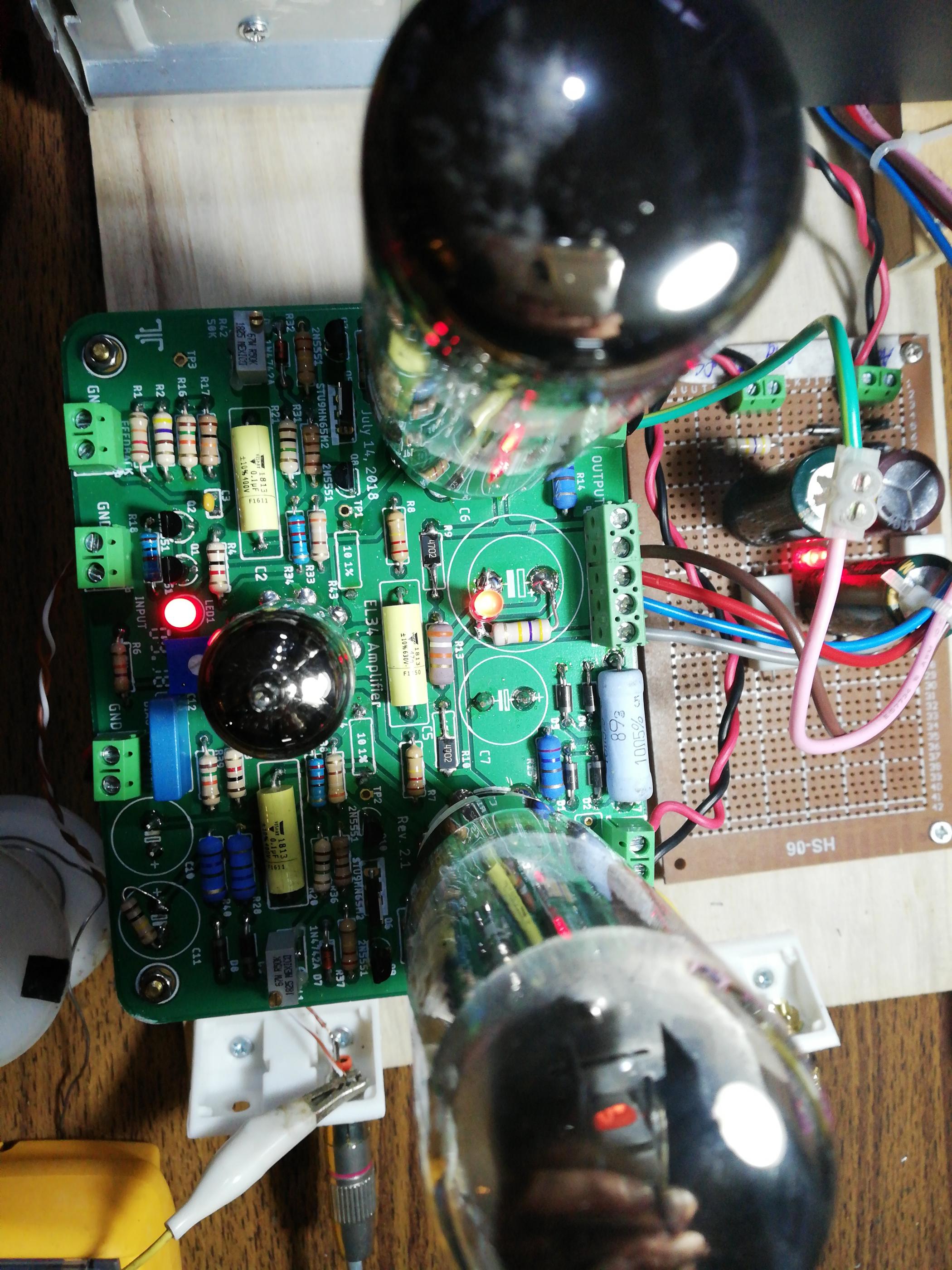

My second channel has a short from output 1 to ground and there is a burnt pcb at the site..
I cut the trace from anode of V2 and connect the output 1 directly from anode pin socket.
Manage to power up last and test for about 30 minutes.
On powering up again, the voltage at c2 onkt 0.7v dc and at c1 only about 20 v.
Tp1 and TP2 measure about 450mv
Please advice.

I measure resistance of R7 to R10. These are ok
I also nnoted that on powering up initially, the voltage between C1 and C2 is about 160v dc initially. These drop to about 20 v dc and stays there and minimally affected by R42 trimmer
Noticed that the voltage across R10 measure 4v and 365V dc with reference to ground. I am going to replace R10 and R9 and check.
across R9 i measure 351v and 147 v.
Voltage across R18 measure 1.2 v.
i measure 348v at pin3 of V2 and V3.
Any other pats that i need to check and or replace ?
