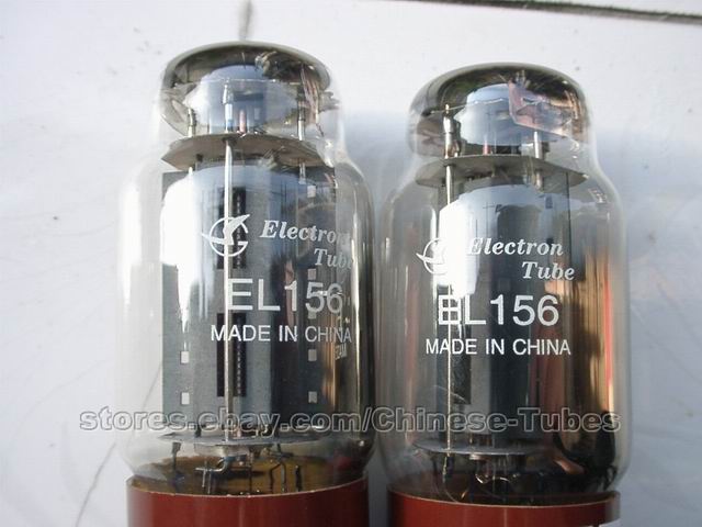

I was looking around the other day and noticed that chinese EL156B is recommended for 600V anode / 350V G2 by Shunguang. So it is in alignment with the earlier comments here.
They still look cool, if you want to avoid top caps. Oh well...
An Tube such mentioned before is not a real EL156.
A real EL156..
..has a steel socket , the first digit in the european tube nomenclatur give information about the socket 1 = steel socket, 3 = octal socket 5 = magnoval and so on...
..withstands 800V plate voltage.Refer to the original Tfk data sheet:
http://www.mif.pg.gda.pl/homepages/frank/sheets/128/e/EL156.pdf
..are able to turn 45W plate power into heat.
And finally , these fine tube is one of the made-to-last high reliable output tube in the world. The original Tfk has a specified mtbf of abt. 10000 operating hours. I own some of them which have already a runtime of 15000hrs on the clock and all their parameters are still in specs. What a tube!!
73
Wolfgang
So the china fire cracker may be what else but not an EL156.
A real EL156..
So they put a socket on it that people actually use.
The aim is to sell them. Since the vast majority of pentode amps out there have international octal sockets, I consider that a smart move.

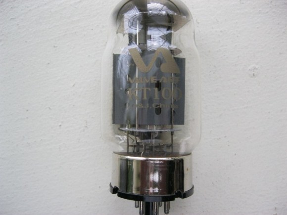

Long time ago (end of the '90s I guess) I compared my high power octal based valves in the amp I used at that time. Turn up the current until there is a faint red glow on the anode in a dark room. Worst were the Russian 6550's/KT88's: more than 25W and most of them would be red. The Chinese ones arrived till 28-30W. My vintage RCA (Tung-Sol) 6550's came close to 35W, but slightly red still. These are not anode dissipations, but anode + g2.
The Valve Art KT100 (octal-EL156) I could NOT get to glow. My amp didn't give me more than about 100mA each @ 480V (PP-UL). Not bad.
In this specific amp, I found the sound more triode like than my reference, the RCA/TS 6550.

The Valve Art KT100 (octal-EL156)...
So you're saying the KT100 and the octal EL156 are the same tubes? Sorry, I can't follow you!
Best regards!
Best regards!
Nope... Not the same tube...
