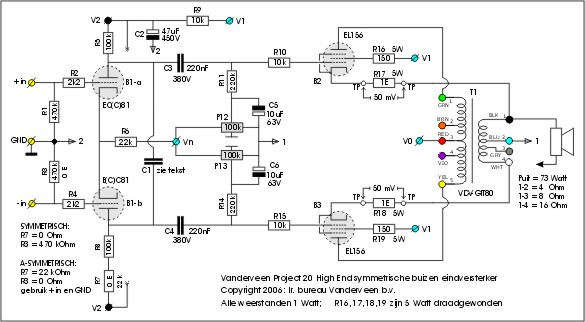

Just received 10 X EL156 from China well packed, but 4 tubes did not light up, one had shorts, one barely moved the meters on the Avo. 4 worked but nowhere near specs.
I tried 6146 as triodes; take a look at the data you need enormous drive.
I don’t understand why you would use screen drive when you could use 811A’s or 572B’s that give the same result? What’s the advantage of using Screen drive? I have seen 807’s using screen drive giving over 100 watts.

There are two different things here which can be used together or independently.
Screen drive applies all of the drive signal to the screen grid while the control grid is held at a fixed potential, often ground. The main advantage here is overall efficiency. The tubes can be run near TRUE class B with idle currents in the single digit milliamp range while avoiding crossover distortion. I have seen plate efficiencies approaching 80%. The disadvantages are high drive requirements, and the possibility of screen grid damage in amps that extract maximum output power from the tubes for long periods of time. A cranked guitar amp for example. This works best with horizontal (line) sweep tubes, since they were designed to be controlled by the screen and switched on and off by the control grid. Conventional audio tubes that were designed to work with high voltage on the screen are poor candidates for screen drive.
Power grid drive applies all of the drive signal to the control grid in the usual fashion, but a cathode follower or mosfet follower is feeding the grid directly allowing for positive grid operation without distortion or blocking. It is not often realized that the driver tube is responsible for a considerable fraction of an amplifiers distortion due to the non infinite input impedance of the output tube even in the negative grid region. Blocking distortion and bias shift is another distortion mechanism that occurs in all capacitor coupled output stages. A power grid driver eliminates all of these distortion sources. Many tubes can be operated well into the positive grid region without distortion if the driver is correctly designed to source the grid current. Often considerable power output gains can be found by employin A2 or AB2 operation. Many tubes are suitable for power grid drive, but not all will respond with additional output power. Most tubes will respond with lower distortion and much improved transient handling clarity and dynamics.
It is possible to apply signal to both G1 and G2 simultaneously. Simply tying the two grids together in a beam pentide like the 6L6GC will result in a tube that acts much like an 811A. The Mu is very high, but so is the plate resistance. It is possible to scale the drive and DC voltage on each grid to capture the advantages of each drive method without excessively high Rp. These methods have been explored in this forum, and I have built a couple of amp prototypes with "dual drive".

I think we should first mention there are different criteria in amplifiers depending upon the application, i.e. home and guitar. I will be addressing the post in regards to home application.
A couple of thoughts. The first is that efficiency is fine for guitars, PAs etc, but fidelity is lost in high end equipment due to increased number of stages and parts. It is very difficult to design a stage that is perfect, virtually none has occurred.
Secondly, Class B and B2 operation has increased distortion vs AB or A operation, (including higher orders). At lower output power (signal), the tube's transfer function becomes more nonlinear.
Thirdly, using SS emitter followers etc to drive a screen (even more so grid) is problematic due to bleedthru. Even a 1N4148 diode with 1pf junction capacitance, reversed biased, has problems.
Yes, it sounds good on paper, but let's check closer.
Agreed as you mention, the no. 1 grid's input impedance changes quite drastically between negative and positive. A couple of comments (home use).
1) Bleed through problem through the driver stage itself, whether tube or SS.
Especially with tube, a kink is developed unless a very low "swamping" resistor is used. This requires alot of power and even then, a small kink still exists.
2) Another stage is added to the problem of frequency dependent feedback, from stage to stage, through the power supply itself. A decoupling capacitor is not enough.
3) One must be careful of parasitics.
4) A very well regulated power supply is needed.
5) As mentioned in the RCA Radiotron Designers Handbook, 26 engineers, page 587, 1960:
Class B2 amplifiers have inherently high odd harmonic distortion, even when the utmost care is taken in design and adjustment. This distortion frequently has a maximum value at quite a low power output, making this type of amplifier unsuitable for many applications.
The driver output Z must be as low as possible (page 591). I should also add that the current available should be multiple times that of the grid current. Class B and B2 may be good for speech, guitar, but for high fidelity, certainly not the most desired.
Changing the Rp changes the output impedance (Z) of the amplifier, thus the damping factor. I can only speak for home systems; this can be important as the damping factor affects not only the woofer, but midrange and tweeter.
Another consideration is the value grid resistor used as it can affect the high frequencies.
As one can see, there are different criteria in amplifiers depending upon the application, home vs other such as guitar.
Finally, if clipping is a problem, then one either needs a larger amplifier or reduce the spl. Sacrificing musical quality just does not appeal to me.
Cheers and all the best.
