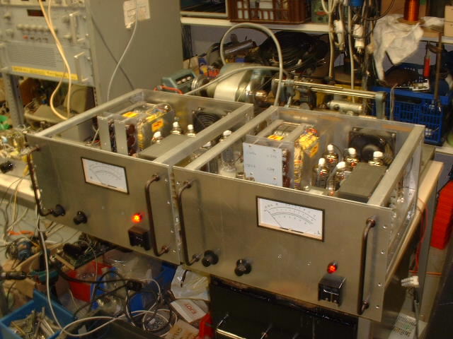

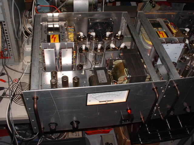

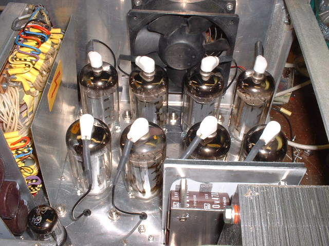

Hi Paul,
there are lot of power transmitting/ radar modulator valves around. I live in north germany, and here at local radio rallies , some odds are selling such valves regulary for reasonable prices. Also accessories like top cap clamps and sockets.
I had just finished this project. I build two mono power amps, clones of the McIntosh MC-3500. They employ 8 pcs 6P45S line output valves , the russian counterpart of a EL519. The output power is 350W rms. See the attached pics. You will find more in the MC-3500 thread here at diyaudio. Link to the thread:
http://www.diyaudio.com/forums/tubes-valves/139241-mcintosh-mc-3500-schematic-information.html
But one day I will make a beast like this:
EL6471 1kW Großverstärker (Type 102408)
Real amps have top caps!:D
Real amps are glowing in the dark!:D
Real amps need 3 phase power!:D
73
Wolfgang

Looks excellent; well done.

Funker,
I read your MC3500 thread; I am very, very impressed by your work.
Paul
Hi Paul,
thank you very much. It took 3 years from planning until the finish. Even the the opts took a week to turn them.
And I´m proud of the result :)
They sound marvellous, it is like if the band play live in my home. You will hear music, not a speaker or an amp, just music.
But they are not energy saver.:( 800W at idle , 2kW at full blast.
(I got last week my annual electricity bill. :( )
73
Wolfgang
