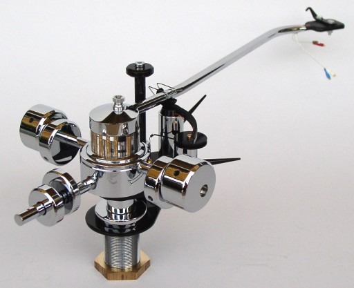

For those who do not know what the arm looks like:
The extra lateral mass is 190 gram. The entire arm, with all weights, weighs 860 gram.

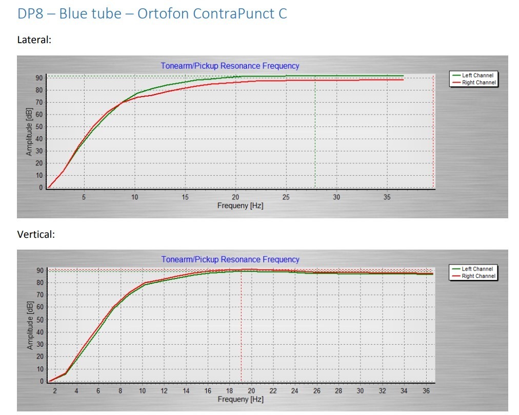

I can't make a judgment about the tonearm's resonant frequency based on what you are saying. I can only know its resonant frequency based on the measurements. The following charts are provided by the maker himself. Can you see the 16 Hz vertical resonant frequency and lateral frequency?The DP-8 is simly an arm with different effective mass in the vertical and lateral dimensions. It does so by heavy mass very close to the pivot point for vertical motion and a heavy lateral mass as well. So resonance may well be 16 Hz vertically while being much lower horizontally. This follows the music info in LPs (mono bass etc) and the out of music error signals (0.55 Hz horizontally 4-10 Hz vertically).
The maker claimed there were no resonant frequencies for his tonearm. I am questioning such a conclusion. From the charts, I don't see any resonant frequencies. If the tonearm has no resonant frequencies, it contradicts the basic principle of tonearm design.
I know his tonearms are heavily damped by adding weights on the lateral plane. However, can damping eliminate resonant frequency completely? I don't know. Further study is needed. In theory, it can't. If there is no resonant frequency, it means the spring (the cartridge) is completely compressed. There is no springness on the cartridge. Playing back a record is not possible once the cartridge is completely compressed.
The resonant frequency in the lateral direction is not just low due to the mass but also damped. There is silicon oil to damp lateral movement. Damping can diminish the peak as seen with the infamous Shure V15 damping brush. This is the behaviour of mine in the vertical direction with and with brush engaged.
Well...if the 190g of extra lateral mass is due to the side weights, then...@borchee: the side weights do affect tracking force (but, being so close to the fulcrum of the arm, have next to no influence on effective mass)
Guesstimating...mass center of the weights at the outer position is 45mm from the pivot. The effective length of the 12" arm is 307,4mm.
So, the effective mass of the side weights is: 190g x (45mm)^2 / (307,4mm)^2 = 4,07g.
It gets better...for the 9" arm with an effective length of 230mm, the side weights contribute 7,27g.

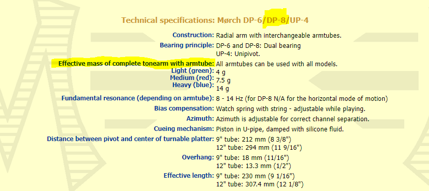

For example...Mørch specifies the effective mass of a complete (sans headshell, cartridge, screws...) DP-8 arm with the light (green) tube at 4g.With which length, 9 or 12"?! And at what position of the side weights?!
My calculation is correct, yet the results (can) exceed the stated effective mass.

As you know the horizontal excitation forces consists of the 0.55 Hz wow which can also manifest in 1.1 Hz overtones, but not much higher. As for the music, most bass content is mixed into mono. So any horizontal resonance frequency should be placed above the 0.55/1.1 Hz wow frequencies but below potential music content at 20 Hz. Two octaves above 1.1 Hz equals 4-5 Hz, which also is two octaves below 16-20 Hz.
The vertical excitation forces are mostly warps in the 3-6 Hz region, but warp disturbances can be seen even higher up in frequency. Placing the resonance at least 2 octaves above the 6 Hz warp frequency equals 24 Hz. Such a high vertical resonant frequency is not usually recommended, but as many know, there is no or little music information cut in the vertical mode (see above, they are most likely mono and horizontally cut). So a vertical resonant frequency of 20 Hz would effectively filter out LP "noise" while not affecting music.
This is also the idea of the DP-8 arm: iplace the vertical resonant frequency high, while still having the horisontal frequency low. In this way, you avoid warp noise while still having full level bass notes.

Whom should I believe - you or the manufacturer? No pun intended, really!Note that the effective masses were originally stated for the UP-4 and DP-6 arms which have been around for a long time. The DP-8 with its side weights is a recent arm, and the effective mass is quite different when the mass distribution of the counterweight has been so much altered.
Specs taken from: http://www.moerch.dk/spec1.htm

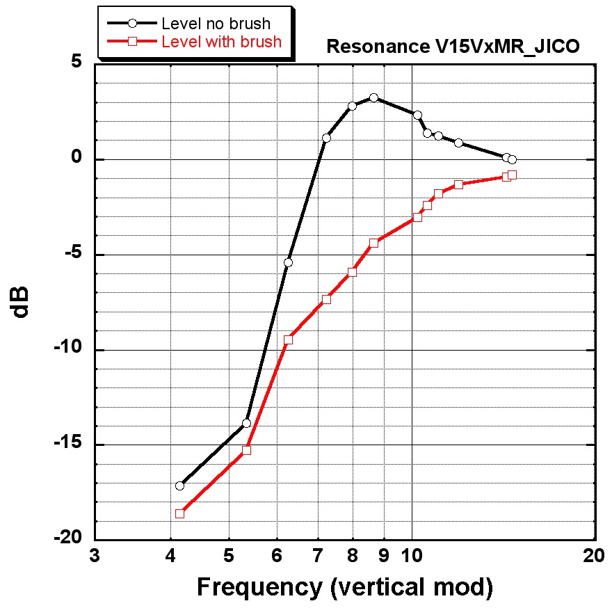

Nobody denies that damping can diminish the resonant peak. But the question is how much. In the diagram, the brush seems to eliminate the resonant peak. Can a silicone-damping device do the same? I don't think so. With the brush disengaged, the resonant frequency is there. But in Mørch’s test results without a stupid brush, the resonant frequency disappeared as well. It indicates something is wrong with his tests.The resonant frequency in the lateral direction is not just low due to the mass but also damped. There is silicon oil to damp lateral movement. Damping can diminish the peak as seen with the infamous Shure V15 damping brush. This is the behaviour of mine in the vertical direction with and with brush engaged.
