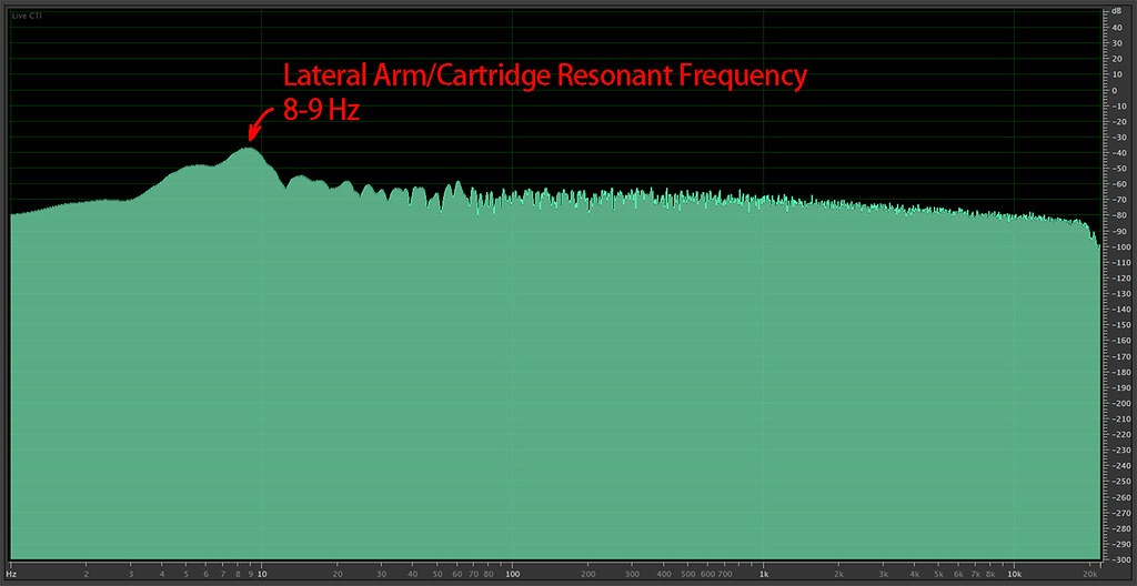

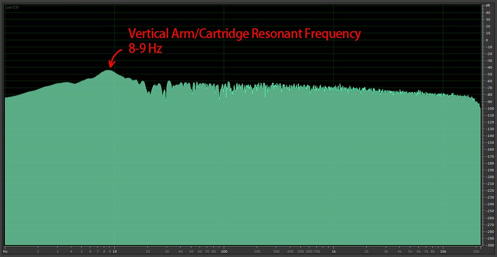

Although I have many disagreements with your reply, I will focus on the main topics.
Here are the results of my tests using two different pink noise sweeps in lateral and vertical modulations. You can see the overall frequency response, in the meantime, you can see resonant frequencies clearly.

Let's take a look at his analysis.
He did a resonant frequency test for his DP-6. He posted his results as follows.
The result is completely consistent with my tests. The resonant frequencies were about 12-13 Hz for lateral and vertical modulation with damping in both planes. By the way, I disabled the damping device when I did my resonant frequency tests.

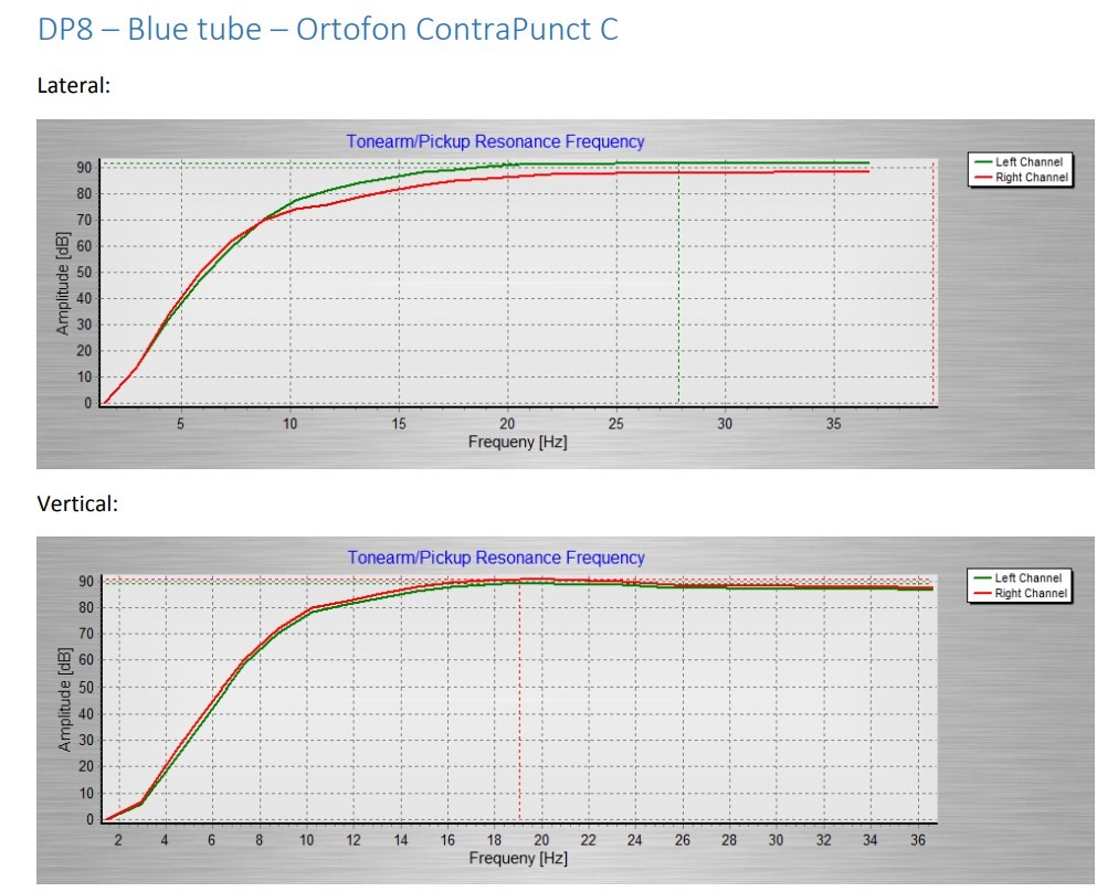

However, he switched to different software to do the same test for his DP-8.
He stated that Typical DP-8 lateral resonance. Be aware that at very low frequencies where the modulation is horizontal, there is no fundamental resonance. The amplitude just rolls off downwards.
I don't understand why he switched to different software. Isn't the method for testing DP-6 good enough? Then, he stated that there is no fundamental resonance. Why? Is it because of heavy damping on DP-8? The amplitude of the resonant frequency had been completely wiped out by the damping. I really doubt his conclusion and method. I understand that damping may reduce the amplitude of the resonant frequency. Can damping completely eliminate resonant frequency? I don't know, but his method is questionable.
Let's assume that heavy damping can eliminate resonant frequency completely. But what are the effects on playing back? In my experience, heavy damping is not desirable.
Furthermore, he thought the vertical resonant frequency was 19 Hz based on his test result. I disagree. I think there is not enough evidence to support his claim by looking at the chart generated in Adjust+.

The DP-6 measurements (made with 1970s Brüel & Kjær equipment) show Left and Right channels subsonic frequency response. They show the groove content at +45°/-45° . These frequencies reflect what an unidentified ‘typical’ cartridge picked up in 1982 when the DP-6 came on the market.
The DP-8 measurements (made with Adjust+) are of L-R (vertical) and L+R (lateral) subsonic frequency response. This reflects in-phase and out-of-phase subsonic frequency response. The Adjust+ software calculates the f-res automatically based on where the largest amplitude is located.
The two measurements show different parameters and cannot be compared.

Let's cut to the chase. I want to ask you two questions.
1. For his DP-8, he stated that there is no fundamental resonance anymore. Why? Is it because of damping? Where is the resonant frequency? We all agree that resonant frequency exists no matter what you do.
2. So, for his DP-8, its lateral resonant frequency is about 27 Hz and its vertical resonant frequency is about 19 Hz. However, the consensus for resonant frequency is ideally between 9-11 Hz. Don't you think it is problematic with such high resonant frequencies?
RE: 1.: We should probably blame that on the fact that Hans Henrik’s native language was not English or the statement was not properly proof-read. I think it should have read: ' Be aware that at very low frequencies where the modulation is horizontal, there is no fundamental resonance peak.’
I must admit that I cannot adequately explain where the f-res has disappeared to (and I cannot ask Hans Henrik who died two or three weeks ago… he was 92). But I would suggest that what we may find is that it is hiding in the area of 2-3 Hz and thus does not show up in traditional measurements. (you will not find any test records that go so low. You could try to measure those frequencies with a stationary transducer, but that then means that you are measuring the static behaviour of the system and that therefore we are back to square one). and of course, we have no way of knowing what kind of filter is applied in computer sound-cards or if the system feeds into an amplifier that follows the recommendations of the 1973 RIAA curve (6 dB/octave cut-off from 50 Hz). What is certain is that no domestic amplifier is linear down to DC.
Re: 2.: I do not understand how you arrive at 27 Hz as the lateral resonant frequency. I can see that there is a green line at that frequency, but this is an artefact of the Feickert Adjust+. As I said above it finds the frequency where there is the highest amplitude and marks that as the f-res. This works well when you have a ‘normal’ arm, but not in such a linear system as the DP-8 where the an increase in amplitude is in the region of 1-2 db.

Well, if it is not there, it means it is not there no matter how you flap your gum. Again, there is no resonant frequency in the 2-3 Hz area at all. If there is no resonant frequency, there are two possible reasons. 1) The testing method is not correct. 2) The design of the tonearm is flawed. It is as simple as that.I must admit that I cannot adequately explain where the f-res has disappeared to (and I cannot ask Hans Henrik who died two or three weeks ago… he was 92). But I would suggest that what we may find is that it is hiding in the area of 2-3 Hz and thus does not show up in traditional measurements.
As you said, Adjust+ will find the peak frequency automatically. 27 Hz is the peak frequency for the lateral resonant frequency. The amplitude of the resonant frequency is always the peak frequency because it is input signal + resonant signal=resonant frequency. So, it is always the highest amplitude.Re: 2.: I do not understand how you arrive at 27 Hz as the lateral resonant frequency. I can see that there is a green line at that frequency, but this is an artefact of the Feickert Adjust+. As I said above it finds the frequency where there is the highest amplitude and marks that as the f-res. This works well when you have a ‘normal’ arm, but not in such a linear system as the DP-8 where the an increase in amplitude is in the region of 1-2 db.
