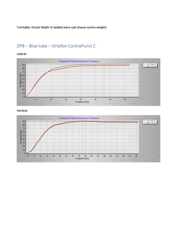

@Mark Tillotson: Indeed, the horisontal and vertical compliances are important and interact. However, all low frequencies are cut in mono (horisontally/laterally). Cutoff frequencies vary, but generally speaking, there is no stereo information below 150Hz. High lateral mass is the technical reason why air-bearing tangential arms, the Mørch DP-8 and the original Syrinx arm tend to sound very good in the low frequencies: these arms provide a steady platform for the reproduction of bass.
Ladegaard’s 1977 AES paper discusses the interaction of various resonances in the turntable system, but does not touch on the need for high lateral mass and low vertical mass. Mørch made a prototype DP-8 based on the UP-4 around that time. But 1980s bass-resolution was not sufficient to demonstrate the advantages of the design. It took another 30 years before it became evident that there was any aural advantage to the approach dictated by logic.
The measurements below with their almost linear (bass-)frequency response show the benefits of the high lateral/low vertical mass approach.
BTW: these are Mørch’s measurements of the MMC1 in the Red armtube. Note how the vertical f-res is almost 19 Hz and that the amplitude is only around 5dB.
How did this number come up? The arm's effective mass is 4 g and the cartridge's mass is 1,6 g. Because we treat the cartridge like a point-mass located at the typ of the stylus (at effective lenght), the effective mass equals the actual mass. It should be 5,6 g and not 7,5 g.The 7.5 g that I gave as effective mass is including the MMC 1.
I don't know how they concluded that the vertical resonance frequency was 19 Hz. I can't see any resonance frequency from the diagram at all. By the way, 19 Hz is too high if they are correct.BTW: these are Mørch’s measurements of the MMC1 in the Red armtube. Note how the vertical f-res is almost 19 Hz and that the amplitude is only around 5dB.
When I did resonance frequency tests, all the resonance frequencies were clearly defined.
