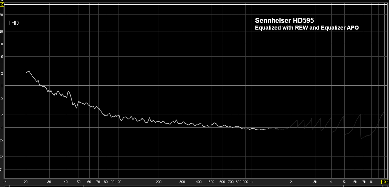

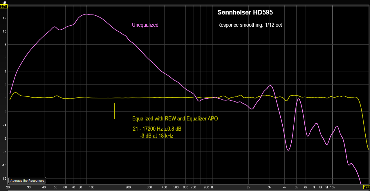

I use my Equalizer APO software to equalize system-widely not only all my loudspeaker sets, but also the headphones. In the first attachment one can compare the original and the corrected response of HD 595. 20 - 17200 Hz ± 0.8 dB is remarkable. But more remarkable is the graph of the THD of the equalized headphones. Values of 2% at 20 Hz and 0.19% at 100 Hz are "a joy for the eyes" as the Greeks say. I did not measure the SPL of these measurements, but it was quite high, within 75 - 80 dB. I used the well priced miniDSP UMIK-1 calibrated measurement microphone.

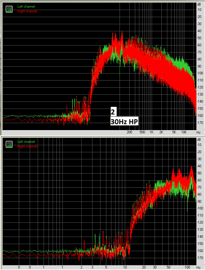

The talk started in the sub-thread related to removing the very low frequencies. So, I was thinking clearly from this point of view. For me, the modulation group 3000 ± A(k) k 0.55 Hz (where A(k) depend on the eccentricity level) consisted of the frequencies in Hz:
< etc. ... , 2998.90 , 2999.45 , 3000.00 , 3000.55 , 3001.1 , ... etc. >
where I did not see nothing else, although 0.55 Hz is a factor of the modulation.
I hope that using the higher resolution FFT you will be able to observe the effect.

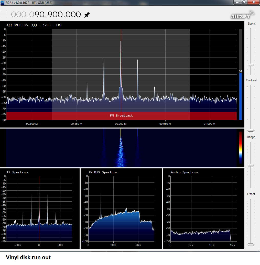

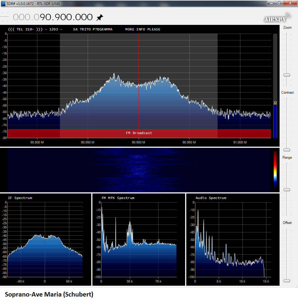

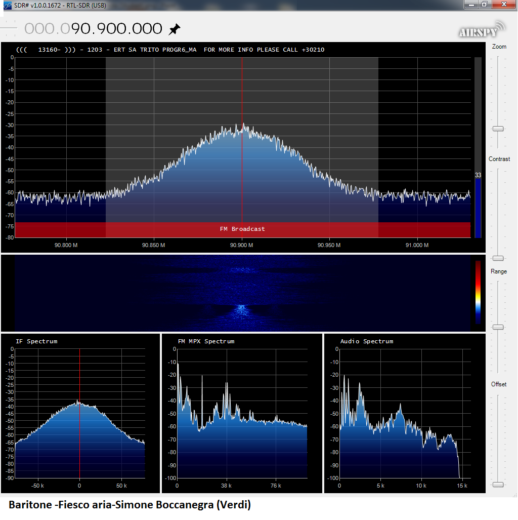

In the same sense I would usually thing of an FM signal of a 100.4 MHz station as a 100.4 MHz signal, and not as a 100.4 Hz ± all the modulated audio frequencies in a 15 kHz range (if mono).

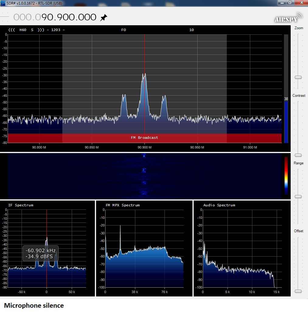

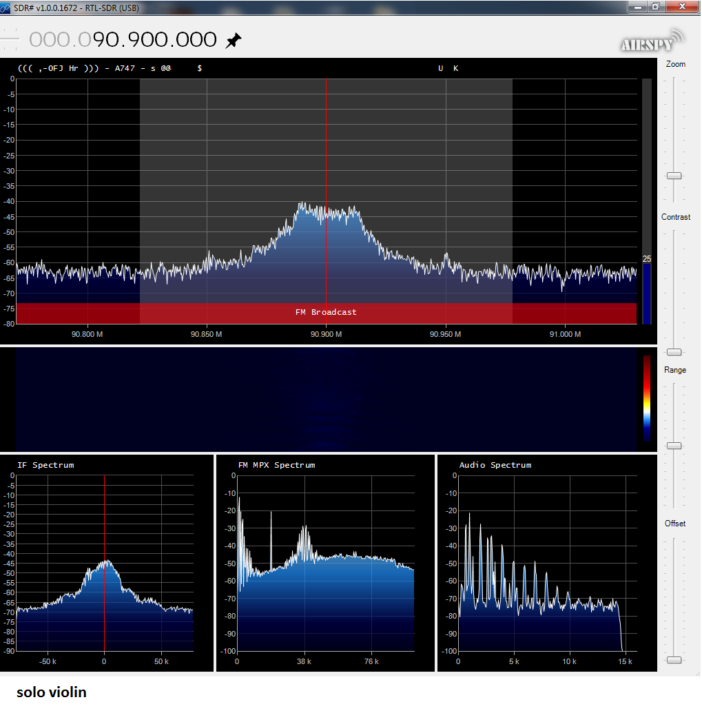

Sorry for the delay in replying to this. My SDR dongle refused to cooperate.
Here is an 90.9MHz FM station (Trito Programma) while transmitting different audio content.

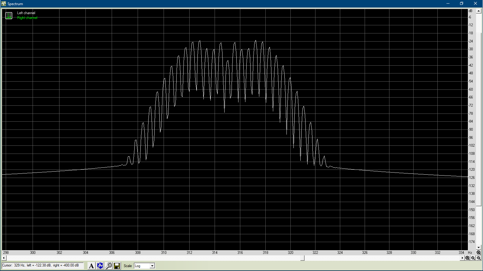

Using the AA signal generator, I created a 315 Hz signal, modulated by 0.55 Hz of 1% level ( = 331/3 LP with eccentricity of 1% ). With 1 M FFT I see exactly what I expected:
1. Instead of a sharp peak at 315 Hz, I see a region of frequencies: 306 - 324 with the intensity varying with the frequency of 0.55 Hz.
2. No trace of 0.55 Hz.
In 1. and 2. I demonstrate again my purist use of the term "frequency". A gentleman wrote me "You are not looking in the correct region". When purist, I look for 0.55 Hz where I see written, in the axis x, "0.55 Hz".
But I think the misunderstanding is over. Greetings.

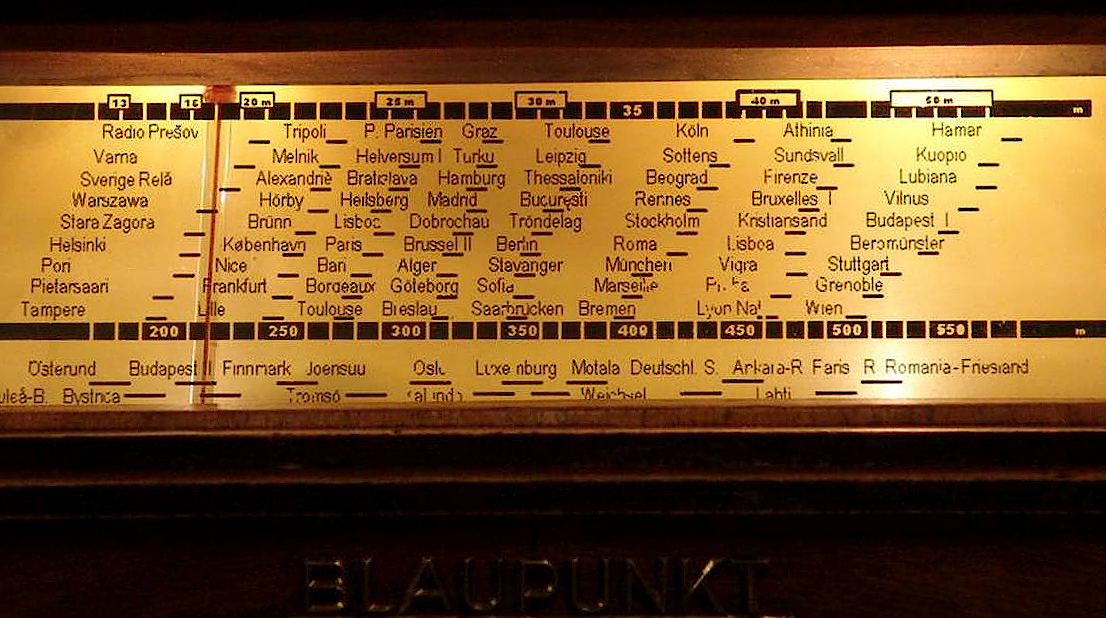

In Greece we had a lot of enthusiast's experimental FM broadcasting during the 1970ies. The first state Greek broadcasting started in Athens at 1977. I was 32 years old during this time.
The kind wish of George to remind me that period with some FM signal analysis pictures brought in my mind the earlier AM periods, when the receivers scales were informing of the radio signal 1 period 'length' instead of it's kHz or MHz frequency. I was 10 years old during the mid-fifties and I remember well those nice scales of the solid prestige and large dimensions radios, together with their convincing deep bass sound.
We had the SW bands in "meters", starting from the "13" band and ending to the "49". The frequency band of SW was (and is) roughly 6 - 23 MHz. We had the MW band of 187 - 566 meters or 0.53 - 1.6 Mhz. And we had the LW band of 1060 - 2030 meters, or 0.148 to 0.283 MHz.
I post the image of an excellent Blaupunkt scale of that time, with the nice tilted list of station names - an unforgetable romantic feature. Yes, the green "magic eye" correct adjustment indicator is not here, to complete the Bluepoint romantic memory.. I see an "Athinia" label near 500 m and a "Thessaloniki" label near 375 m. I presume that this is the same frequency of that powerful "Voice of America transmitted from Thessaloniki", which was well received over a wide region of East-South Europe.

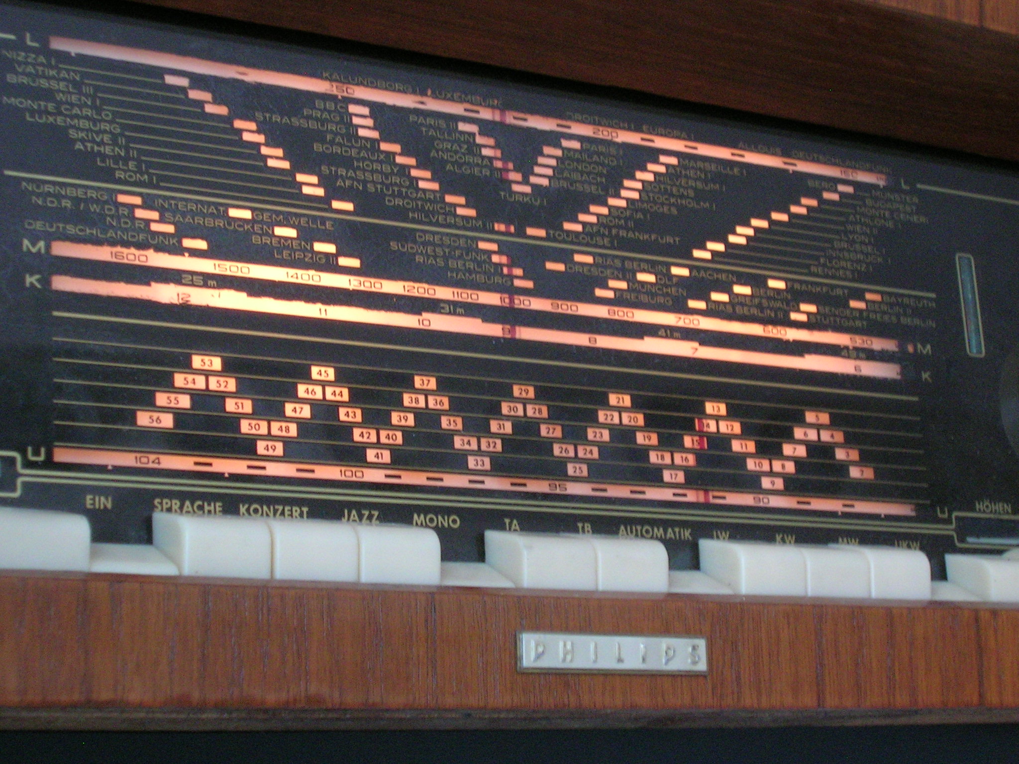

Old radios are still with us, part of everyday life

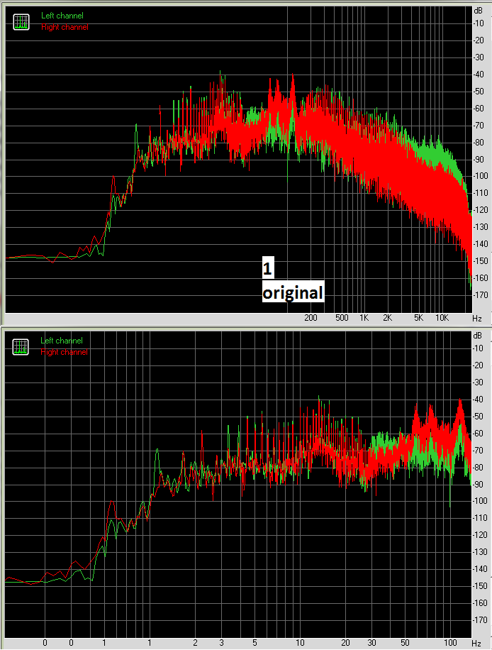

Joined 2019

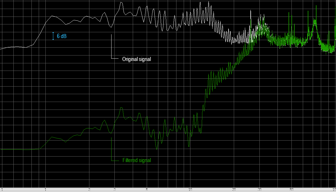

To gpapag
Here is the high FFT analysis of my measuring disk un-modulated groove noise. The original noise and the 30 Hz filtered one.
Meanwhile, I thing to try an inverse modulation of my clear 315 Hz modulated signal. I expect to see a restored 315 Hz, without any 0.55 Hz lace. Just for fun..

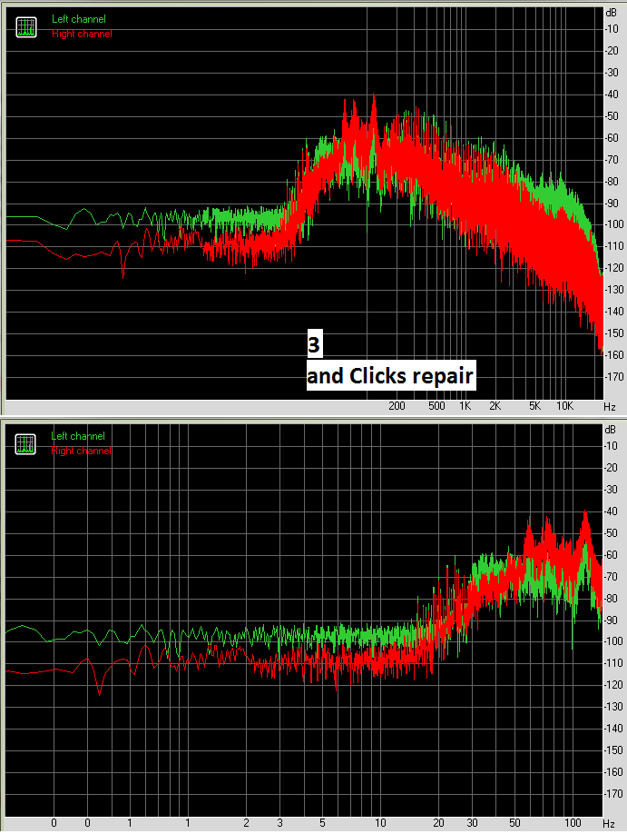

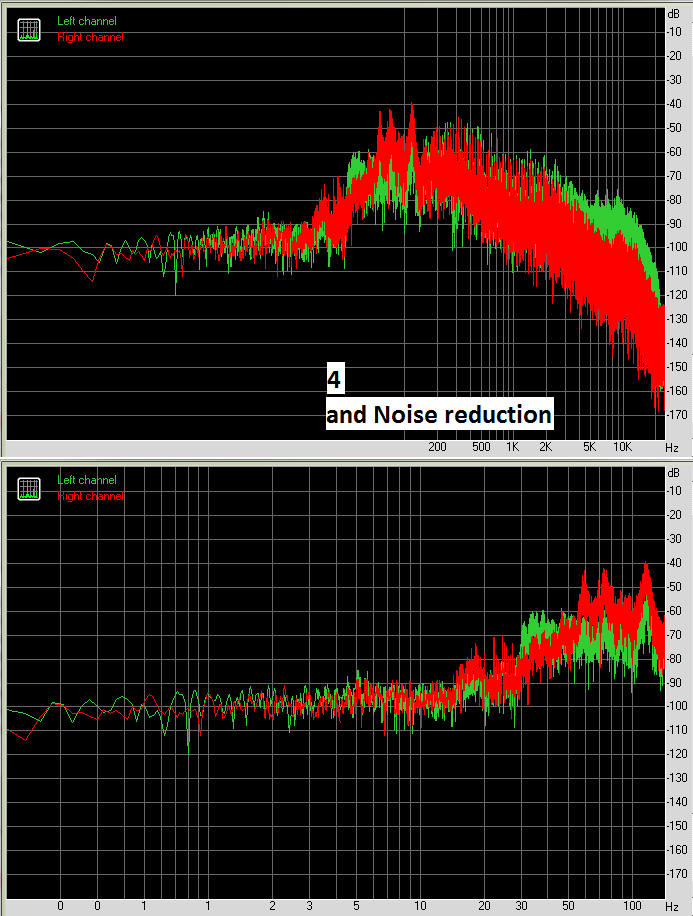

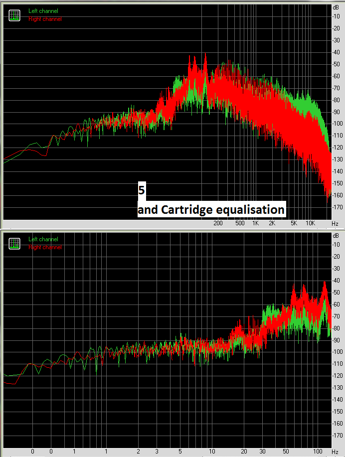

Editing of digitized vinyl music - Pros and Cons
These are the main editable / correctable types of added sounds. We can mention also some additions that can not be corrected digitally:
a. The wow caused by the eccentricity of the disk grooves with respect to the axis of rotation. This can be minimized by careful disk centering.
b. The harmonic distortion components added by the cartridge. Not editable digitally. The only cure is a higher quality cartridge.
c. The harmonic distortion added by incorrect tracking geometry (tonearm length, tracking angles). Not editable digitally, but minimizable through careful tonearm/cartridge adjustments.
After listing of all the above negative addons, I will discuss in more details the editable ones and the methods of editing. I think to do it post-by-post and with no hurry .. 🙂
Meanwhile, please feel free to add any note / opinion / comment, not necessarily related to what I have posted.
Thank you.
