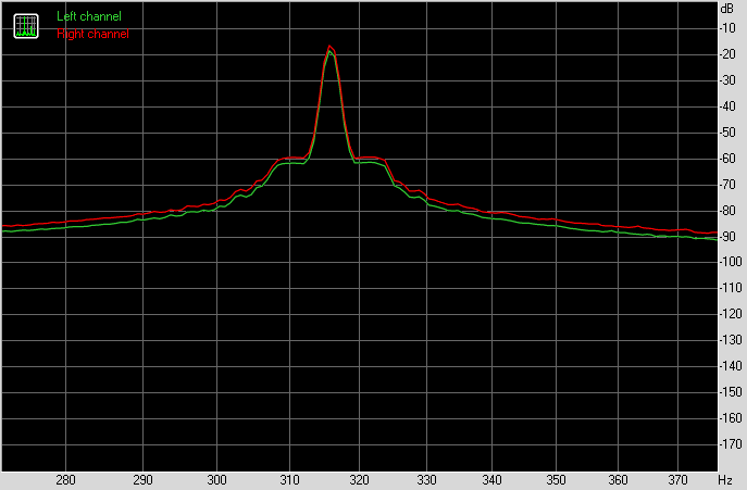

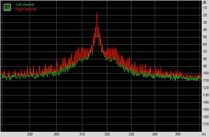

A question:
If I knock every 1 second on the table and record the sound, may I expect to find a peak of 1 Hz in the frequency analysis of my recording?😱
If you use a high resolution FFT, yes, you may expect to find the 1Hz peak everywhere.
Like the 0.55Hz from the large eccentricity on this test LP (Test track 315Hz 12dBu lateral. FFT size 1M)

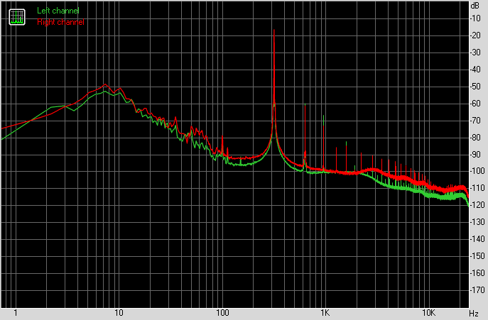

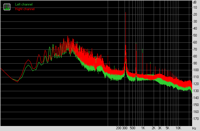

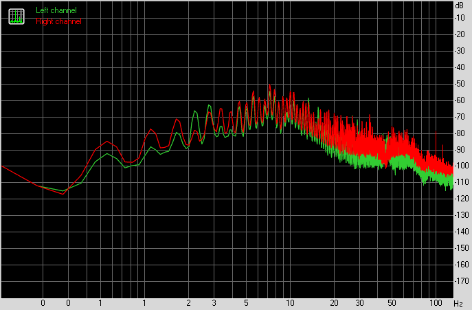

Same recording but now FFT size 64k

I have done this many times, not with "1 Hz knocks", naturally, but with the disk eccentricity and/or vertical warps "knocks". As I wrote before, it seems that we did had some misunderstanding about the use of the word "frequency" for the effects of the eccentricity of 1.8 s period = 0.555 Hz "frequency" and the presence of a 0.555 Hz frequency in the sound spectrum.
I saw the nice spectra of gpapag and I am glad to see that the 0.555 Hz in the sense I understood it are present with an intensity nearly -70 dB below that of the principal 315 Hz. That's what I expected for the 0.555 Hz - to be really insignificant as a spectrum component.
At least for me, the misunderstanding is over and leaves to me only with a shadow of insult due to the explanations of various trivial things by some people (like the term of "frequency modulation"). But this is not important..

Thank you for the materials, George. I will not repeat here my comments to Ray K, they are just above. But I am very interested on your frequency analysis software. My Adobe Audition one allows FFT sizes up to 65536. Can you tell me which software you use? Χαιρετώ!If you use a high resolution FFT, yes, you may expect to find the 1Hz peak everywhere.
