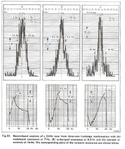

If the disk warp excites tonearm resonance frequency. You can't track the LP at all. It means you can't even make a digital copy of the LP. Once you are able to make a digital copy of the LP. The arm/cartridge resonance frequency is not a problem at all. In your digital copy of the LP, you cut all the information under 30 Hz out. In fact, you are not cutting out the excited arm/cartridge resonance frequency caused by warps.
Disagree. As has been shown on here, a silent groove will excite the arm/cartridge resonant frequency. A warp will make it bigger, and for a poorly matched combination cause a mighty tank slapper that could cause mistracking, but its not a given. I've been re-examining the analyses RayK did a couple of years ago on FM scrubbing, which is fascinating. We can agree that warps are bad though 🙂
Attached is a plot from the B&K paper showing the FM caused by different arm/cart resonant frequencies. They did cheat in one case by adding damping but it gives an idea of how much FM there can be adding to the sound (in a way that might indeed be pleasant).
On my todo list is to look at using a mastering elliptical EQ (EEQ) on playback. The EEQ basically folds the LF to mono to make the record both cuttable and playable. So in theory any vertical information below around 150Hz shouldn't be there. Removing it will change things about the soundstage. For better? I don't know yet...

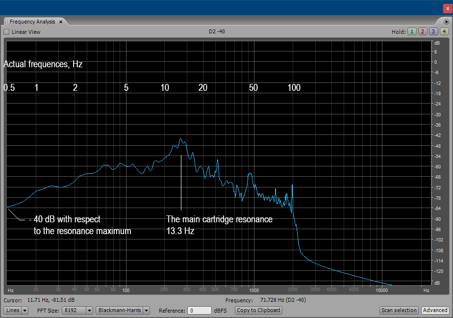

I have prepared a frequency analysis of the actual sound of an unmodulated groove of my measuring record. The analyzed region is 0.5 Hz - 100 Hz. To go so low I use a trivial trick which may be familiar to some people. Anyway, I may explain it later.
We can see that in the region of 0.5 Hz the signal is down by 40 dB with respect to the 13.3 Hz resonance maximum.

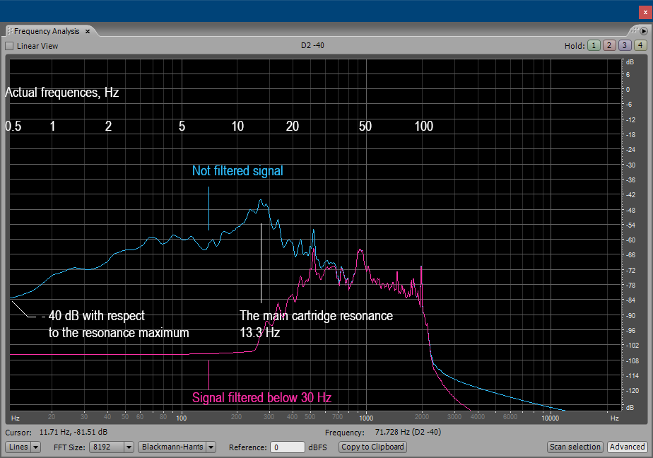

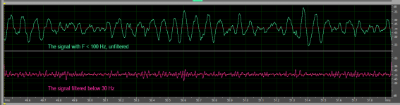

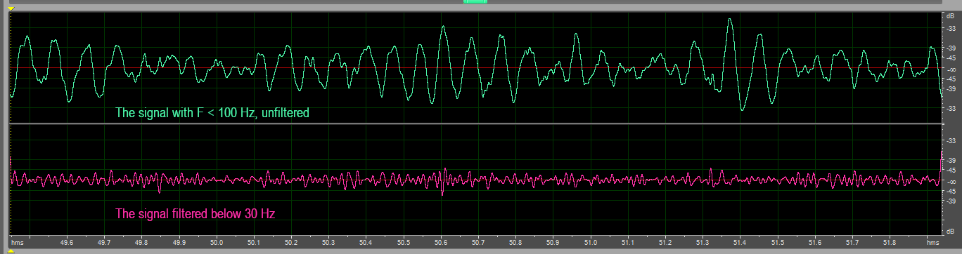

Two more pictures related to my recent measurement of the non-modulated groove noise. The signal is restricted to 100 Hz for better clarity.
The first one shows the effect of the FFT filtering below 30 Hz. The signal level at the resonance frequency of 13.3 Hz is reduced by nearly 60 dB.
The second picture shows a part of the waveform of the measured signal with no filtering and with FFT filtering below 30 Hz. In the unfiltered waveform one can clearly see the component of the resonance frequency of 13.3 Hz.
And some words about the trick used to analyze frequencies down to 0.5 Hz. Those familiar with the Frequency Analysis tool of Adobe Audition know, that this analysis goes down to 10 Hz only. To analyze below this frequency:
1. I record a quite long sample of the analyzed material, say 2-3 min.
2. I use the "Stretch" tool to get a copy of the signal with all frequencies multiplied by 20.
3. I analyze the stretched copy.
This is why the actual frequency of 100 Hz is seen in the analysis as frequency 2000 Hz.

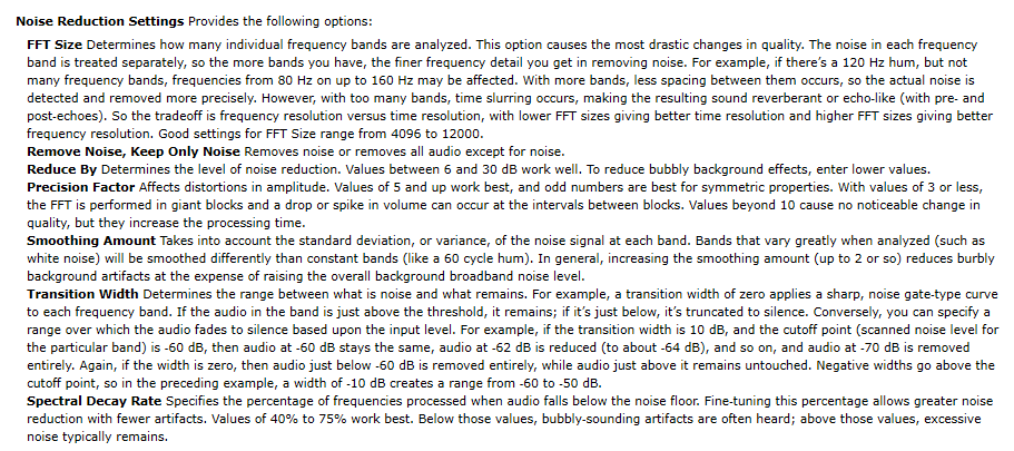

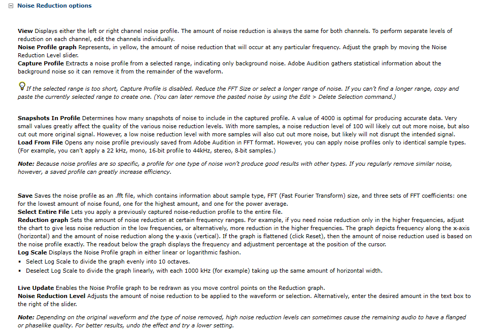

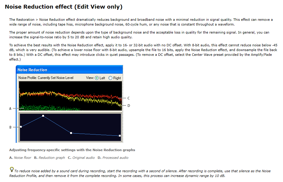

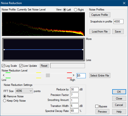

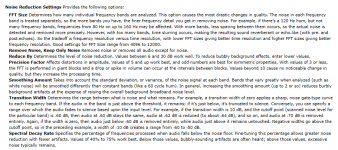

Noise reduction
Noise reduction (NR) is the most discussed and questioned part of the digital editing procedure. The main source of the noise are the irregularities in the grooves surface, which start from a given production level and increase with the use of the record. But we may have also some noise present in the original "master" material, especially in the case of quite old master recordings and/or master disks of 75 rpm recorded to the newer LP format. In this case some purist may call NR "a partial violation of the original material".
In my case the noise spectrum starts from 30 (or 25 or 20) Hz, as long as the FFT rejection of very low frequencies precedes NR. The intensity of the noise typically decreases with the increase of the frequency. In most cases the total unweighted RMS value of the noise is about -50 dB, but there are cases of very high disk quality where the noise RMS approaches -60 dB.
The NR procedure I use is based on a selected sample with no groove modulation. This may be taken from the initial part of the disk or from some pause between different record parts. As the disk noise has usually a periodical component, it is good to select sample of duration multiples of 1.8 sec (for 331/3 rpm). 1.8 sec works well, but I select samples of 3.6 sec or 5.4 sec, when available. In Adobe Audition this initial part of the NR procedure is called "Capturing Noise Reduction Profile".
The second part is the Noise Reduction process, which uses the captured noise profile to substract it, by use of Fourier transform, from the material under de-noising. This tool has a large number of adustable parameters, the most important of which is the Noise Reduction Level. The Help support of Audition provides very detailed instructions, but one has to experiment in order to achieve a satisfactory result. Once achieved, a good set of denoising parameters may serve in a lot of different cases. I attach a picture of the Audition noise reduction tool and also a dump of the Help instructions.
Selecting a good noise reduction level is a matter of experience, but also of taste. Some prefer to apply lower reduction level, in order to be 'on the safer side'. In these cases some noise is still audible, but not too annoying. Other prefer higher values, in order to have not audible levels of noise at moderate listening sound levels. I am closer to the second type, but make it in a more mild way, by use of a transition width of 6 dB. This means that the de-noising below the selected level Ln is not applied fully, but gradually, starting from 0% at Ln and ending to 100% at Ln-6 dB and lower.
I think that all said here + the Adobe Audition help materials give a good idea of the subject.
