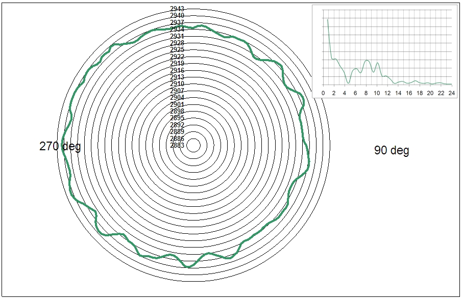

The frequencies below 20Hz are generally not the 3 you listed. The main ones are
1. Center hole offset (eccentricity) at 0.55Hz
2. Arm cartridge resonance at 7-12Hz
3. Bearing drag/belt issues causing speed changes.
Attached is an analysis of a linn LP12 rather in need of a tuneup. The circular graph shows how frequency changes over a revolution and the X-Y is a frequency analysis. As you can see the 0.55Hz eccentricity is the biggest contributor. Why does this matter? Well because that modulates the wanted signal and cannot easily be removed. High pass filters will remove the signal, but the damage has been done at that point. This could be argued to be part of the 'vinyl sound' of course, but at least it can be addressed and minimised by careful setup.

I mentioned your 2. in my b. I call 'tonearm resonance' exactly what you call "arm cartridge resonance".
b. The disk warps, which activate tonearm resonance vibrations
I think that the effects of the 0.55 Hz eccentricity movements are quite low, from the signal level point of view. The cartridge response goes down very quickly for frequencies below the resonance one.
Your 3. - yes, this is another source, but again of very low principal frequencies.
Sorry yes, I misread your 'b'
ref eccentricty B&K did measure this back in the 60s. The graph I showed is from an actual recording showing relative levels!
The eccentricity causes a large FM component close in. How audible that is depends but it is very easily measured and IMO somthing to be worth taking the effort to minimise if you are digitizing a record.
I am very surprised to know that the results of Brüel & Kjær refer to the cartridge signal and not to the groove displacement! A normal cartridge with frequency response going down to 0.55 Hz?? I can't believe this! May be they used some special type of measuring cartridge, responding to displacement (e.g. piezo) and not to velocity??
The cartridge response has nothing to do with it, the effective groove velocity varies at .55 Hz and the frequency of everything on the disk varies with it.
Are you talking about the wow caused by some eccentricity ±dR? Yes, every playback frequency will vary within ±dR/R with a period of 0.55 Hz. But this has nothing to do with the level of the cartridge signal with frequency 0.55 Hz.
Neither does the plot Bill showed, this effect is clearly audible on piano recordings in particular. Take an opera LP you hate and widen the hole and play it very off center. The only point is the frequency response of the cartridge has nothing to do with it.
Yea its a pitch shifter, actually pitch modulator, and people are excellent pitch detectors.
