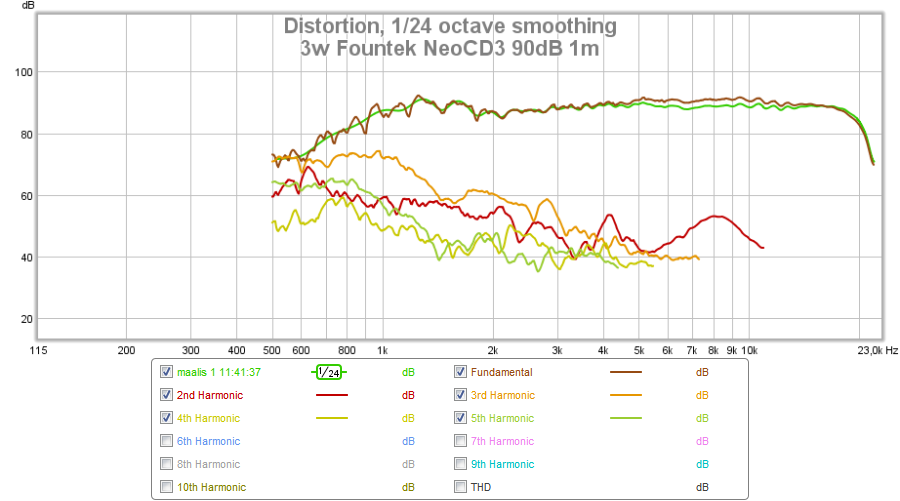

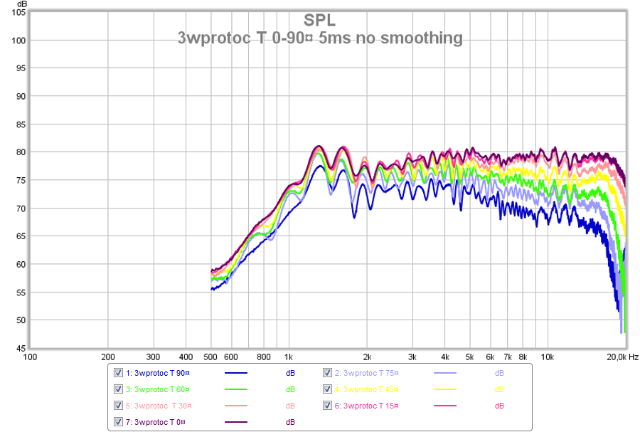

Very cool 🙂 I'm surprised the neo3.5 measures so well in its " naked " state!
This is my nudie NeoCD3,5 in a narrow baffle, no eq or xo. This driver has a capacitor inside, to compensate for the horn boost. Looks nice to me!
