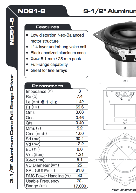

It turns out the reason for the buzzing was quite boring:
It was just plain ol' distortion.
Here's what I think happened:
1) The Dayton NS91 has a ridiculous amount of xmax. Something like 25mm.
2) The driver is only rated for 5mm
3) My hypothesis is that the motor is *capable* of much more excursion than it's rated for, but it's rated for 5mm because distortion goes through the roof if you exceed that. Basically a normal overhung driver can't physically move that far, so distortion doesn't go nuts. But take an NS91 and stick it in a dipole, and it will move into a very high level of distortion.
Either that, or it's just smacking into the horn mounting plate. But I don't think that's the case, because I can stop the buzzing by physically putting my finger on the woofer when it's playing at high levels. If it was smacking the mounting plate, then touching the *back* shouldn't stop the buzzing. So I think it's the high excursion that's causing issues.
I measured the distortion in Holmimpulse and it was clear as night and day, note how it goes through the roof at 400hz. And this measurement is *after* I added a highpass. Before I had a high pass in the mix, my F3 was around 200hz but the octave between 200hz and 400hz was pure distortion.
Long story short, I added a high pass using the miniDSP and the problem disappeared for the most part. I still need to get this sorted out though, because the driver is physically capable of going down to 200hz, but only at low volumes. The excursion just goes nuts otherwise.
Assuming you are writing about the ND91, it has only 5.1 mm Xmax, a lot for a 3.5". If you see it moving over 10.2 mm peak to peak, just under 1/2", it is exceeding Xmax, and distortion will rise rapidly with more excursion.It turns out the reason for the buzzing was quite boring:
"25mm peak" is likely a peak to peak Xlim (Xmech) rating, excursion in excess of that (just under one inch) may cause damage to some part of the driver.
If you are hearing (or measuring) much distortion (buzzing) at excursions below Xmax, it may be from a bent frame causing the voice coil to rub, your observation that you can stop the buzzing by physically putting a finger on the woofer is consistent with a bent frame, a bent frame is consistent with your construction techniques.
If the driver primarily buzzes at one frequency, but not others, a dragging coil is likely. Buzzing is quite annoying, distortion from simply exceeding Xmax not so much.
Unscrew the driver(s) and run it open air, you may find the buzz goes away (if the frame un-warps), as long as it is under around 10.2mm peak to peak movement.
That said, open air or open back, the driver probably will exceed Xmax with only around 10 watts, nine volts or so.
