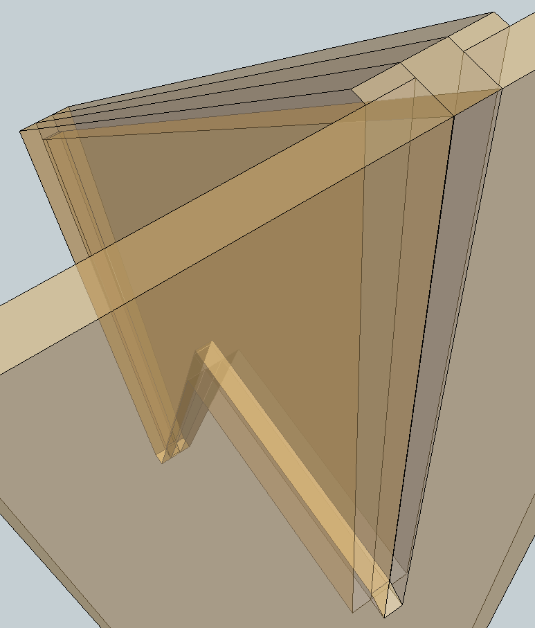

Yes, that's exactly right.
Basically taking a Smith Horn, reducing the height, and flipping it on it's axis.
When a waveguide or horn isn't symmetrical, you get pattern flip. For instance, if you have a horn with a mouth that's 12" wide by 6" tall, the vertical directivity will beging to broaden about one octave before the horizontal. In this case, the vertical will broaden at about 2250hz, while the horizontal won't broaden until 1125hz. This is not A Good Thing; it will make the horn sound weird in the octave of 1125hz-2250hz, right in the middle of the midrange.
The obvious solution to pattern flip is to keep the horn symmetrical.
When Bruce Edgar helped Image Dynamics improve their horns, Bruce did something clever to combat 'pattern flip.' Instead of making the horn symmetrical, he made the vertical height so small, it drives up the pattern flip to a frequency that's very high.
If you look at the USD horn (first pic) and the ID horn (second pic) you can see that the second horn has a very small vertical height for most of it's path. This isn't accidental; it pushes pattern flip up to the last octave. So basically the ID horn has *wide* vertical directivity, and narrower horizontal directivity. Which is handy, since we're listening off-axis in both the vertical and horizontal axis.
My waveguide uses the same idea, but flips it 90 degrees.

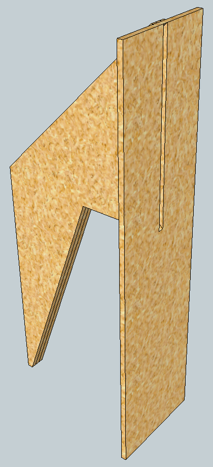

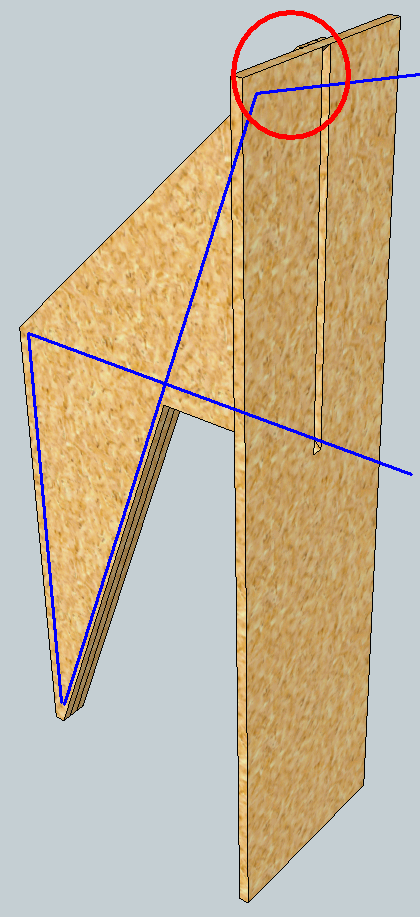

Nearly impossible to "see" in this drawing, cause long ago I erased
all the unnecessary drafting lines... But use your imagination...
Angled reflector at the top is NOT fully illuminated by the 20deg
wedge of the first expansion. And a ray trace of said reflection
misses by a few degrees conforming to the reflector as sidewall.
Therefore it acts like an expansion, just before the slot opening,
a round-over or whatever. I wanted to open a similar roundover
into the bottom lip of the slot. Not in this version of the drawing
unfortunately, so again use your imagination to pretend that cut.
This small expansion is insignificant compared to the 180 spread
when the wave leaves the slot, so there is going to be impedance
discontinuity for sure. Angled slightly upward in this drawing, not
straight ahead as it might at first glance appear. Your photograph
shows a similar slant to the opening. I was hoping that might help
smear around the damage, not to appear all as-if one big dip...
The OP of another thread that I drew this for didn't want it any
higher than 4ft tall. And I figure most peoples ears are sitting that
or standing higher. Therefore a slightly upwards slanted angle of
exit was part of the plan. A little disappointed your graph predicts
so many dips for me, with a similar exit strategy.

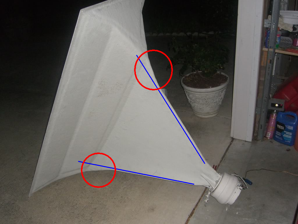

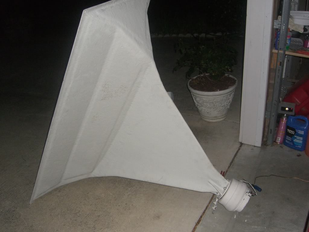

I believe these might be front and back pics of the Altec I was describing.
Since I ripped em' from different sights, they might not be of exactly the
same model. Anyways, note how the "long" end of the slot is also slightly
wider. What gives with that???
Might get rid some of those dips, if you were to slather on some bondo
and sand the throat area a little smoother, just sayin'...
So again, look those Altec Mantaray pics.
I believe the pic on the right (side view)
might be sitting upside down with regard
to the pic on the left (front view).
Looking at the side view, we see a wedge
of straight sides, but a few inches before
the slot, we see a small vertical expansion.
Maybe a 2D "roundover". That sort of the
thing I was trying to achieve in post #6.
Though I was getting there (on the top side
only) by trick of the reflection angle. Little
or no actual roundover expansion to be cut...
If we look at the illuminated part of the top
edge as being part of the 20degree wedge
that reflects out the front slot. And the last
few inches of un-illuminated top edge as a
new wedge with wider angle of expansion.
Of course, I only gave treatment for the top
edge of the slot. Nothing similar was done
for my lower edge. If I'd noticed earlier those
expansions (just before the slot) in Altec's
example, I would have been more likely to
have wanted that feature for both ends too.
And some other weird bend at Altec's throat?
No idea what that was intended to accomplish.
Shape there is not making a lot of sense to me.

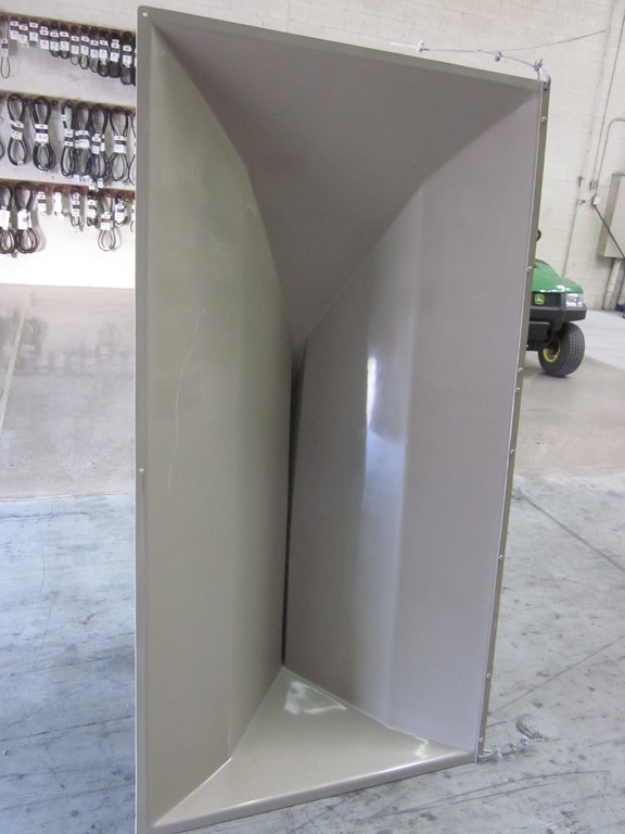

Ken,And some other weird bend at Altec's throat?
The angular distortion in the pictures makes it difficult to determine what the horn actually looks like, but it appears to be designed for "long throw/short throw" use. EV and JBL also made similar units, with better smoothing than the Altec.
The horn appears upside down from it's typical intended use, which has the wider dispersion portion of the horn covering the near field, the more narrow dispersion upper portion covers more distant seating. The more narrow portion has higher sensitivity, which combats the inverse distance SPL fall off, if placed at the right height, sound level is more consistent front to back, and has a better direct to reflected ratio that a single horn with a single horizontal dispersion angle.
Normally the different horizontal dispersion needed for near and far is done with two separate horns and drivers, but combining two horns into one is more cost effective when the output level of two drivers is not required. That said, variable dispersion horns never seemed to catch on well in the contractor world, seems not many designers understood the unique properties.
I have searched using many different terms, seems the much smaller EV horns of this type are the only ones still in production, but are packaged in a cabinet with a 15".

Here's a pic and the horizontal polars of the first waveguide I made, which is basically a conical horn with zero degrees of horizontal directivity and 45 degrees of vertical directivity.
(Note that it's oriented *vertically*)
Here's the horizontal directivity of the Pyle PH714 when oriented vertically. Ideally I'd like to use a width of about 1" or less, which would basically make the horn omnidirectional up to 10khz or so. But this isn't easy to do; due to the small mouth the midrange gets lumpy. (As seen in the first set of measurements.)
So the Pyle might be as good as it gets, at least with this directivity pattern.
^^ Here's a pic of the Pyle, after I chopped it up and threw some mids on the horn, Synergy Horn style.
At this point, these are the best polars yet. Particularly the top two octaves, which are much smoother than the last two horns.
IMHO, the improvement in the Pyle is due to changes I made to the throat. In it's "stock" condition, the Pyle has a HUGE gap in the throat. We're talking almost half an inch. My second set of measurements had some clay in the throat, and even with the clay, the top octave was a little rough. For the last set of measurements here, I used a combination of Gorrilla Glue and sawdust to fill in the throat, and then I filed it down with a round file.
At this point, the biggest problem I'm dealing with is the phase at the crossover point. The tweeter is out-of-phase with the midrange at the xover point. The graph above shows the drivers in-phase (with a dip) and out-of-phase (with a smaller dip.)
I checked all my wiring, and it appears that everything is connected correctly. So either the terminals on the drivers are coded wrong, or (more likely) the dipole radiation is causing the dip in the midrange.
Basically, I think that there's enough energy coming off the *back* of the cones that it's creating a dip.
I tried using some digital delay on both the mids and the tweeter, and the dip didn't go away it just changed frequency, which would seem to confirm my hypothesis, that this is due to the dipole radiation.
Covering up the midranges with a blanket made quite an improvement, and that's why the video that I posted has them configured that way. I also did the measurements in a 13" cube, as I'm trying to replicate the effect of having the horn underneath the dash of a car.
My next steps will be to experiment with stuffing the back chamber to make it more of a cardioid and less of a dipole, and also stuffing the horn itself, a la Geddes
http://www.lansingheritage.org/images/altec/catalogs/1993-pro/1993-24.JPG
http://www.lansingheritage.org/images/altec/catalogs/1993-pro/1993-25.JPG
