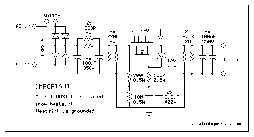

The anode power supply schematic:

Yes 🙂. of course the UCL 82 is like 50 volts on the filament! i wonder why they chose it.and if that had a logic to it why the others didnt follow and make only UCL versions.
50V filaments comes handy if You want a PP with those tubes, need only a 220/220 isolation transformer, and the OPT's
The ECL/PCL/UCL82 tube types are rather old ones. The UCL82 dates back to a time when DC mains grids still were common in some regions in Europe. Tube radios dedicated for usage in AC grids as well as in DC grids didn't feature a power transformer. Plate supply was derived directly from the mains via one way rectifying, the 100 mA heaters were arranged in a series chain.
ECL and PCL86 came to the market rather late. DC mains had all but vanished, so there wasn't any need for a UCL86. Yes, the PCL86 also was designed for series heating, but preferably in TV sets which had a very similar power supply design as those old AC/DC radios. The purpose was to save the power transformer which helped to reduce production costs and to eliminate it's magnetic stray which might have affected the CRT.

ok... i learnt more from you today 🙂 . bye the way someone mentioned somewhere on the site that UCLs had shorter life or more failures because the filaments were thinner based on the lower current draw. if thats true at all..what can one do about it ? A Few more questions..
should the plate voltage first reach its peak before the heaters get switched on?
how can we do this and whats the best and simplest way to soft start the filament. i had flashes on the heaters everytime i turned my little diy amp on. it was a UCL 82 and also the same happened with the ecl86 amp that i built later.

... and whats the best and simplest way to soft start the filament. i had flashes on the heaters everytime i turned my little diy amp on. it was a UCL 82 and also the same happened with the ecl86 amp that i built later.
No need to worry about, as usually this doesn't harm. I guess there's just some small part of the heater filaments left without the isolation coating, which, due to it's smaller heat capacity, behaves like an incandescent bulb upon powering on.

Thanks for your answers...Sometimes i noticed this flashover happening not when i first started powering my diy amp but only later on after a few days. so it kind of has confused me at the time. i had thought of putting an additional resistor in the fila ment path like 2 ohms and then bypassing it with another switch to full voltage manually.doesnt the inrush current cause this? on my German radios sometimes i saw coil in the filament circuit but usually they had nothing for inrush and the tubes never flash over. never. how do they do it? yes it has selenium rectifier( the radio) and not silicon.
