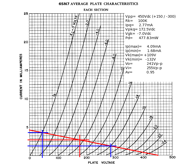

Interesting, do you have a circuit to demonstrate how you realise DC coupling (Norton circuit, resistor/voltage supply in cathode end tube or other?)
Designing this is no different from any other hollow state design: loadlines (attached). Since this is a dual rail supply of +150Vdc/-300Vdc, this is the same as:
Vpp= 150 - (-300)= 450Vdc
Use that as the basis to draw a loadline.
From the 807 spec sheet, we require Vgk= -22.5Vdc (nominal). If the cathode is sitting at -22.5Vdc, that gives one point along the loadline: Vpk= 150 - (-22.5)= 172.5Vdc. So pick off that point to determine the resulting Ipq, and Vgk for the 6SN7s. This comes to: -7.0Vdc. Since the cathode is already at -22.5V, the grid must be at: -7 - 22.5= -29.5Vdc (nominal). Since this is a cathode follower, there is a lot of leeway for adjusting the operational grid voltage, used to vary the bias to current balance the finals.
Since this is a cathode follower design, you will need the plate current maximum and minimum, and these are picked off the plate characteristic. Next, calculate the voltage across the tail resistor:
Vrtail(max)= 100(4.09)= 409V
Vrtail(min)= 100(1.68)= 168V
Calculate the actual cathode voltages:
Vrk(max)= -300 + 409= 109V
Vrk(min)= -300 + 186= -132V
Since Vgk= 0 at the current maximum:
Vi+= 109V
And Vgk= -14V at the minimum:
Vi-= -132-14= -146V
Vi= Vi+ - Vi-
Vi= 109 - (-146)= 255Vp-p
Vo= 109 - (-132)= 241Vp-p
Av= 241/255= 0.95 V/V
And done!
