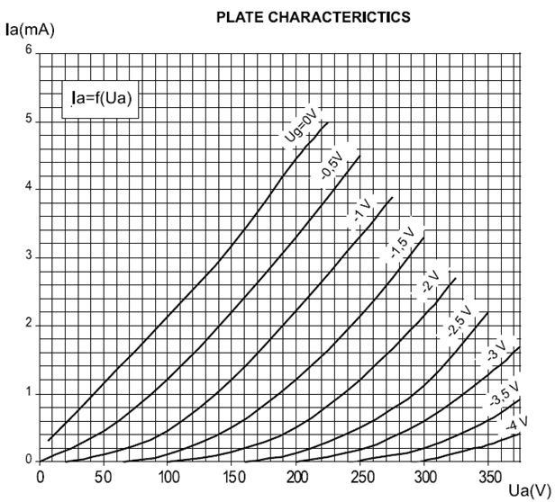

If I understand correctly, to meet the mentioned rule-of-thumb using the attached characteristics, given an input swing of 1 Vp-p and desired Ia of 1 mA, I would need a anode voltage of 240 V.

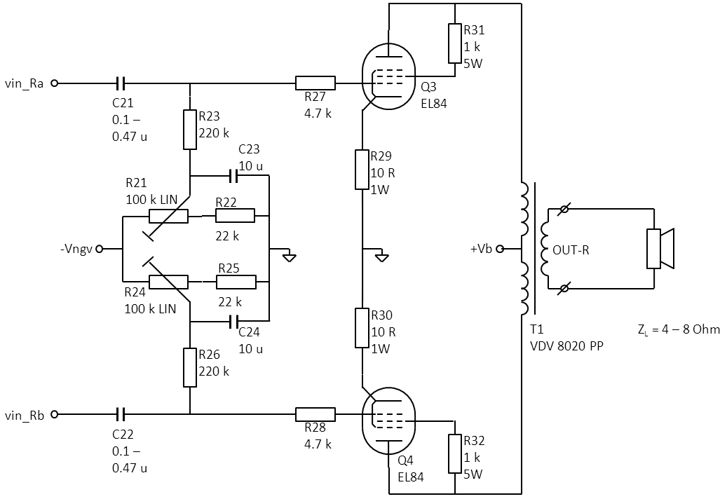

The end-stage consists of 2x EL84 in PP connected to a toroidal OPT (VDV8020). Bias current is set using a negative grid voltage. The OPT is intended for use with 5 Ohm load, however my measurement resistor is 8.2 Ohms. Also this circuit I plan to further develop.
Yes, I am aware that 1 Vp-p is rather large and I will use different levels once I better understand the behaviour of the circuit (and where I want to take it)
OK, so remember that your AC loadline has to have the 220k grid resistors in parallel, for an effective plate load of 110k (quite low for that tube). As well, you need to think about the Miller capacitance of the output stage and the risetime/bandwidth that will result when the very low current, high source impedance 12AX7/ECC83 tries to drive it at high frequencies.

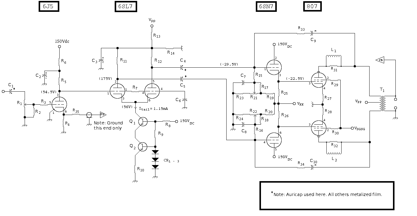

Yep. Used a very similar phase splitter for this project (attached).
The 6SL7 doesn't have quite the gain of a 12AX7 (u= 70 v. u= 100). Other than that, they're similar in that both are designed for very low plate currents, and drive up the u-Factor by increasing the plate resistance.
As for performance, it's no different than it is for any triode voltage amp: load the plate as lightly as possible. This gives the best distortion performance, and a CCS plate load in the limit.
Also, these low current types like Lo-C, Hi-Z loads. That's why the project incorporates cathode follower grid drivers: to isolate the LTP from the Hi-C load of the power finals. There is a bit of design compromise here since the finals use local NFB. This increases the load at the plates, but the total plate load is still quite a bit higher than the plate resistance. This is a bit easier to accomplish with 6SL7s as the plate load (rp= 44K, nominal) is smaller than it is for the 12AX7 (rp= 90K, nominal). One reason why I prefer the 6SL7 over the 12AX7.
