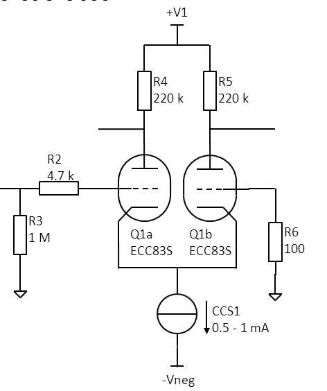

This afternoon I played around with LTSpice to look into IMD. It is a quick and dirty simulation, but some interesting results. Interesting enough for me to build and test this in the near future. Attached some snapshots of the simulation results.
Some questions regarding the simulation - why are the amplitudes for Vin1 & Vin2 different (0.2 vs. 0.22)? And does R1 represent the load for the differential output? If so, why is it set so low? With ~30dB increase in IMD distortion level for the mis-matched pair, why it doesn't seem to impact the square wave response that SY posted? 😕
Jaz
Jaz
The difference between Vin1 and Vin2 is a typo error, but should not make any significant difference in the results.
Both outputs are taken from the anodes. The load is the anode resistor + other circuitry connected to the preamp (usually input power stage).
R1 only shortens the 2nd grid to ground. Higher resistor values will limit the bandwidth of the preamp
