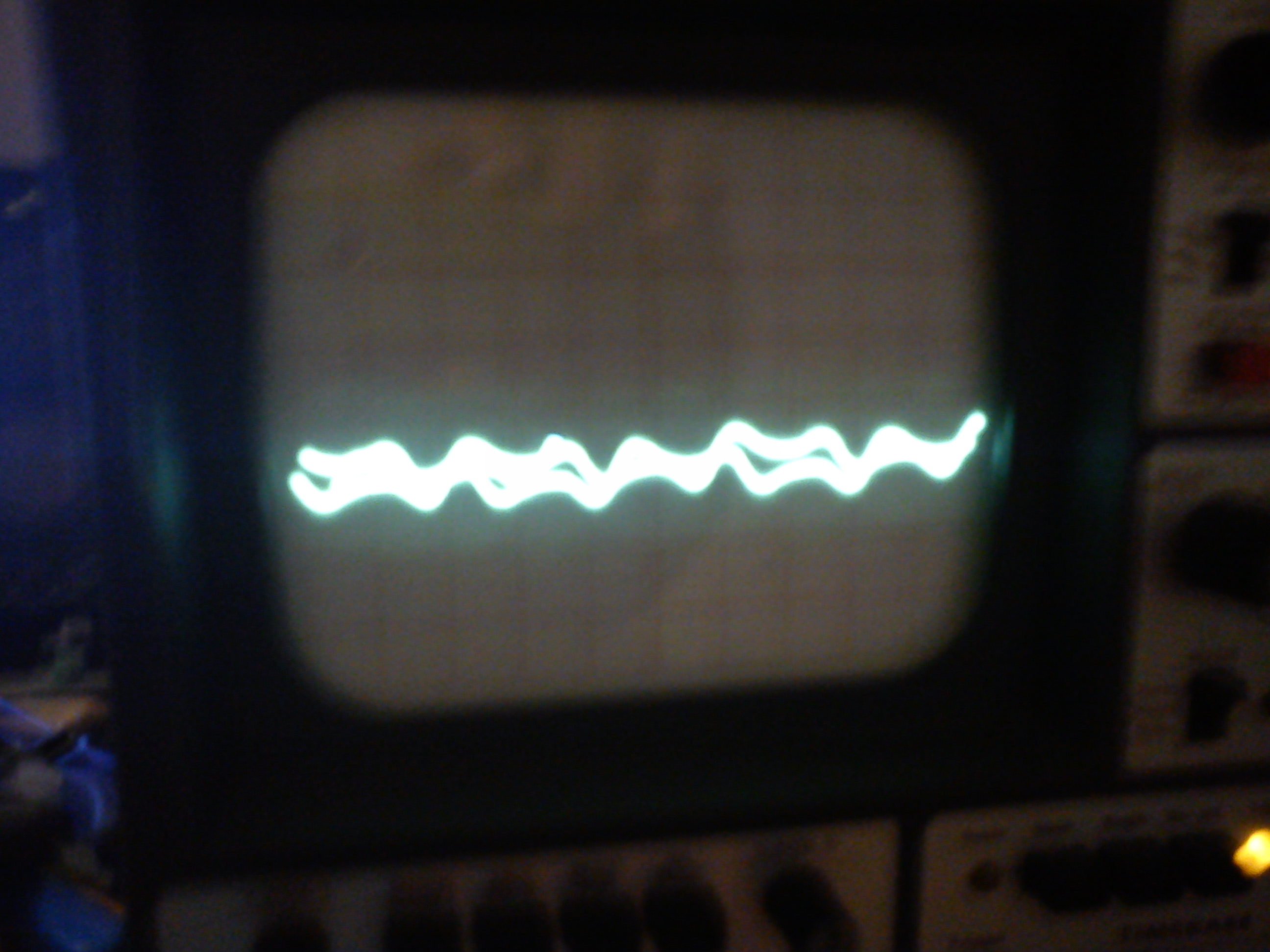

ECC81 mu-follower problem
I measured with scope set to 5ms

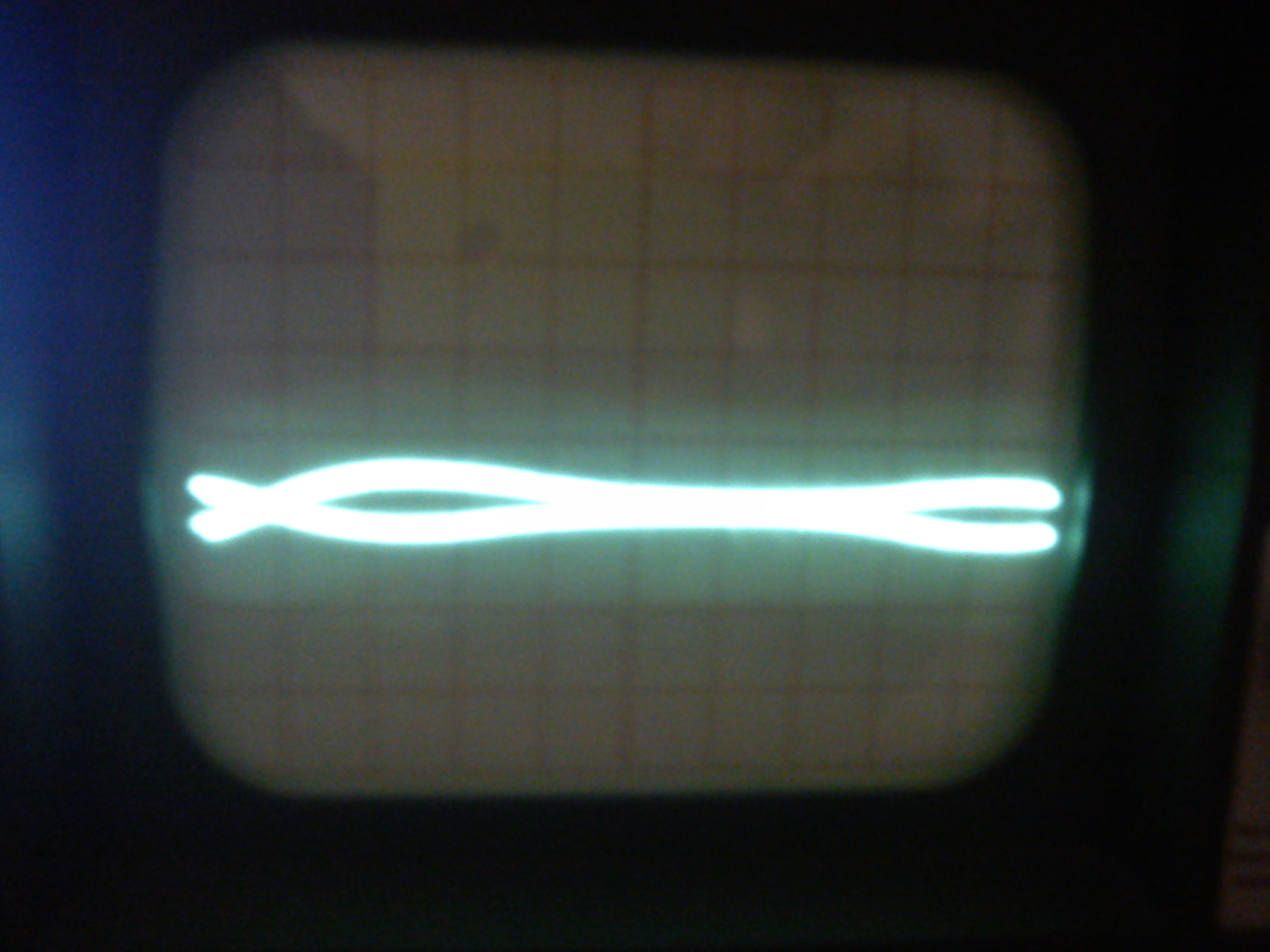

I ended left channel 60K1 & right channel 63K2😉
OK, now use 1N914 or 1N4448 type diodes.
ALSO (rather important) do not think that setting the left channel at 60K and the right channel at 63K is the "right solution" (i.e. independent resistance values, chosen to get the front-end triodes at the same operating point). The problem is that the amplification factor is highly dependent on those 60/63K resistors. Hence... if they're different values, you're going to have different amplification per channel.
Now wait ... it gets better - the amplification might actually be the same, or even inverted (the one with the higher resistance, expected to have more gain, actually has less). This is because of basically "huge variation in tubes". They're really quite different, unless very well matched.
So in the end, if I was doing this, I'd leave the little adjustment trimpots in place, and adjust the output using your oscilloscope in the A-B mode (where one signal is subtracted from the other). Feed a nice 100 millivolt input into both channels, then fiddle with one of the trimpots until basically the signal is best nulled out. That's as good as you're going to get for matching the gain of the different tubes.
GoatGuy

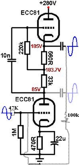

Gain is X 58.8 so I want to raise the gain adding NFB to a total of max. 20-25dBs in place of using a voltage divider at the input so using NFB lowers distortions & output impedance. Can be implemented. 100K from output cap to grid of lower tube and 47K in series with input cap?
