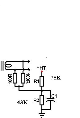

You can never get the Vfk within the max. 90V specs for the upper and lower triode at the same time.One cathode almost Gnd level and the other near 200V is to much.
Max.distance is 2x90V !
A solution could be separate tubes for up and down with the upper two (other channel) a heatersource of it's own,200V above Gnd.
Or another tube 😱

Heater elevation: Because the upper cathode is at a high voltage it is usually necessary to elevate the heater supply to avoid exceeding the maximum rated heater-cathode voltage (Vhk). For the ECC81 this is 90V, so we would need to elevate the heater by at least 100V.
I have no idea what it means, but thats what it says
only found the figures to look different
or are you saying your measured heater-cathode voltage is 76V, and ok being below 90V 😕
Using 100V to elevate the heater like the attached schematic, I measure:

New elevated heaters used schematic

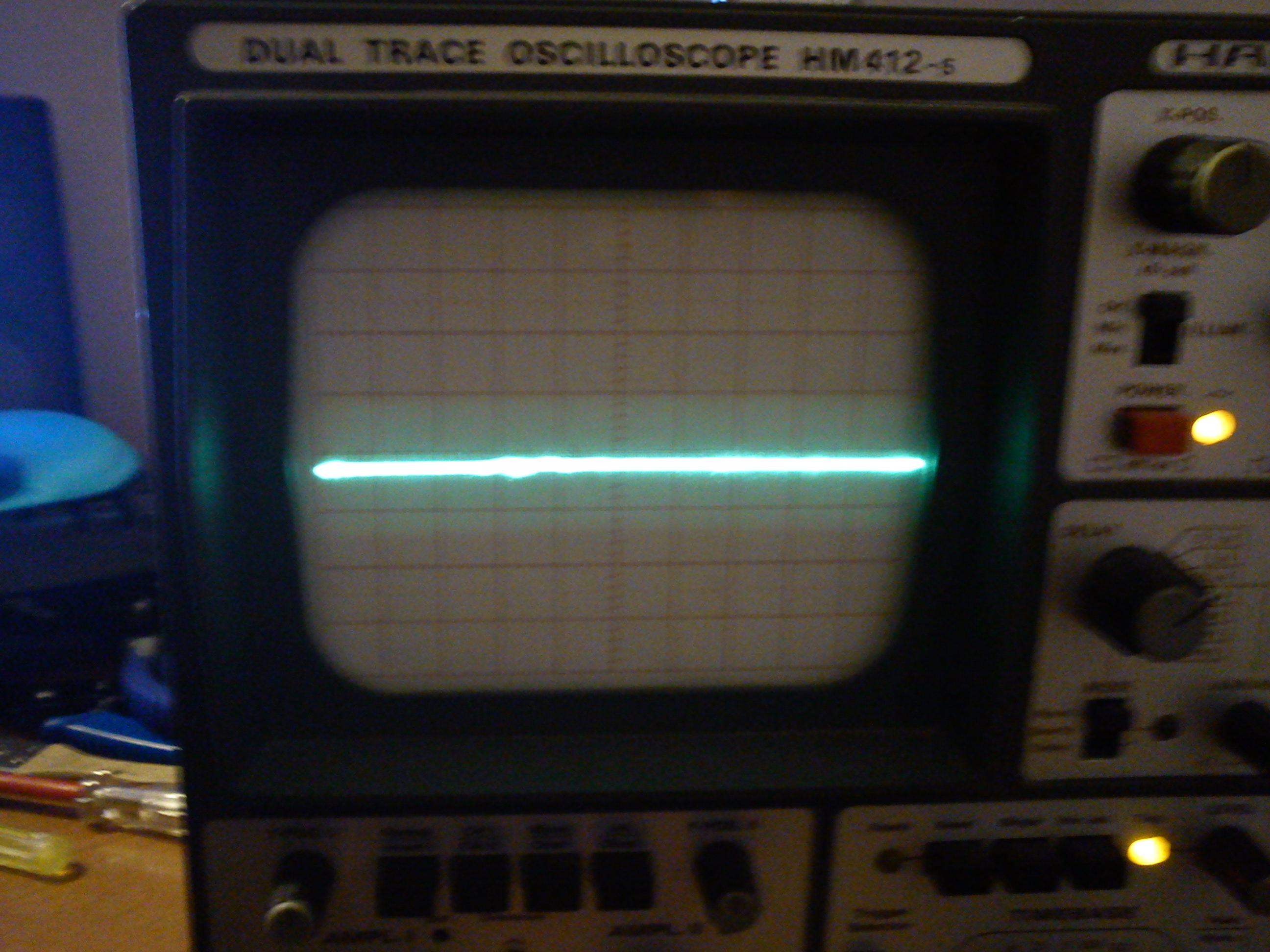

I'm sure hum not cames for other source because I use also as headphone amp and without nothing connected input/ouput haves the same hum. I guess little ripple because I use Salas HV shunt regulator but tomorrow I will check with the scope.
Thanks for support Andreas.
Still hum with the input shorted to ground?
The scope trace is blurred... 0.5us sounds very short. 'Hum' usually is something in the 50-100Hz range, meaning approx. 20ms to 10ms in period length.
If you have a scope available, step one would be to measure the hum you're experiencing. The frequency would surely give hints about the hum source!
